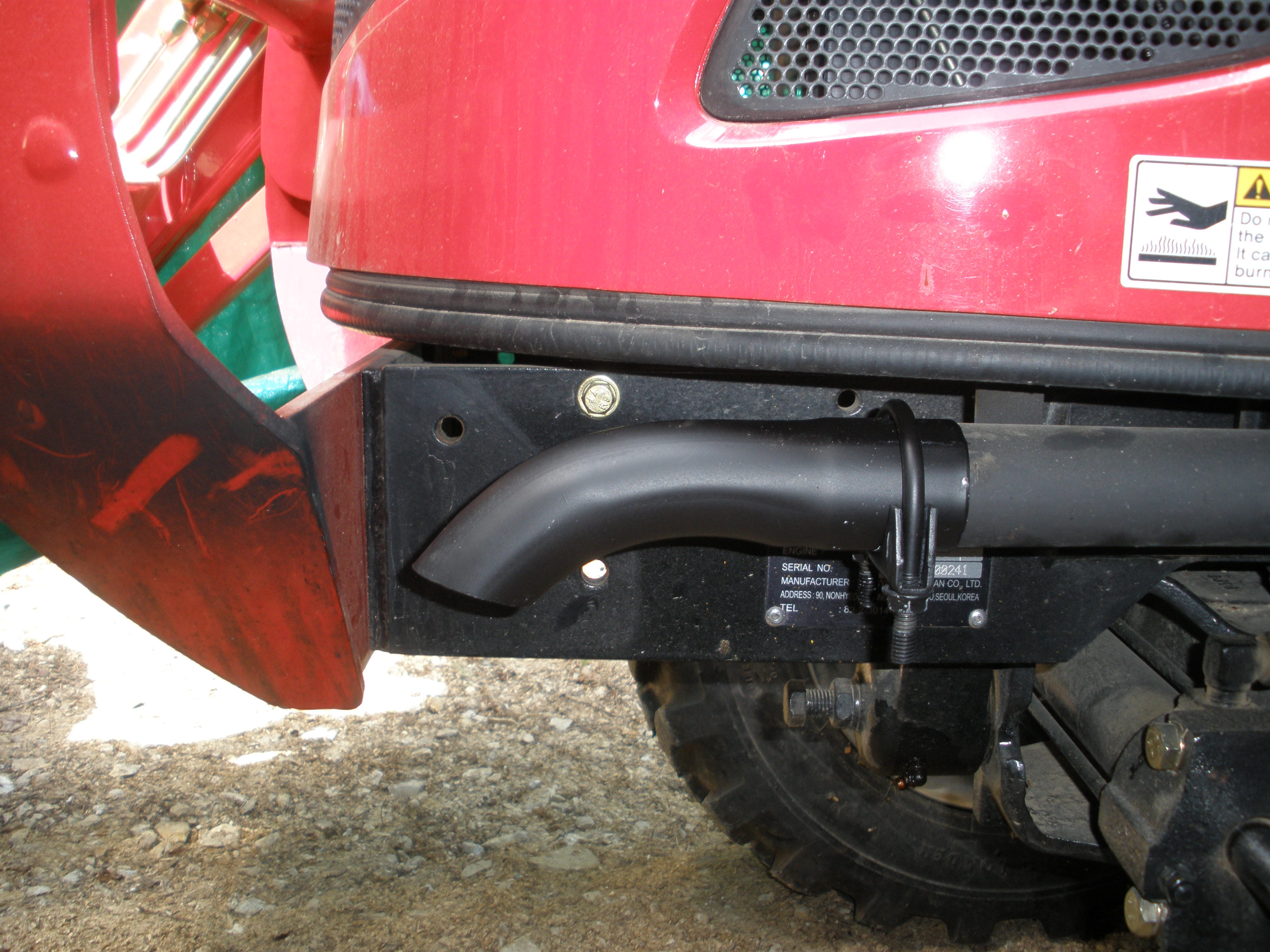

Hi folks...gravelman here. i have a 2016 Kubota B2650 the exhaust makes loader arm and area around it all black...would like to get 90 degree elbow to redirect Do you know where i could find exhaust parts, fittings?? Maybe tractor supply has this stuff , not sure. thanks much

They have some sections of exhaust pipe at AutoZone. You can get some of that and experiment. You can also get a section of pipe and have it bent some by a muffler shop. I made a exhaust extension for my L2501 before I got rid of it and got a L3301.

You need an accurate measurement of the exhaust pipe diameter before going shopping for an elbow.
Very common problem. Manufacturers just put on enough pipe to get the exhaust away from the tractor's painted surfaces. The FEL isn't considered.
When you resolve this problem take some pictures and start a thread. You know all the other 2650 owners need a fix also. :)

I wasn't really looking for the chrome, but couldn't find 1.5 inch diameter that I needed in a stock finish. Now that it is on, I do like the way it looks.

Any concern with high exhaust temps? Your tractor has a dpf system I think.

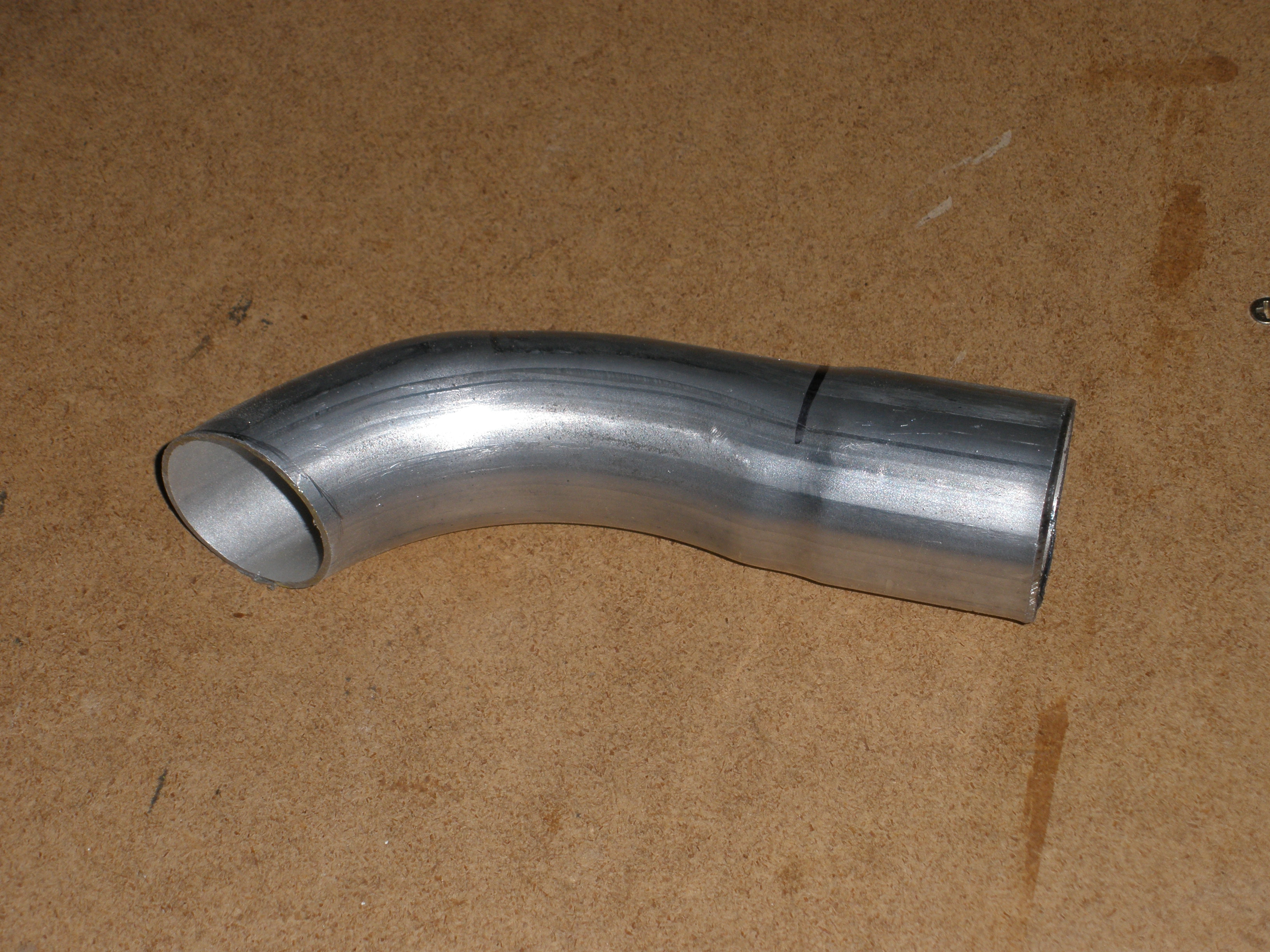

I also made a similar mod on my tractor. I measured the OD of my current exhaust and went to a muffler shop and for under $5.00 they came up with this and the clamp.
