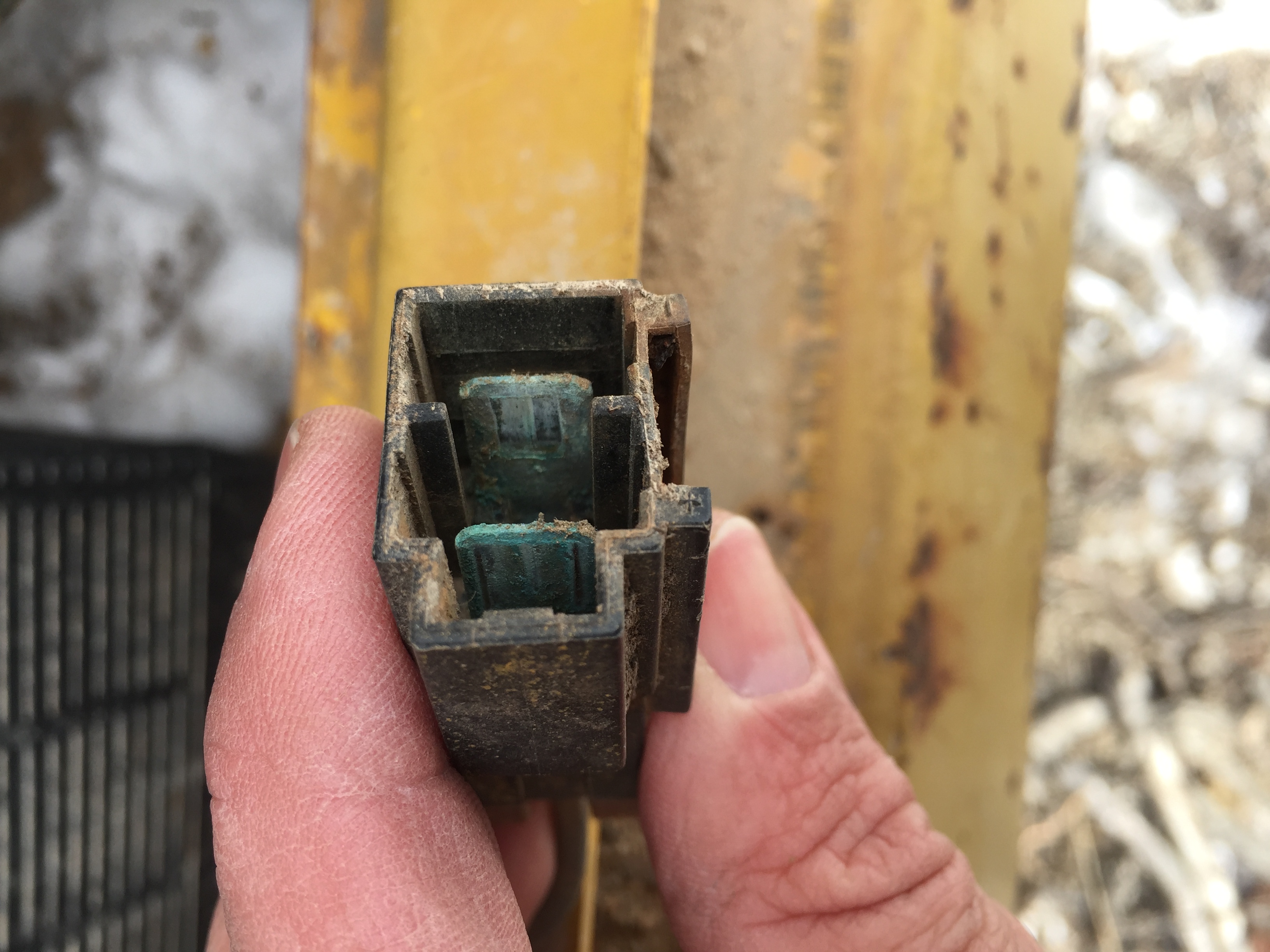

If one of the diodes is bad in the alternator back feeding voltage to the anti restart relay. Eg the engine already thinks it's running so it doesn't let you"restart" the engine
Ok. Thank you. I will definitely check that out.

Could be the diode in the alternator that prevents the motor being cranked when running. I had to bypass it at the battery solenoid.

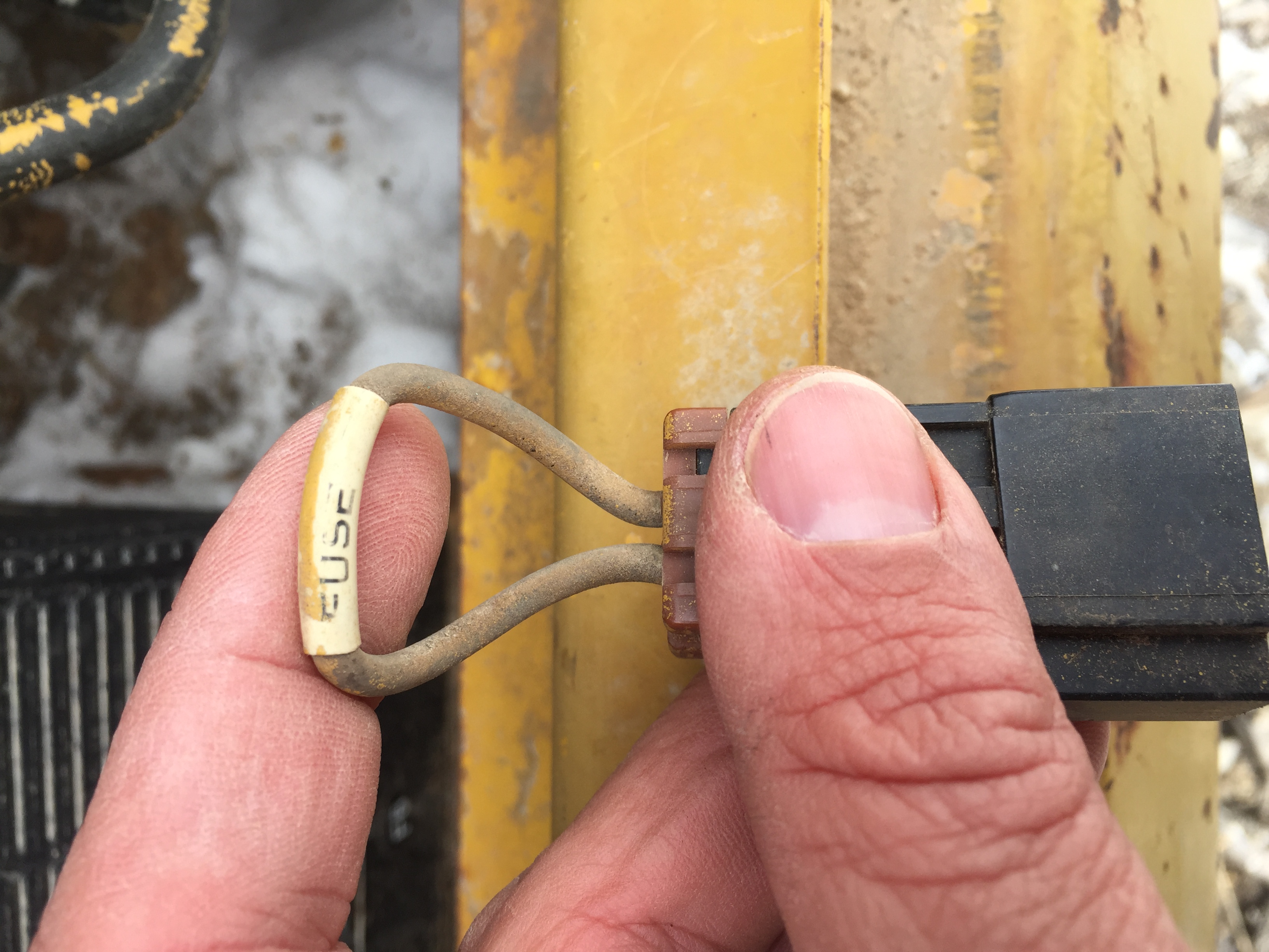

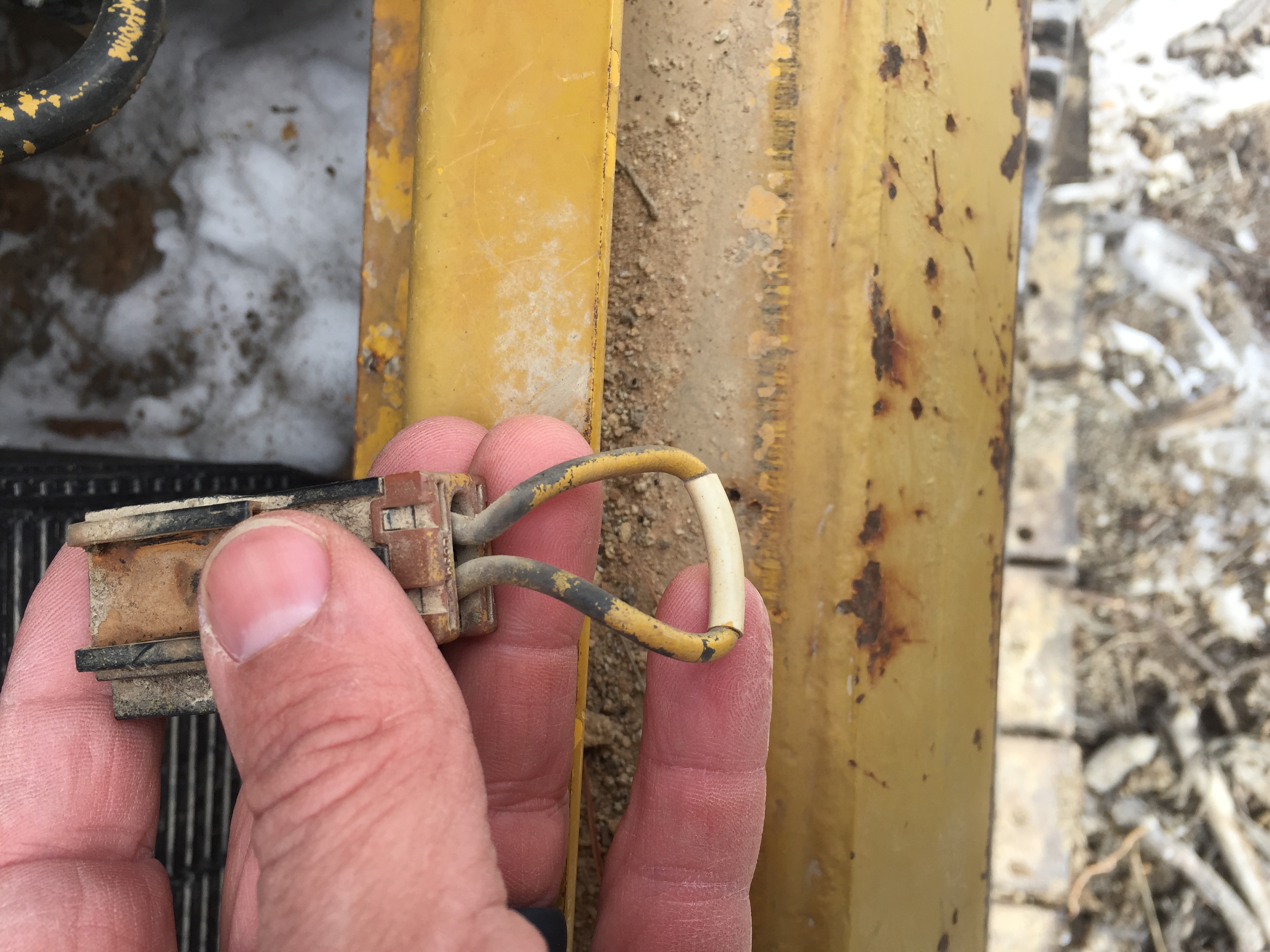

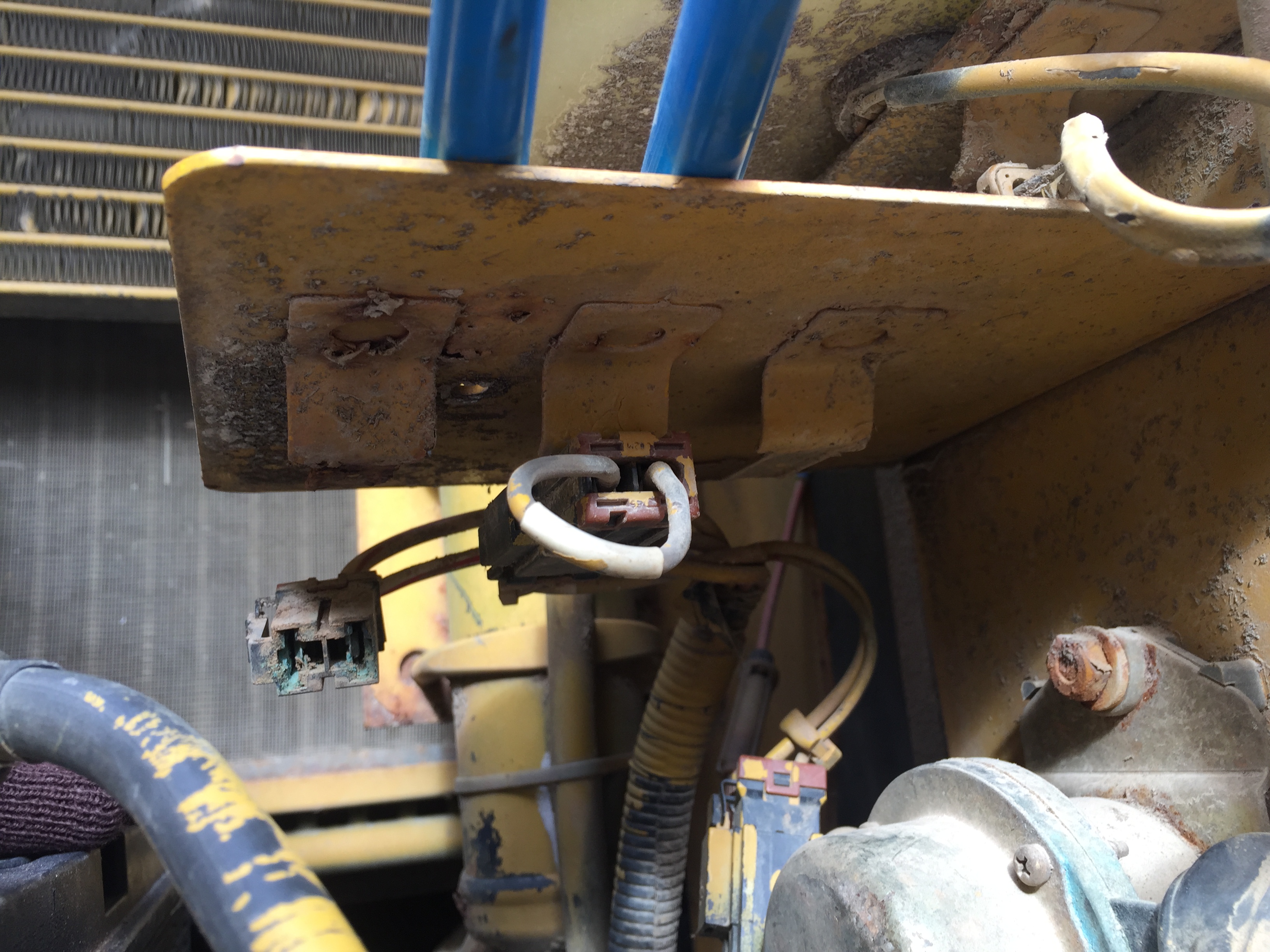

It looks like firemanMike69 nailed it. I put the fusible link back in and disconnect the alternator. It starts. Reconnect and it doesn't. I tested this several times. Now I just need to bust up my knuckles taking out the alternator.
