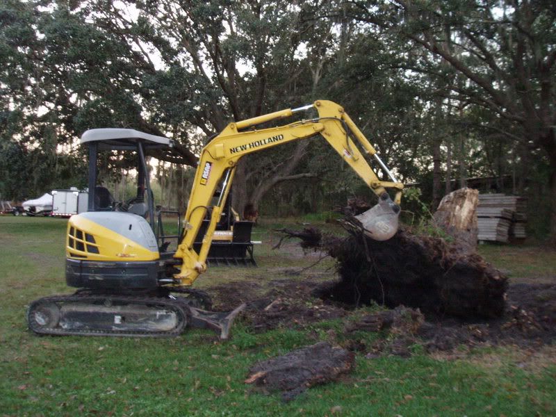

I am making a hydraulic thumb for a Mini excavator. My question is does anyone know where to get a couple of pin and bushing sets. I am having trouble allocating a set. All the hydraulic cylinders I find are all only a 1" pin (3" bore 12" stroke). this size matches the others on the machine for bore. I think the smallest pin on the machine is a 1,1/2". I am worrid about using a non pin setup leading to too much wear on the base materials.

Thanks guys here is a pic of the machine it is going on
