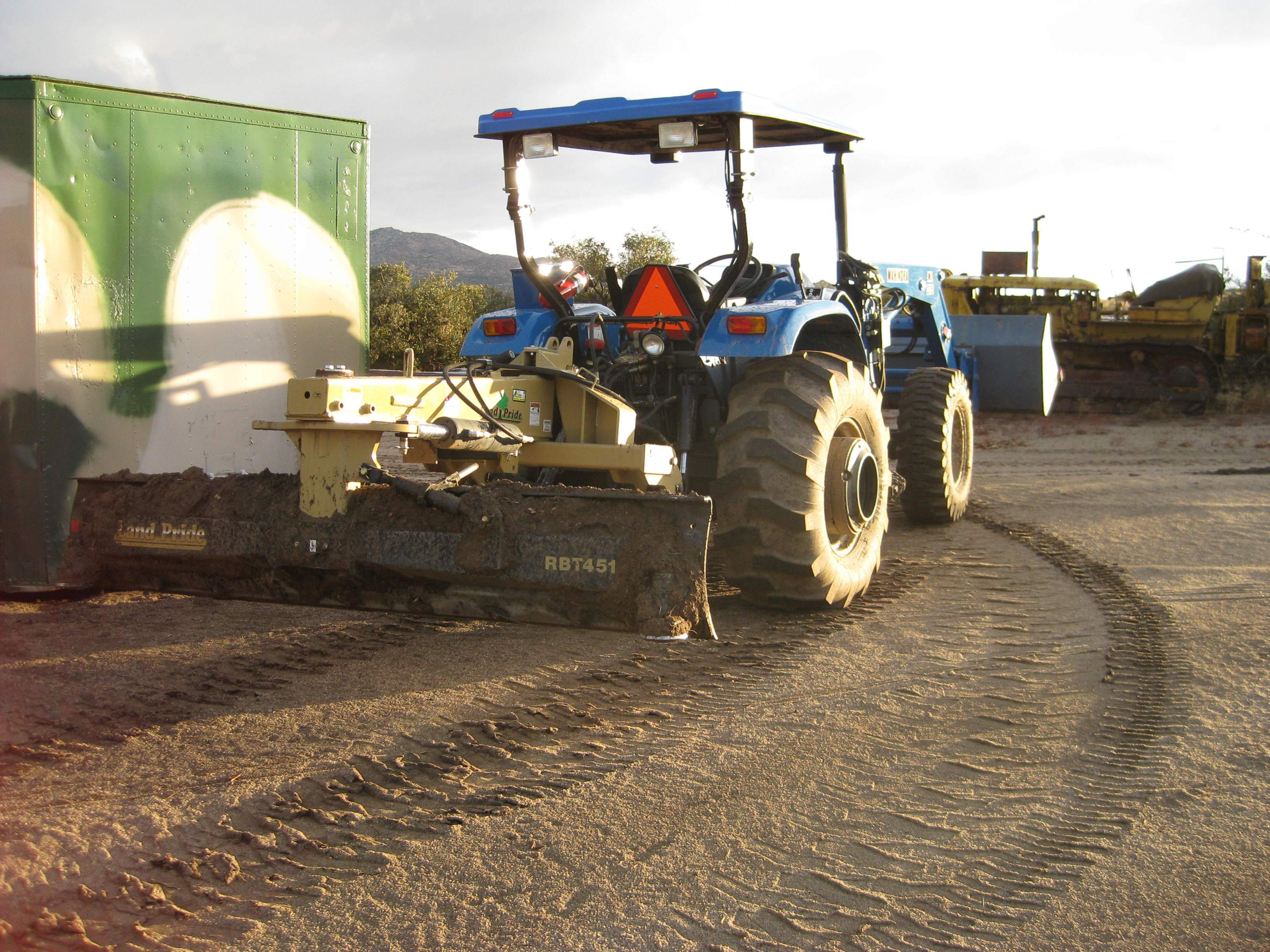

He has a land pride rear blade and it’s set up nice.
Thanks darmstrong2319.
My blade is a Land Pride RBT45108. A (cat 2-3) 9' blade rated for a 15,000lb machine. I purchased it with all manual adjusters and skid shoes. Added the blade angle hydraulic right away and just now have added 2 more rear remotes to the tractor for a total of 5 sets of rear remotes, so the rear blade will now have hydraulic offset also.
I rely on the 3pt hitch tilt for any blade side-side tilt needed. It is one of my most used implements.

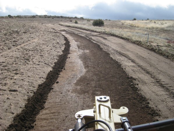

No, this is moving some material. ;) And yet even with that full blade, the material left to the side isn't all that much.
The last picture shows that a single cut can be made and feathered all at the same time. ;)
