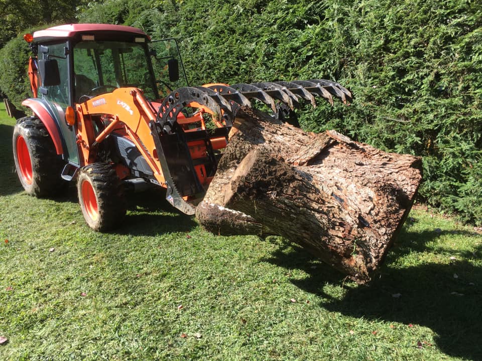

Hey man, you could really go with the 239 pound Wicked 55 or the 400 pound Wicked 60 for your Kubota L3560.
I've sold both models for tractors like yours and no issues have been reported at all.
BRmyers has the 55 on his L3560 and has shared the following pics with more in our Original Wicked Grapple thread.

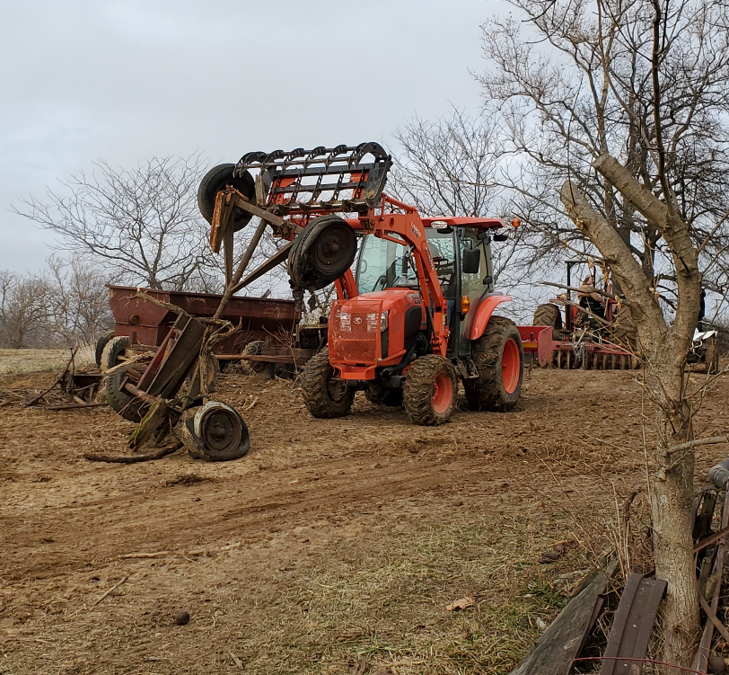

If you plan to be really rough, some have chosen to go with the 60. A couple of pics..
L2501. He has very rocky soil, in the MO Ozarks and chose the brute and it doesn't seem to be hurting his ability.
L3240 with a 60. WOAH.

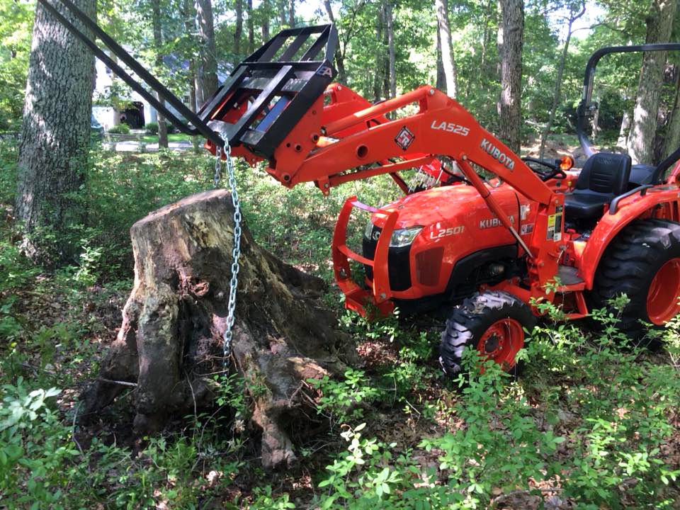

Since you'll have a grapple, I doubt you'll be pulling any stunts, or stumps, like this. :laughing:

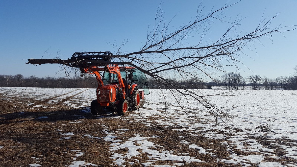

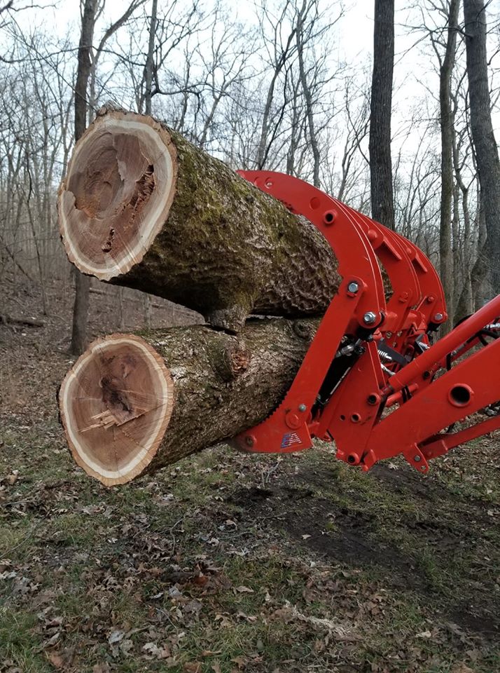

I have the wicked root grapple but i move a lot of fire wood and logs with mine. I have used it to clear areas but it was recommended more for the purpose of firewood. Hence my picture. Which loader arms do you have with your tractor the LA555 or the LA805? The difference in the two's lifting capacity is 530 lbs. If you have the LA805 I would go with the wider little bit heavier grapple. It is more money though, I believe either one you choose will work great everything attachments stuff is build tough.
