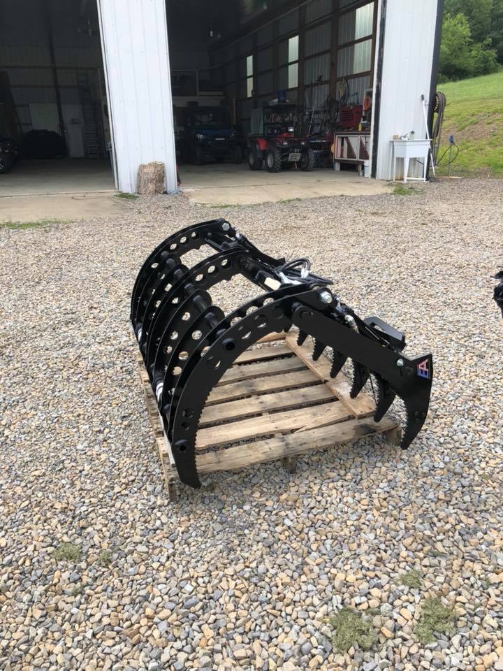

Achievement Unlocked! Wicked 60" Root Rake Grapple earns "Old Man" seal of approval!
Got my 3rd function valve from MIE installed today. Hooked my new Wicked grapple onto the tractor, and headed behind the house to clean up some dead trees we had cut down. Judging from the 6 minutes I spent on the machine before being kicked off by my 75 year old father, I think I'm going to like it. Dad definitely likes it! That thing closes with authority. The dead pine tops he was piling up were snapping like toothpicks when he clamped the grapple down on them, and he was smiling the whole time! Its his new favorite attachment! I'll have to sneak out with it sometime when he's not around to get a little playtime with it myself! He was raised on a farm, spent untold time with tractors and implements, so when he brags about any "new" piece of equipment, you must be doing something right!
