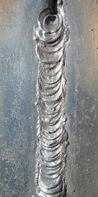

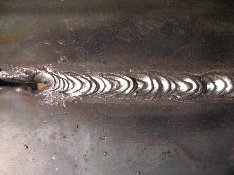

Hobart 6011, dcrp 1/4 no bevel open butt. 2nd one is overhead, no prep, square open butt and full pen with keyhole.

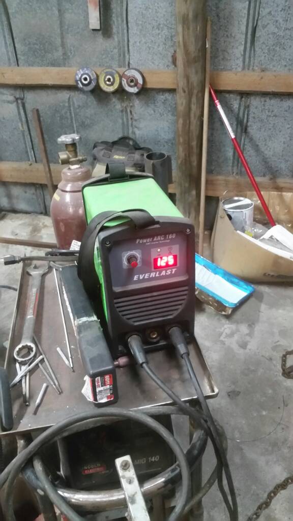

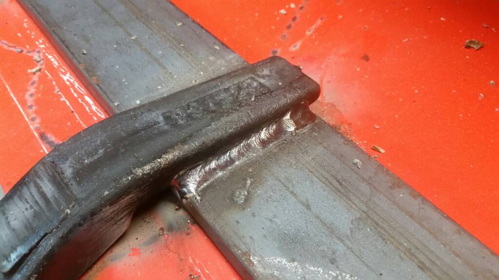

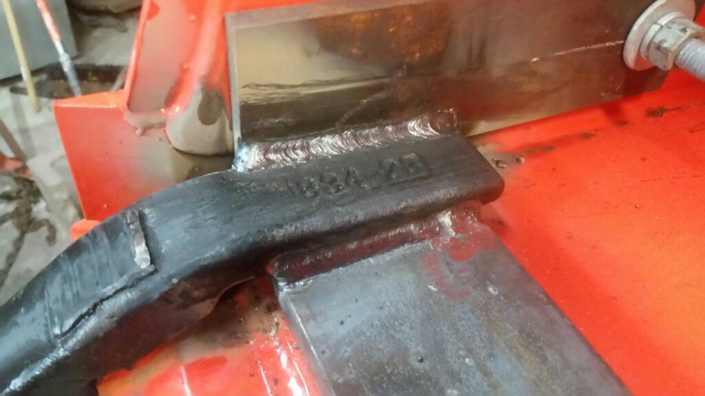

Want to touch base here again I actually used the 160 pretty extensively this AM to weld out my tooth bar and it did and exceptional job. Want to apologize to SA for my 7018 skills I'm mostly a mig/tig guy don't get a lot of stick time in the shop.
Power Arc 160
TSC Hobart 1/8 7018
Light preheat with oxy/propane
125 amps
   / Everlast PowerArc 160 #57
They look very good to me.:thumbsup: With these inverter welders, I find ESAB's Acclaim 7018 runs the best.
#58
They look very good to me. With these inverter welders, I find ESAB's Acclaim 7018 runs the best.
I'll have to keep my eyes out for those I mostly buy the TSC stuff because it's easy and come in a manageable quantity for home use.
   / Everlast PowerArc 160 #59
I have my local Airgas bring them in for me. The welding supply I normally deal with, is not an ESAB dealer.:(
   / Everlast PowerArc 160 #60
Looks good to me.. The little PA160 is small, lightweight, easy to carry, and makes some nice 7018 beads! I know I have one...:thumbsup:
