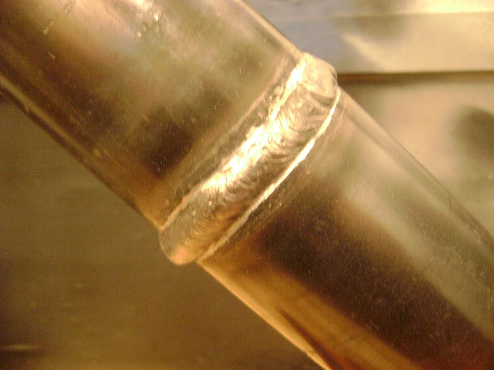

Atom Arc runs nice. I think the Acclaim is just a touch better.
This weld is ESAB Atom Arc.

I don't doubt you one bit! I'm probably not good enough to tell the difference, but I'd like to give the Acclaim a try. I just remembered I got my Atom Arc 7018 off eBay for $75 shipped (50lbs of 1/8")...thought that was pretty decent.

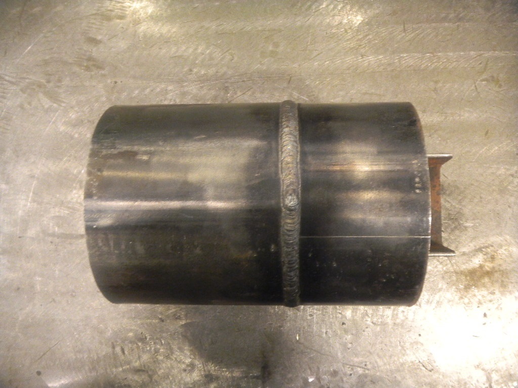

Actually it was the older version PowerArc 200 that you had to hold such a close arc length when running 6010. The PowerArc 200ST welds just like any other welder when running 6010. I found that ESAB's Sureweld 10P-Plus 6010 runs the best.

I'll have to try some new stuff then, because I was experiencing the arc snuffing out. CJ
