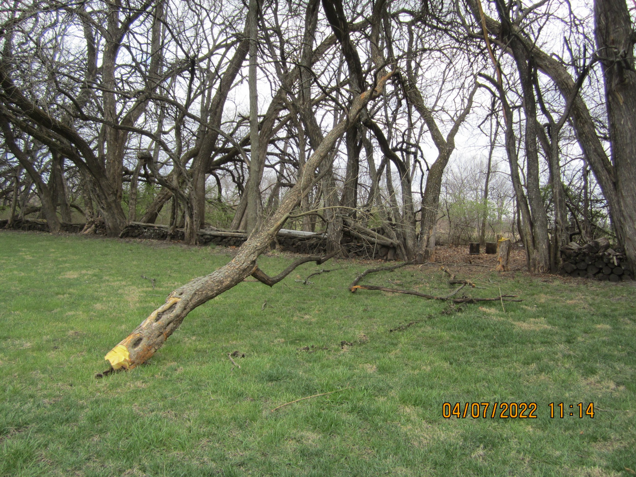

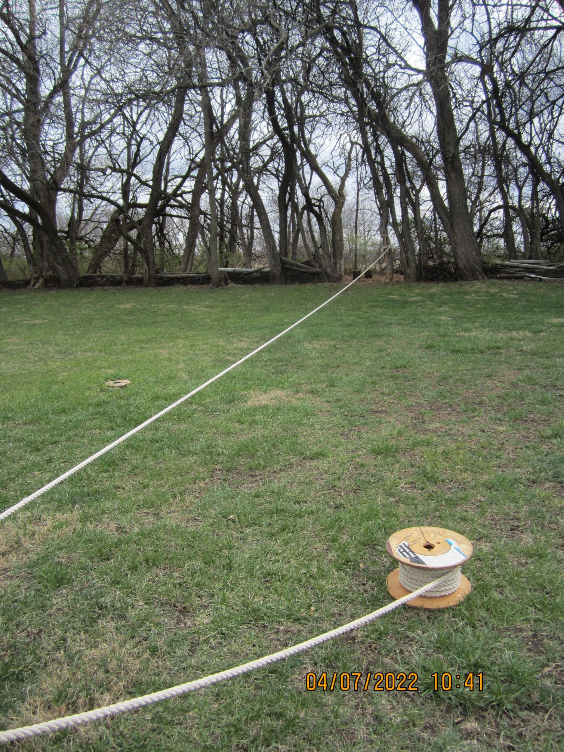

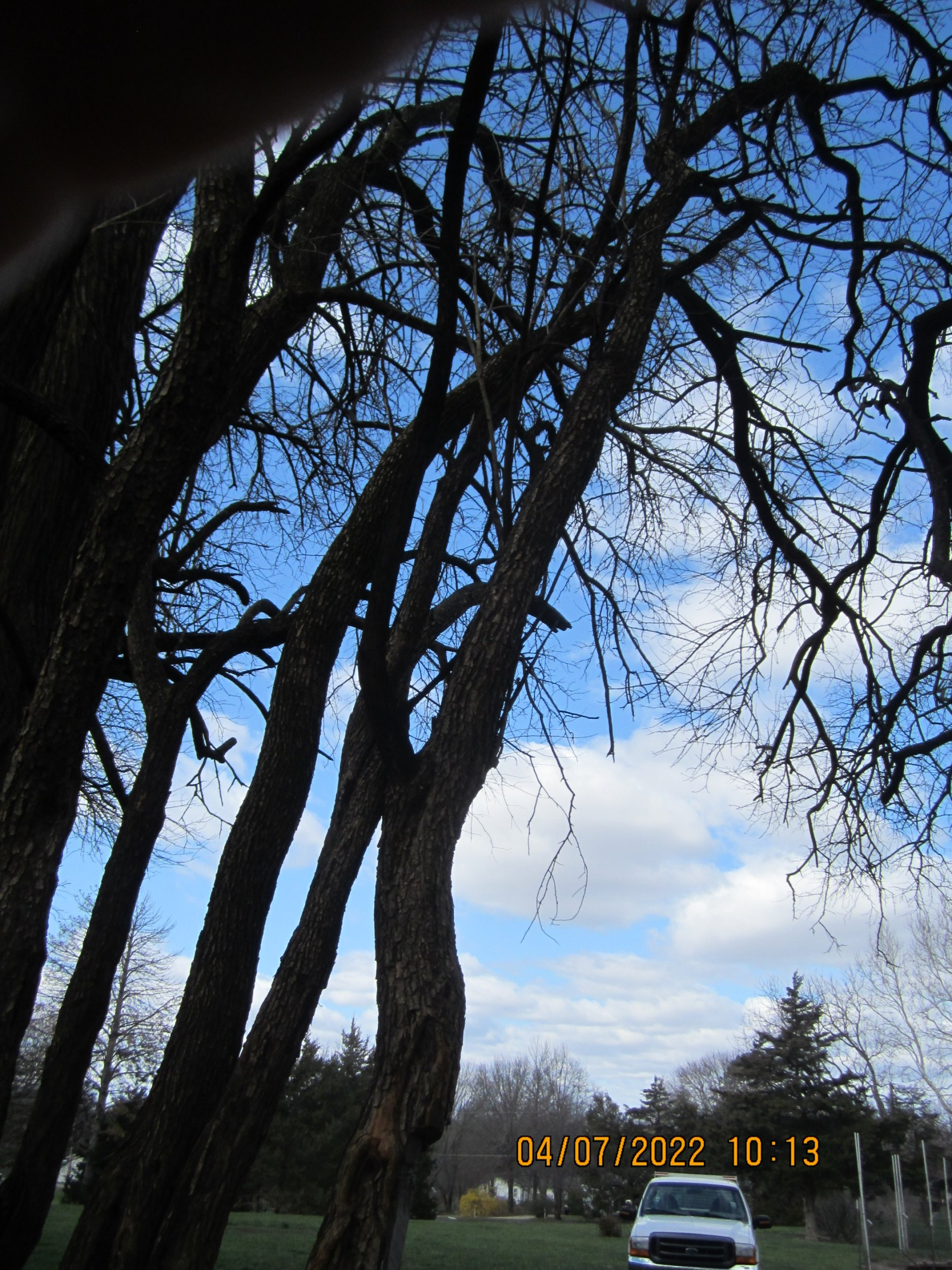

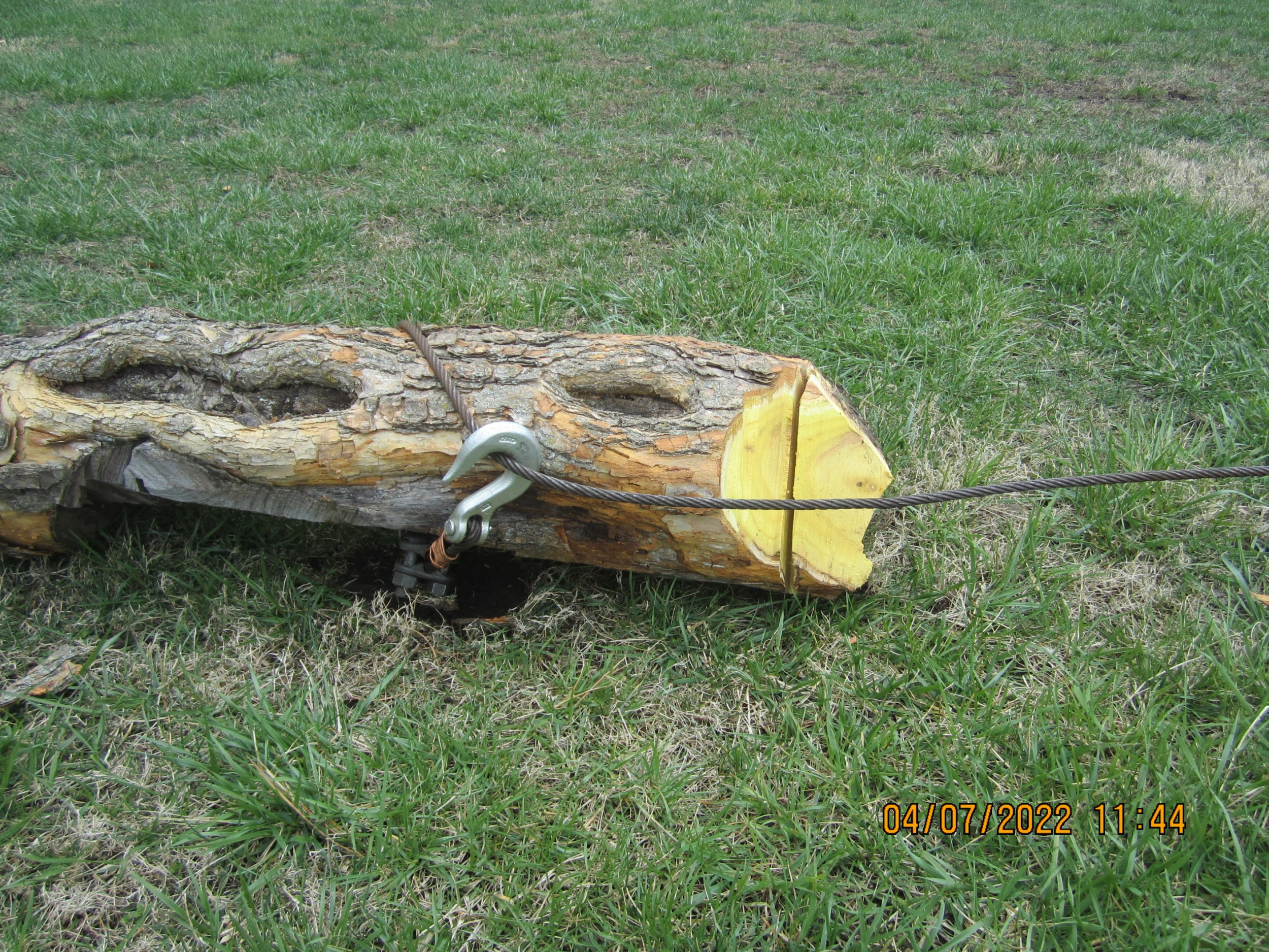

I don't know about "redirecting" it, but I have done it with steel cable around the trunk (something that wont fray when dragging the butt thru the dirt). Then a long rope about four times the height of the tree....attached to my F-250.

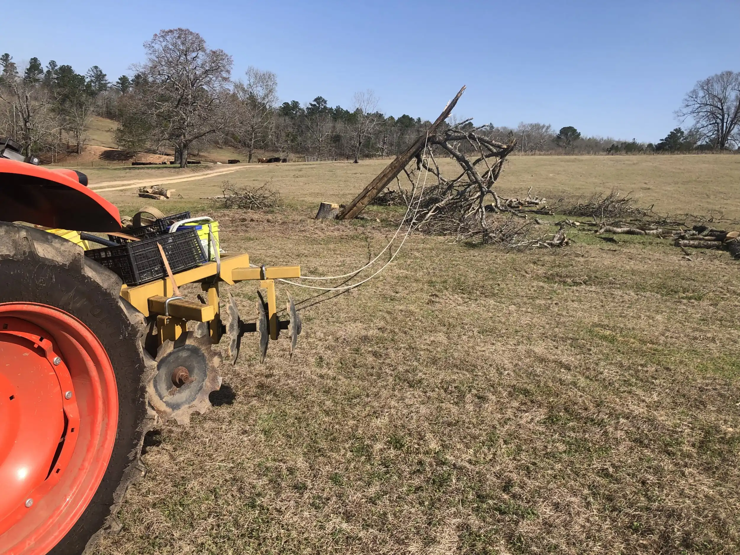

I've got a 150' "bull line" I picked up a while back I use for all the tree chores aside from dragging them through the woods, works great. I usually redirect with a 4'x2" strap and a gigantic shackle (Think it's 1 1/4 diameter?).
More typical of my use for the bull line, this was tornado damage. The stump had about 20' of tree on it I had to cut to get at this top portion that got ripped off, this was actually about 4 hrs into the cleanup project finally getting to where I could access the widowmaker.

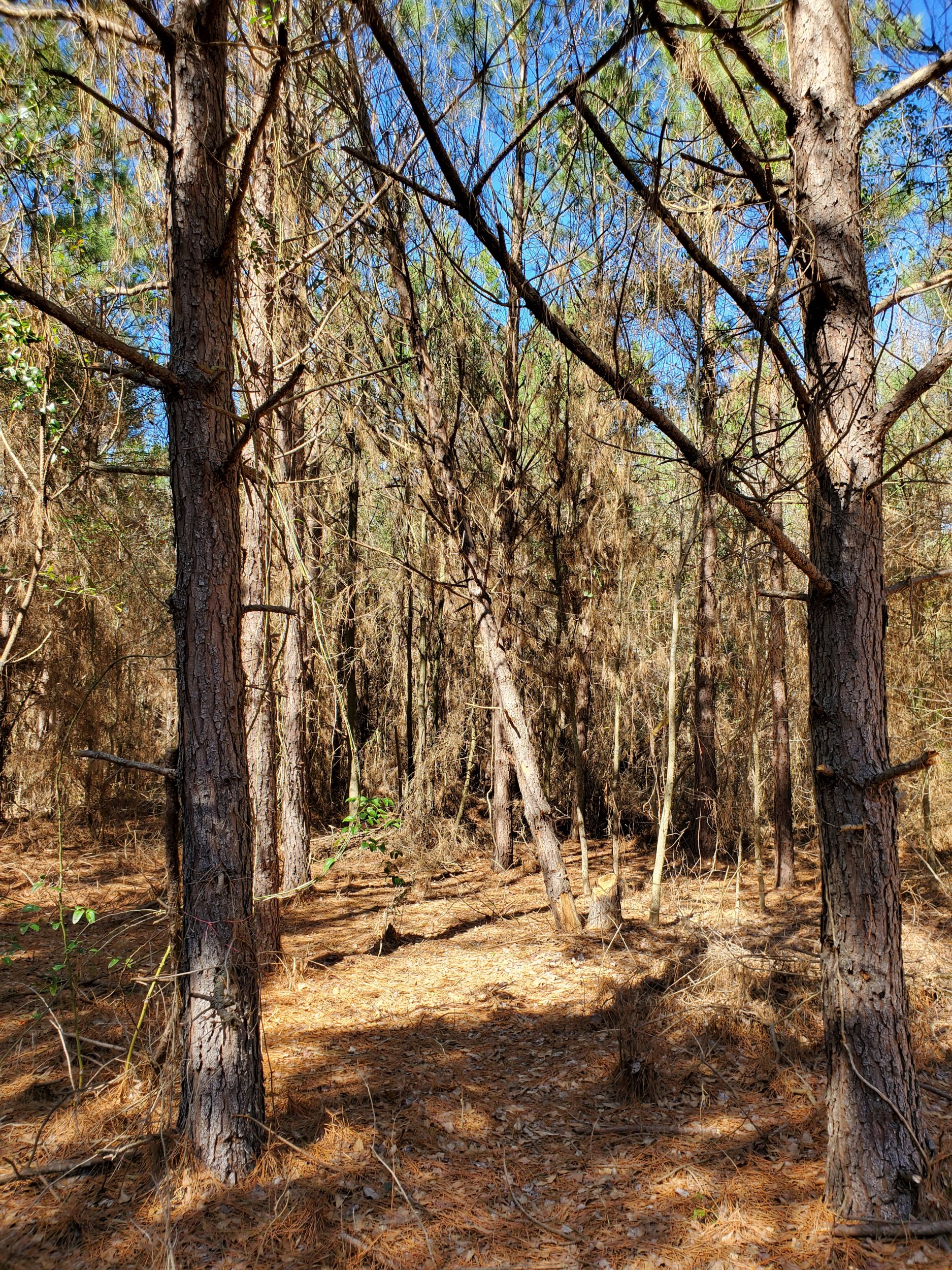

Alright. We were out there today and I snapped a shot.

Looking at that picture if you give it a good yank to the left, as seen, I think it should roll off and fall.
You're thinning project looks a whole lot like mine, what a pain.
