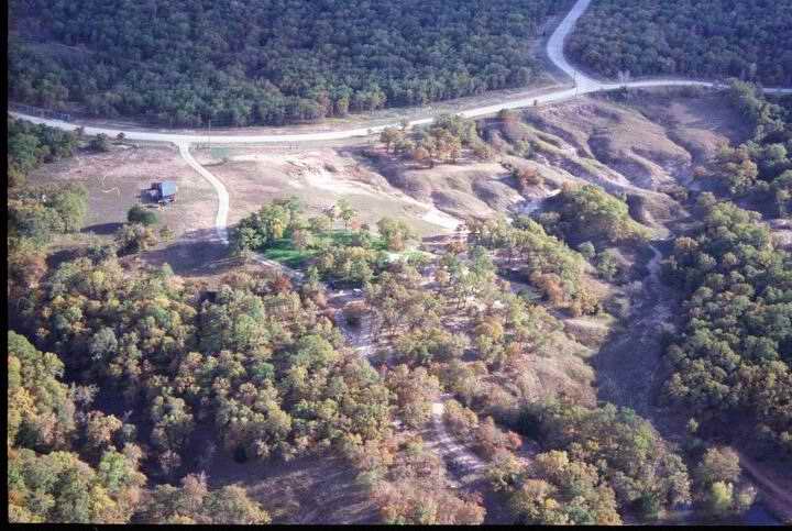

I should be closing on the below 37.5 acres in the next few weeks. I am past pumped! I will start a thread when we close to show the improvements and ask for advice. Maybe I just did.
I have several issues that I need to handle pretty fast:
There is an erosion problem that I think was made worse by something the previous owner allowed to happen; I have piles of saw dust sitting near the entrance.
I have the below picture labeled several ways and will post a legend.
I divided the property into 4 sections: A=NE ,B=SE ,C=SW,D=SW.
All improvements (well and electric) are by the letter C and there is no septic yet.
The middle line is contour with 4 hash marks.
There are four sections: numbers 1,2,3,4.

EROSION
The highest elevation is in area A/B
The number 1-4 show the erosion area. The worst are #1 and #2
I think the saw dust disturbed the normal flow of water draining from the land.
So after we solve the saw dust problem what is the best way to solve the erosion issue?
I assume the land will have to be recontoured.
The above is dozer work.

Stan, thats a big piece of property and has several needs that I think I can see. You have some definite challenges ahead. The last picture looking across the road to your neighbor's place shows what I'd be looking to do. You need to get some grasses growing to stop the erosion of all your topsoil. You neighbor has a pond and you will probably end up with several ponds to retain water runoff and allow you to plant grasses and get some cover down. Your neighbors place looks alot greener in the photo because they seem to have more grass than you do. Controlling additional erosion and getting grasses would be one of my top priorities.
Next, those sawdust piles may not be a bad thing, but they are taking forever to decompose as they are. There's just not much composting/decomposition going on there. I would experiment with one of the piles by adding urea (100% nitrogen) and dry molasses as a sugar to fuel composting and add carbon. If you can convert that sawdust to compost, it could be very useful. As the compost finishes, you can add it to soil with some clay so it binds together into a finished product. You can see that the sawdust binds up all the nitrogen and nothing grows in it. As it sits, it is not a good growing medium. Spreading it out that way will inhibit natural grass growth and will not aid as a good fill because it cannot be compacted and will just erode in channels and be a hindrance as you have said. I think it would be better as a huge pile in one place than spread all over the surface. Of course, I'm no expert, so your county agent or soil conservation folks can surely give you more quality advice than me.
As far as spreading the compost, I think your tractor's loader and boxblade can do the trick. However, you probably need a dozer in there now to push all that sawdust up into one big pile so you can manage it. A dozer can move lots of material in a short while and that sawdust should present no challenge whatsoever, especially if it is slightly damp and will not create sawdust dust storms.

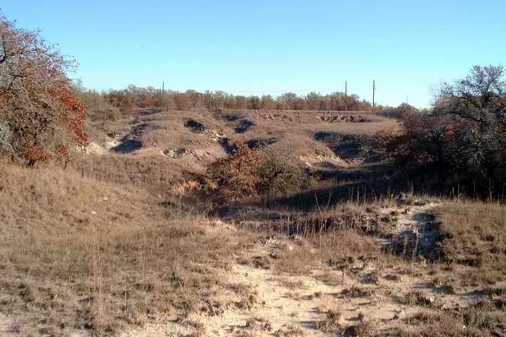

Below, I've added a couple of pictures of my property. Mine is not the red dirt you have, but my erosion is mature and deep. In this area, I will eventually dam up an exit gully and make this area a pond/lake. I don't think it will ever be able to be anything else without several hundred thousand dollars of fill and dirtwork. I'm not that rich.;)
