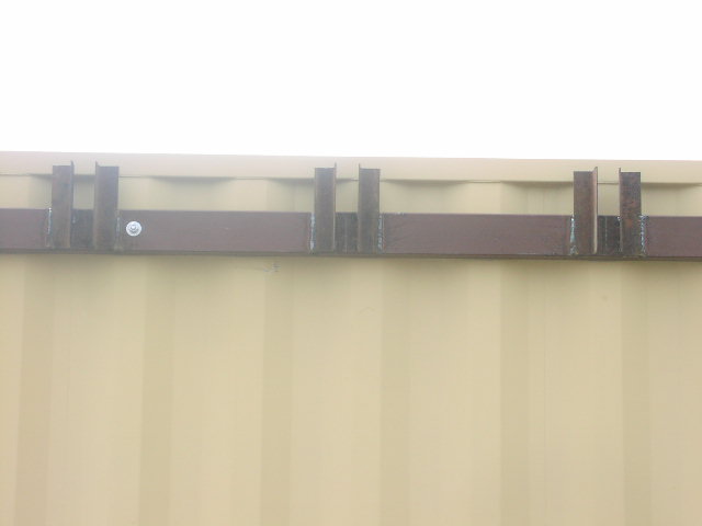

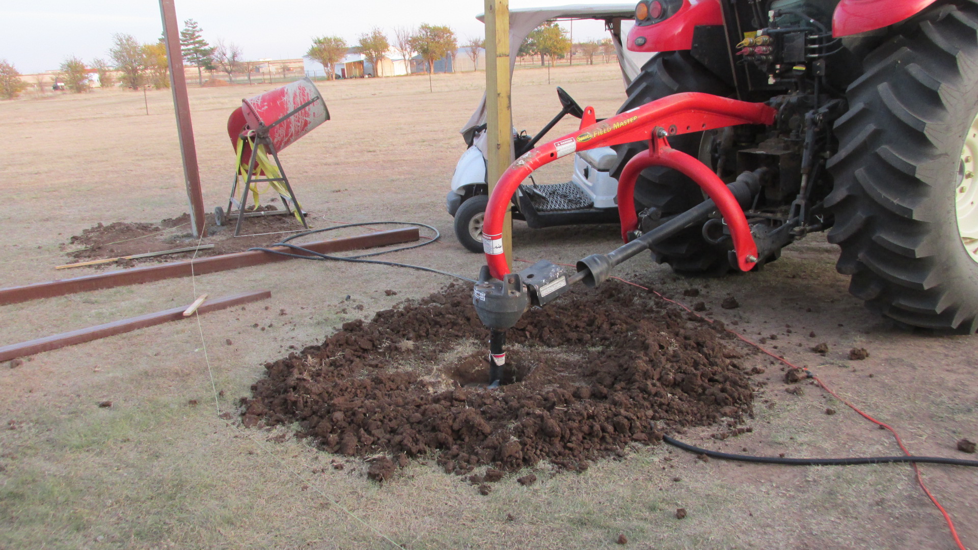

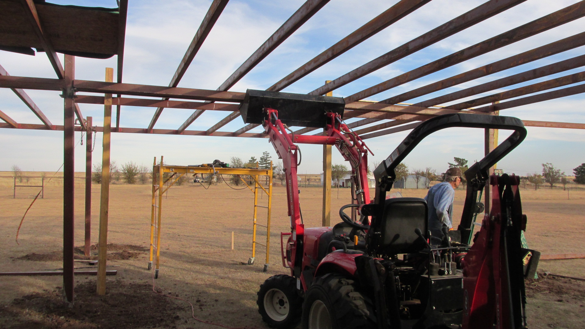

A few more framing pics.
Attaching fram to the tail end of the rafters. The top of side metal will attach to this part.
Digging additional holes for more support post.
Building the rest of the main mid-span header.

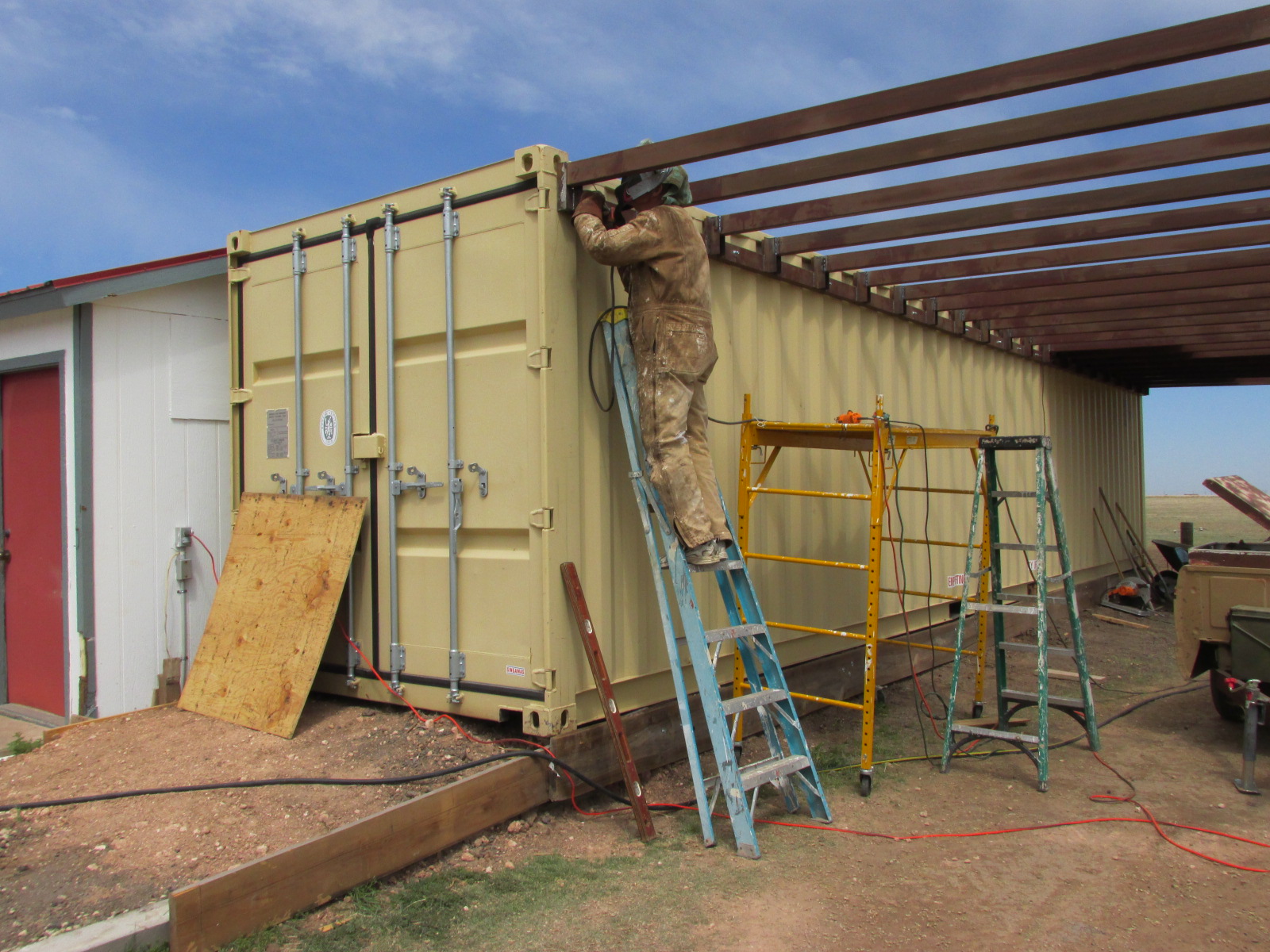

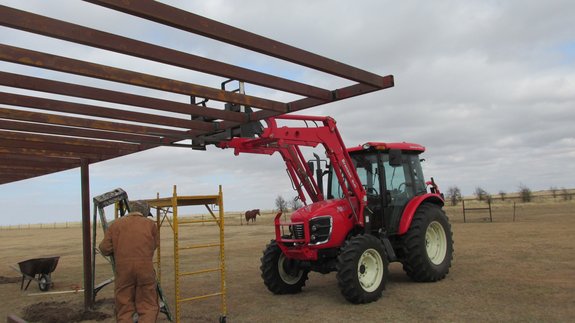

Some additional framing pictures.
Welding in the rafters. Almost done with that phase of the job.
Here you can see the permanent header. The temp. header has been removed.
Starting to install the horizontal rails (2"x4" tubing)

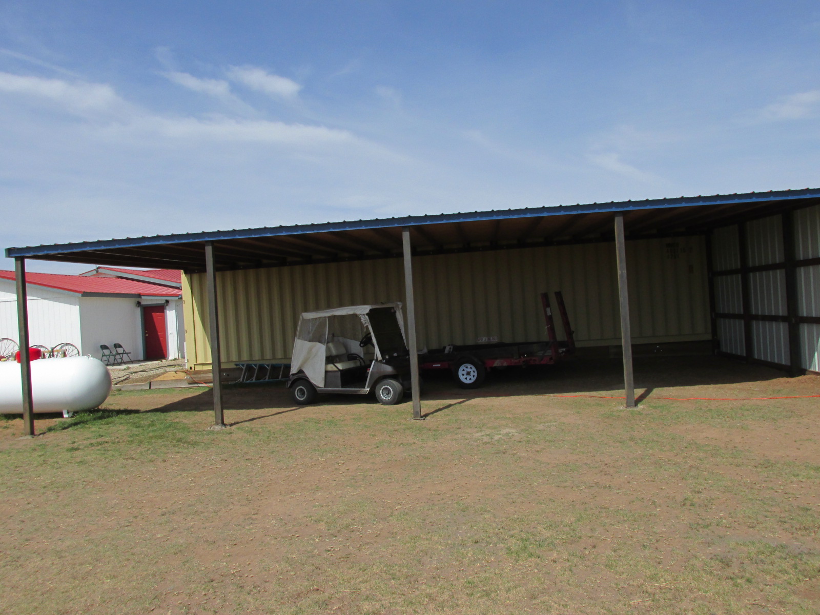

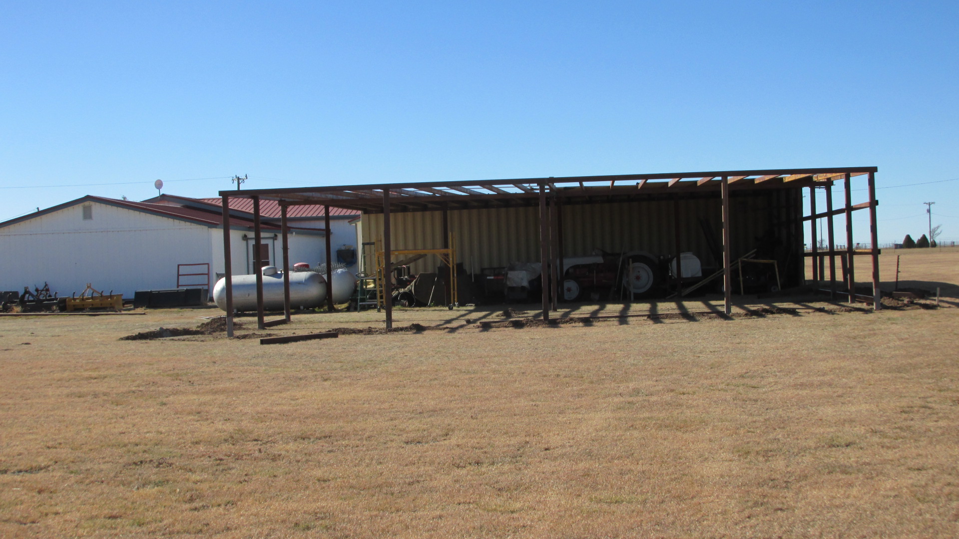

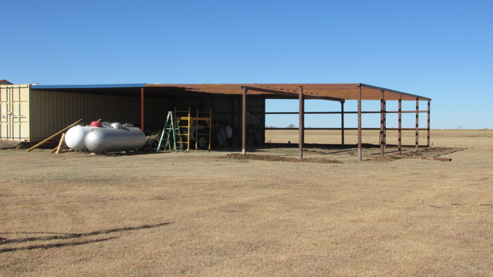

Here are some pictures of the shed addition as it relates to the surrounding property/buildings.

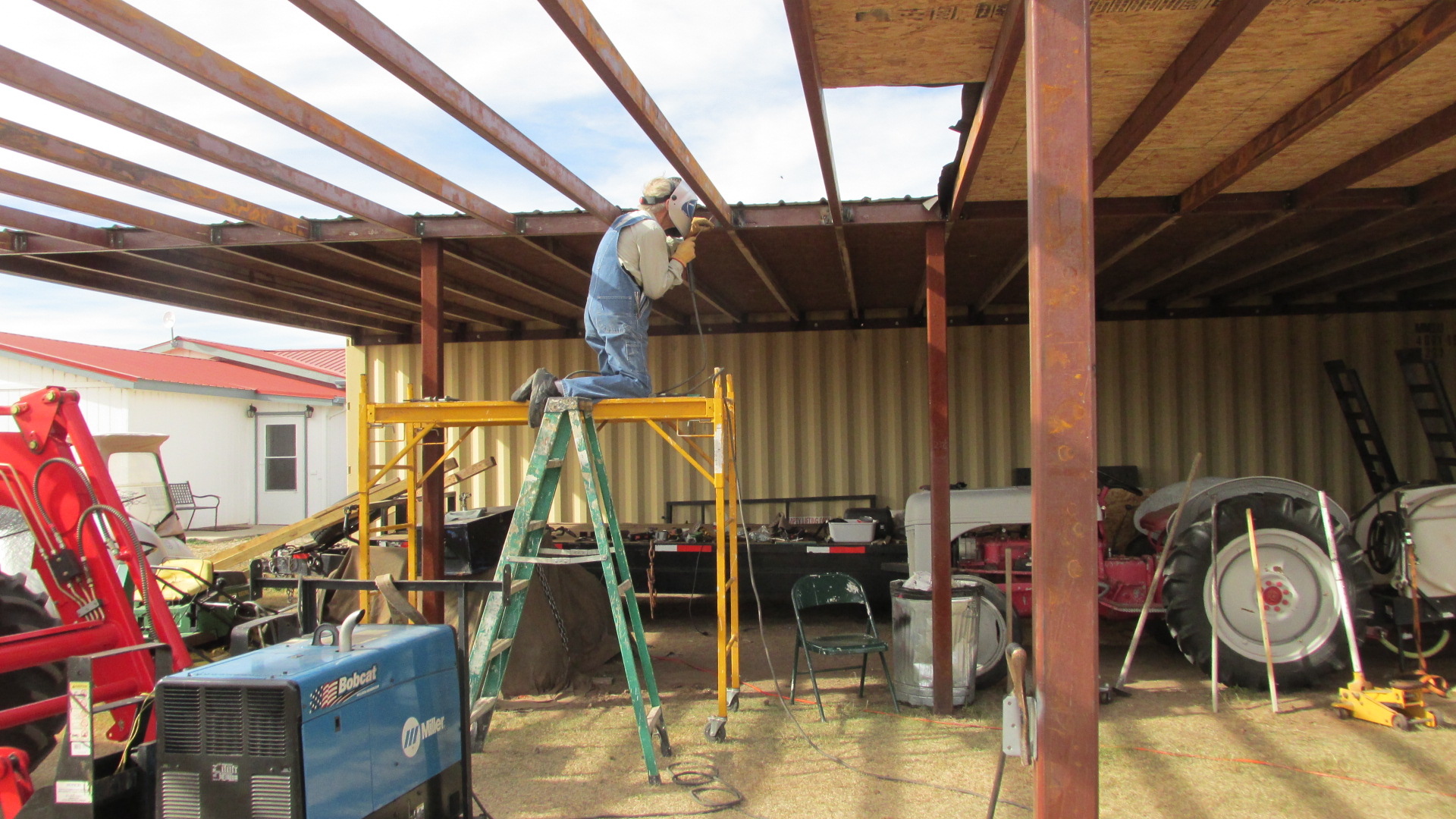

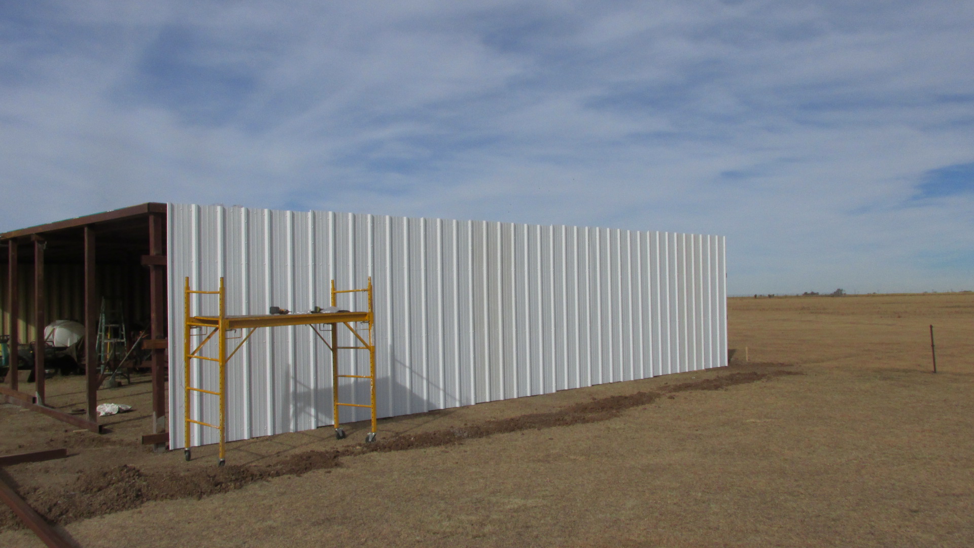

Got a little more done on my shed.

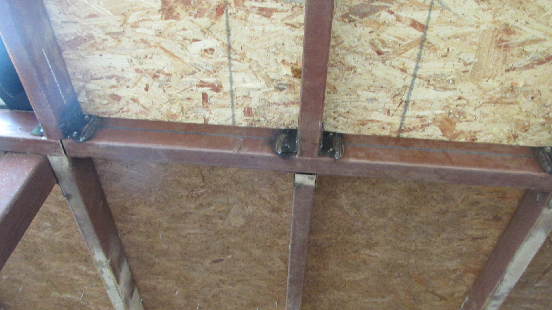

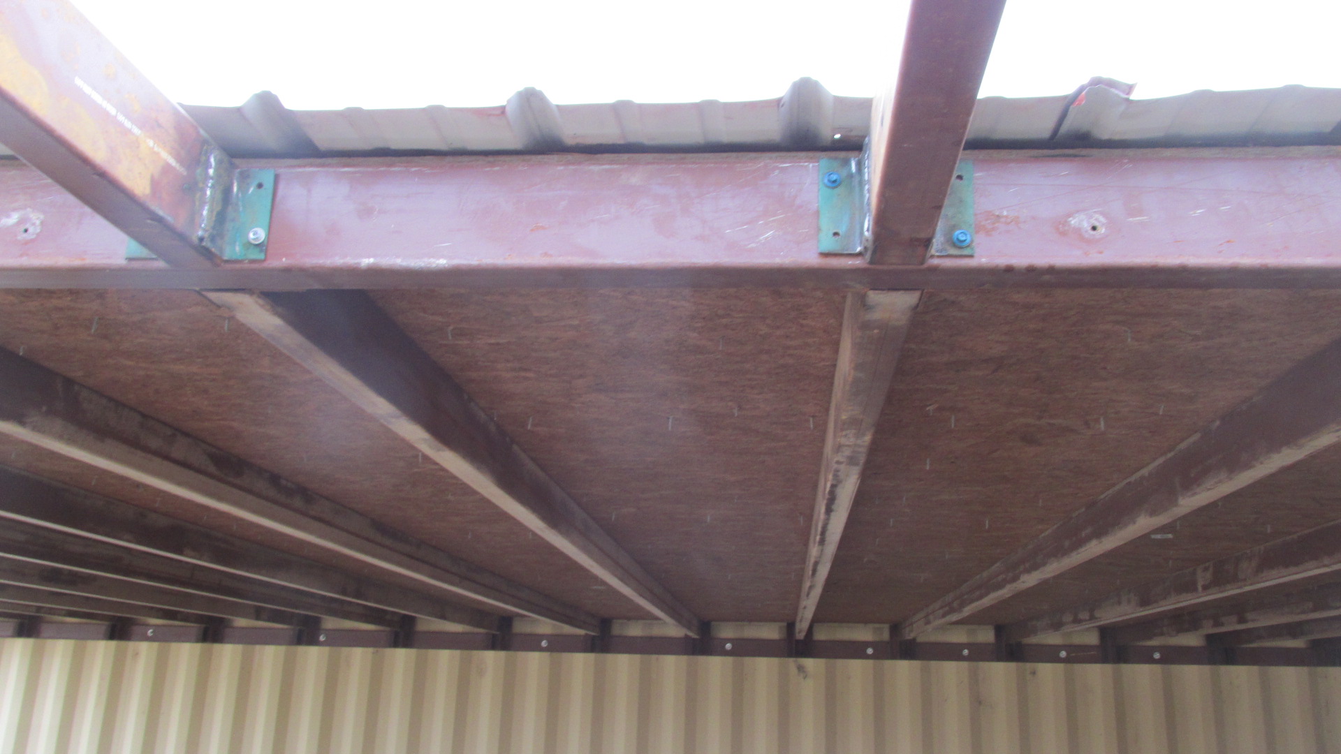

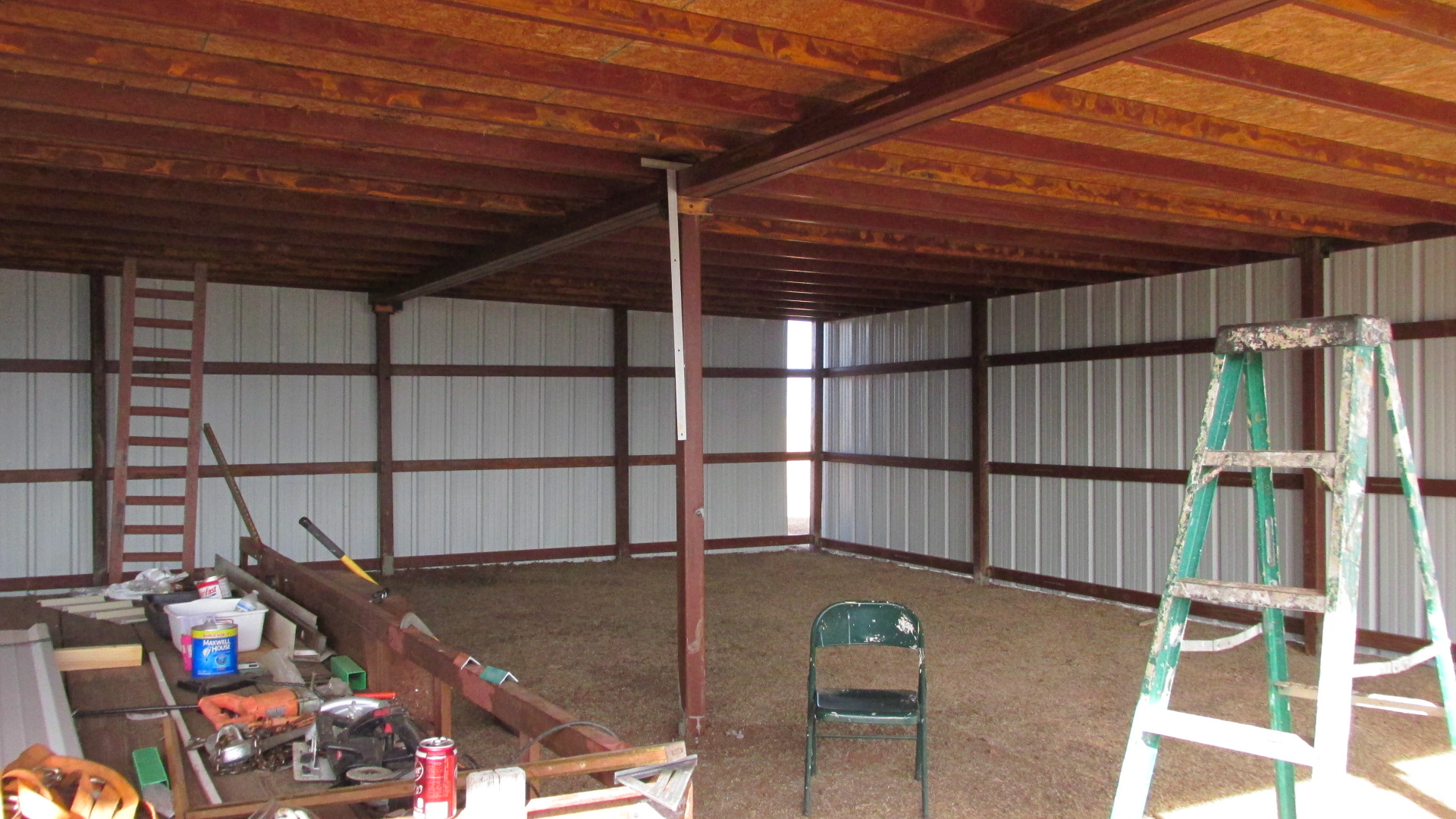

This looks fantastic. How far apart are the rafters? How do you attach the OSB to them for the roof?
/ Equipment shed.
#39
The rafters are on 2' centers. I attached the OSB to the rafters with 16 self-tapping flat head screws per sheet. About 38 sheets.

Looks a lot bigger then I expected with the siding on. That's going to be nice.
