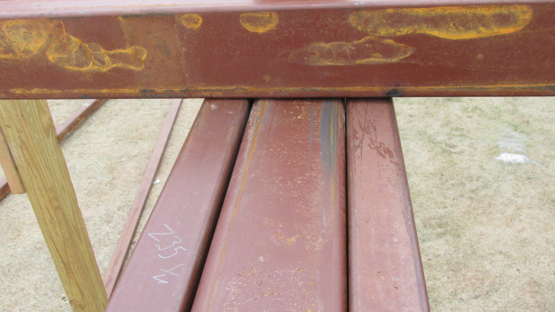

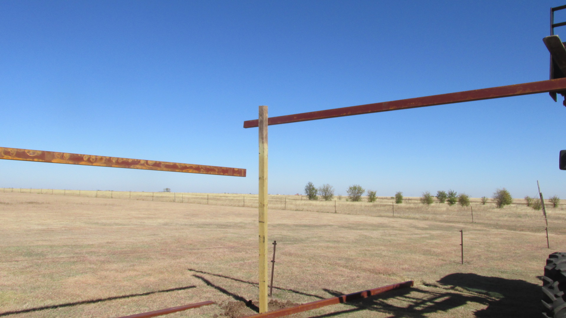

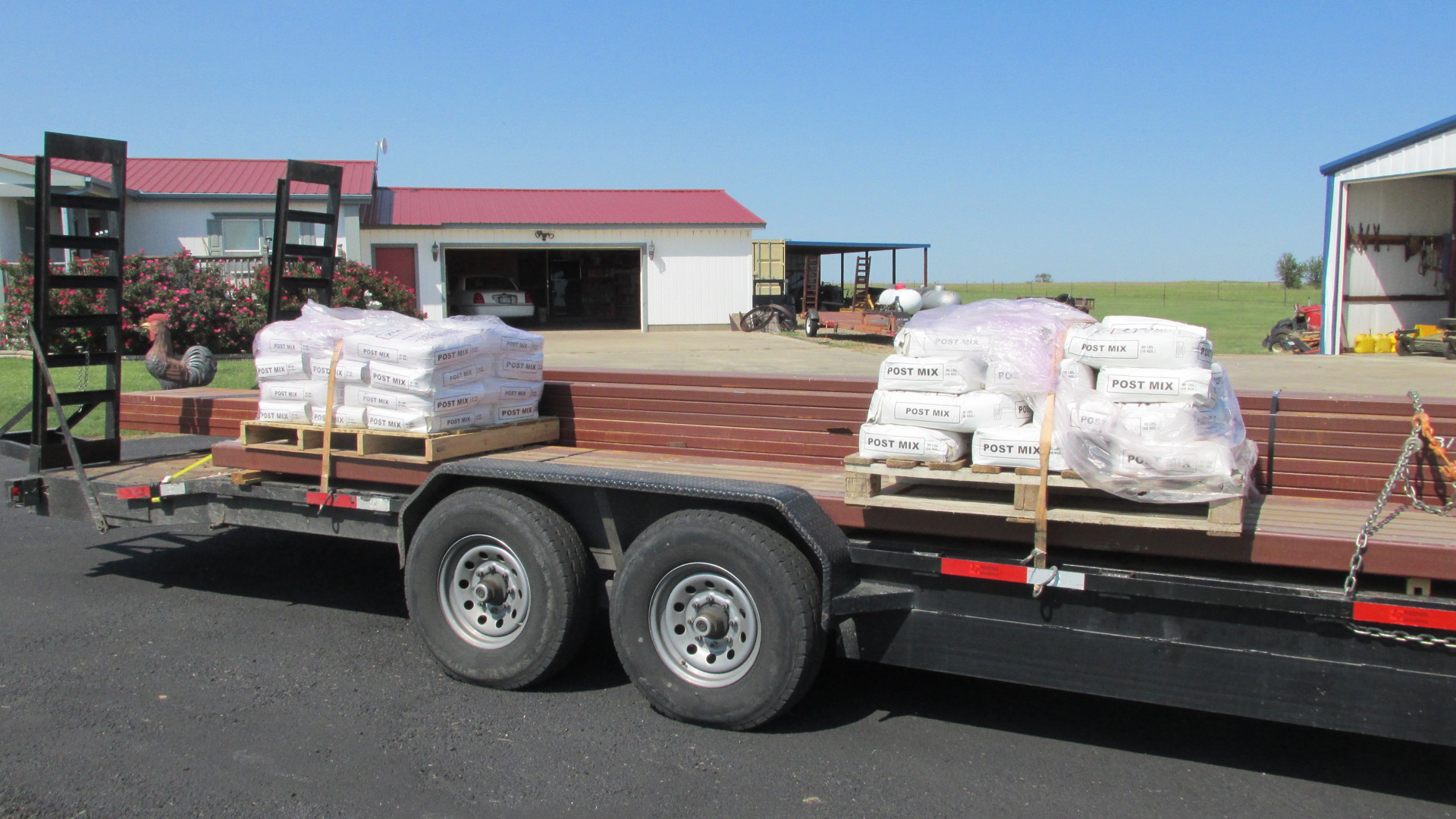

Getting ready to add 1200 sq. ft. to my equipment shed.
Day 1
Removing trim.

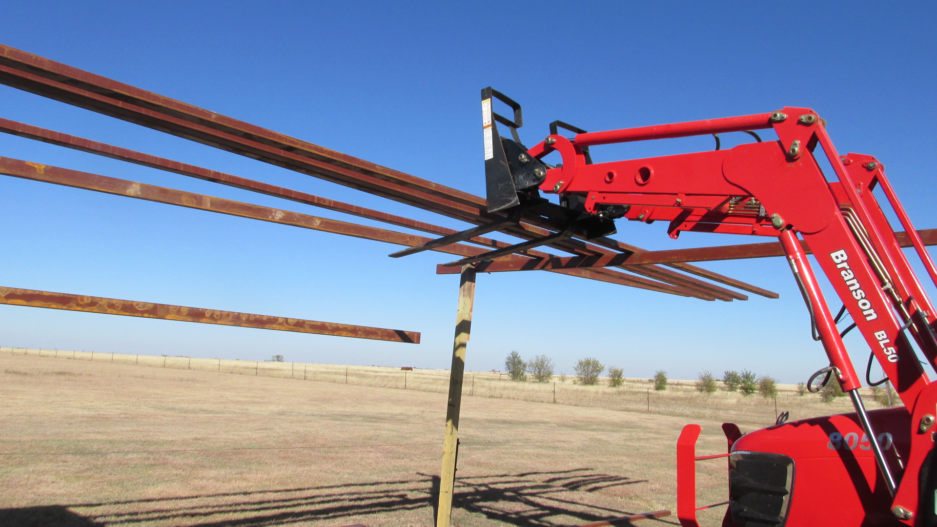

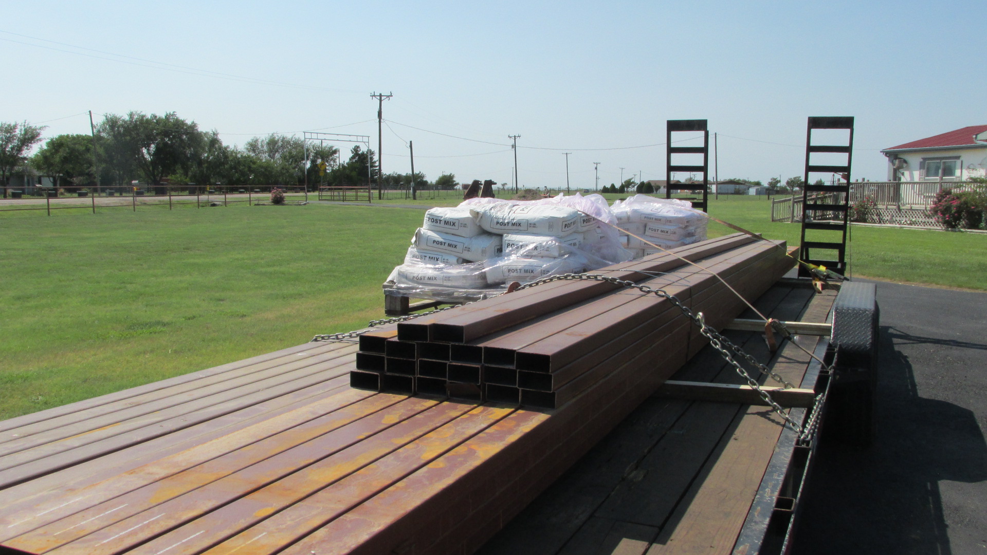

Looking forward to more pics. Are you using 2x4 metal tubing? I have some of that and it's super heavy. Good thing you have those forks!!!
/ Equipment shed.

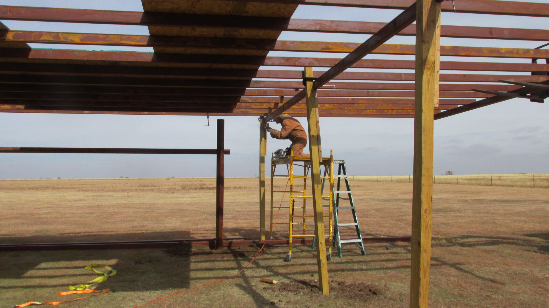

Hello Eddy, Yes I am using 2x4 metal tubing. The rafters are 30' long. 2' spacing. I will post pictures as I progress along. It is a slow go working along. Some times I need to be at both ends at the same time.

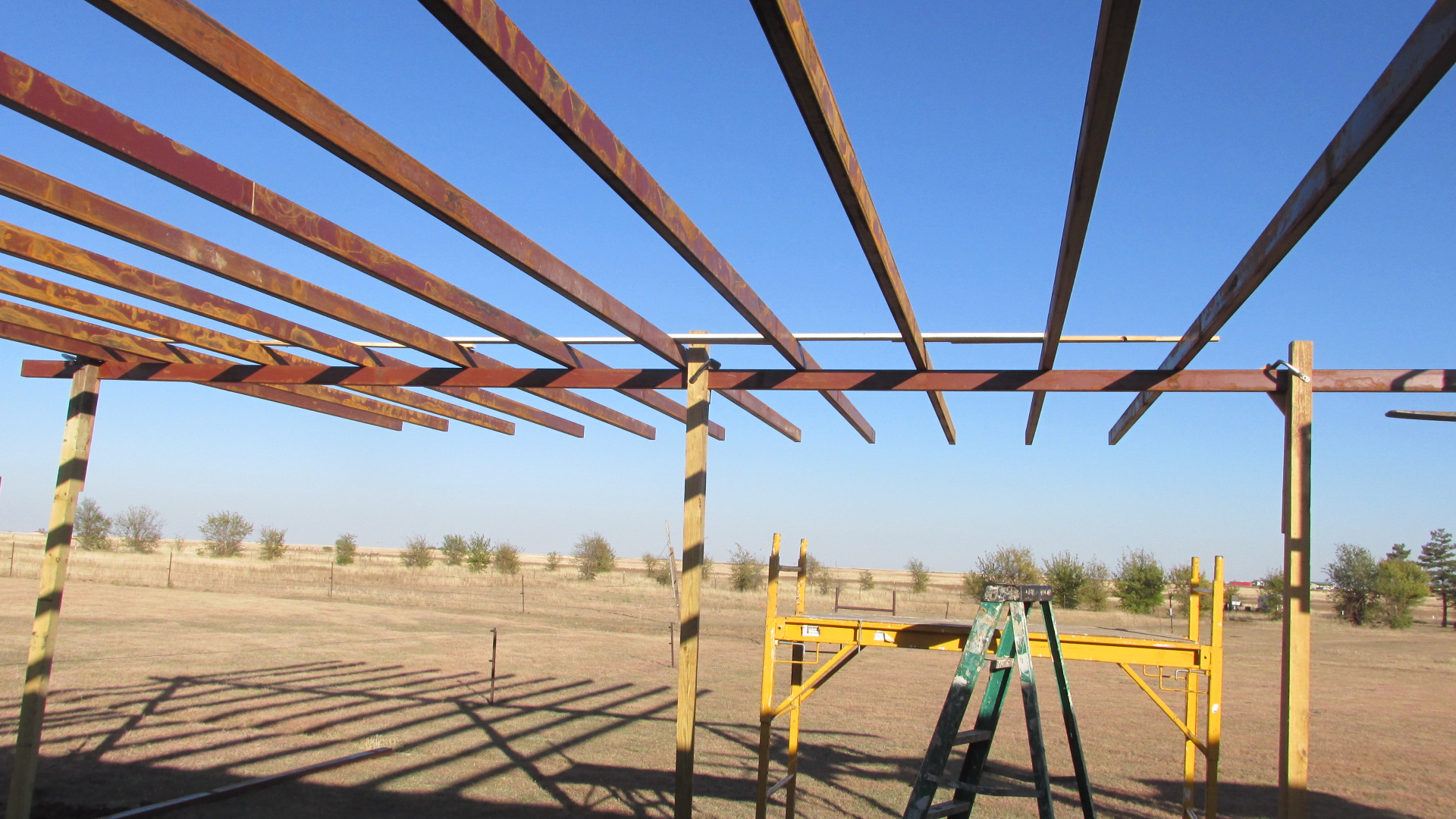

More framing.

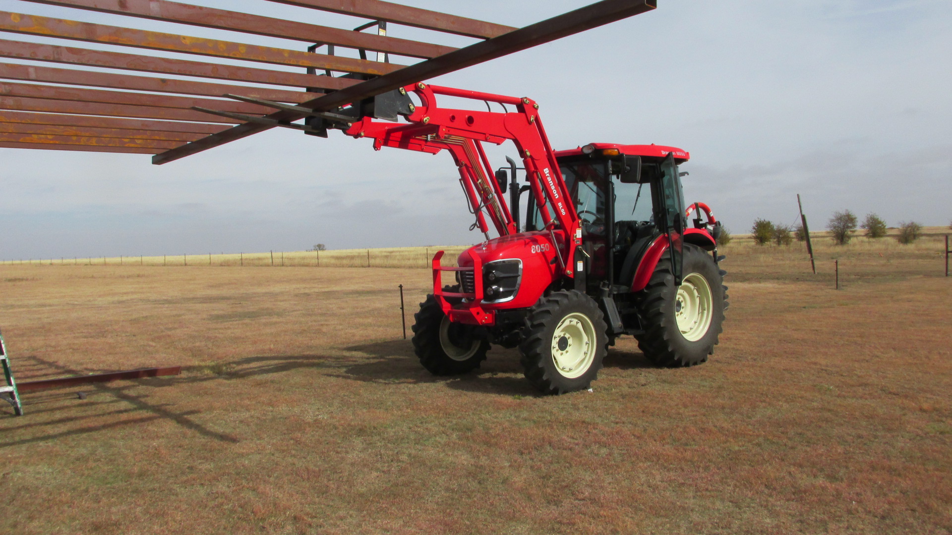

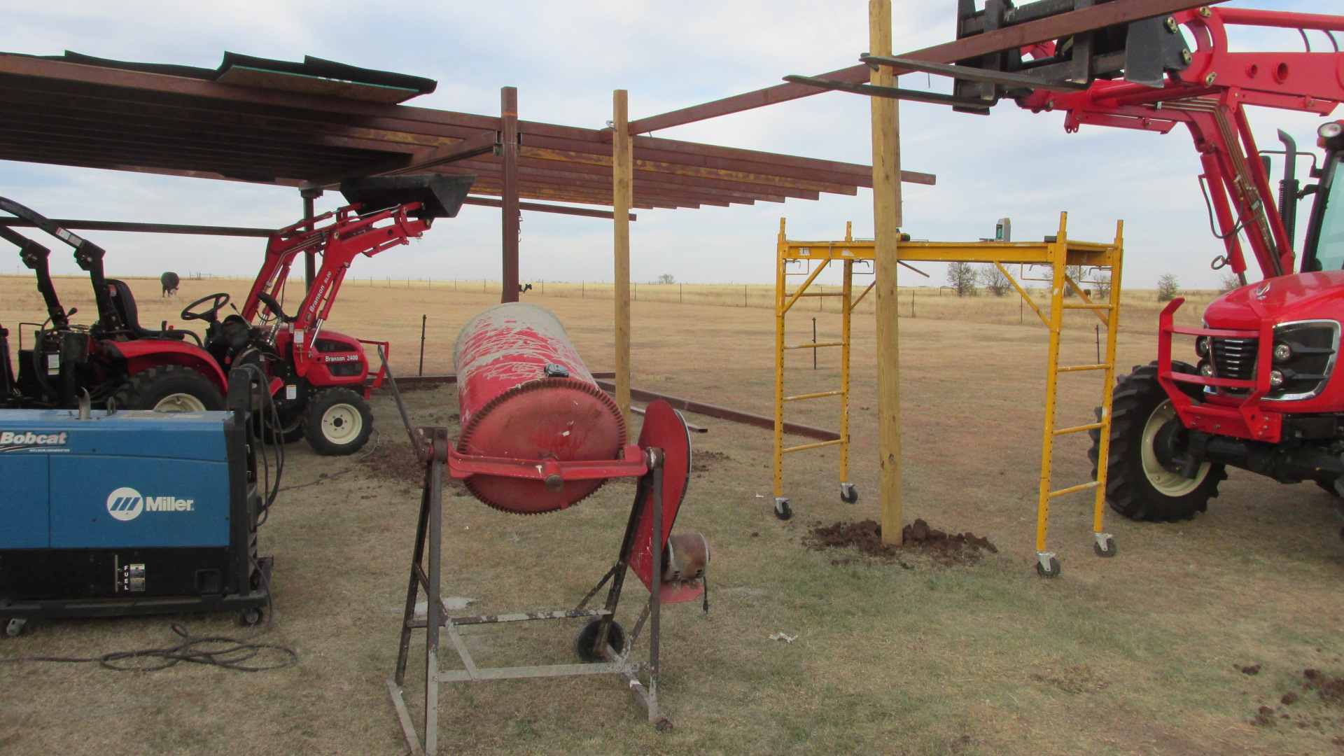

I like how you hold your framing in the air. When one tractor isn't enough, use 2!!!!!

Did you use 2x4 metal tubing for strength over the span? And what brand/model of forks do you have for the front of your tractor. I need to pick up something like that.
/ Equipment shed.
#9
/ Equipment shed.

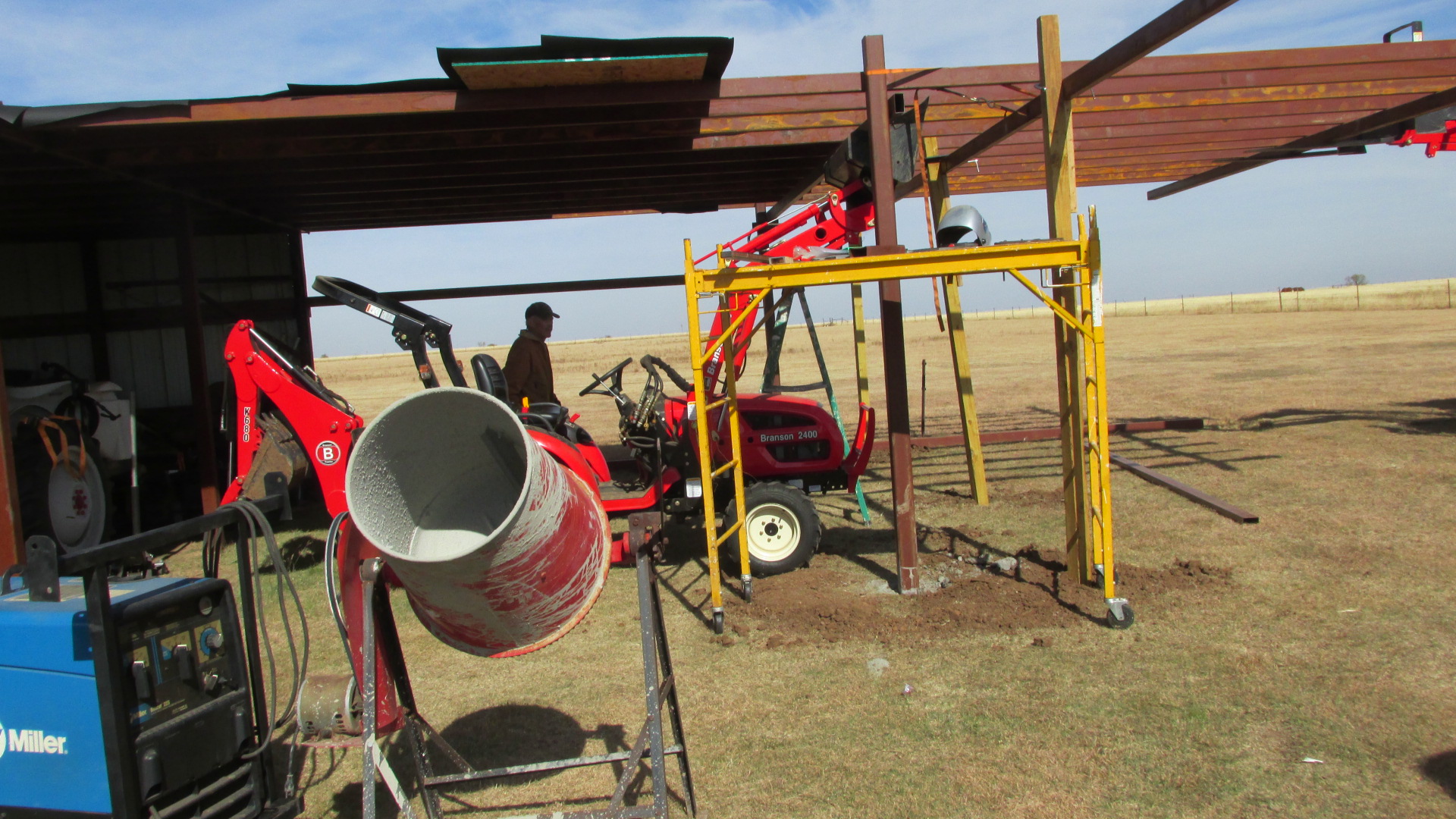

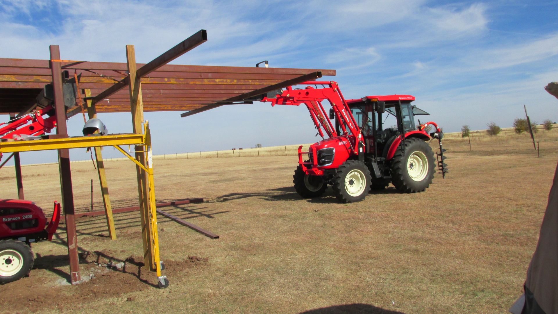

Eddie the big tractor is holding the rafters up off of the temp header (wood post with temp header). I am using the little tractor to put in place the permanent steel header. That header is mid-span of the 30' addition I am adding on. The header is made with 1.. 4"x4" x 1/4" sq tubing and 2.. 2"x 4" tubing. Support post are 4"x4" x1/4" tubing set in the ground 3' in a 12" hole with rebar. Each post has 3 or 4 80# bags of sakrete.

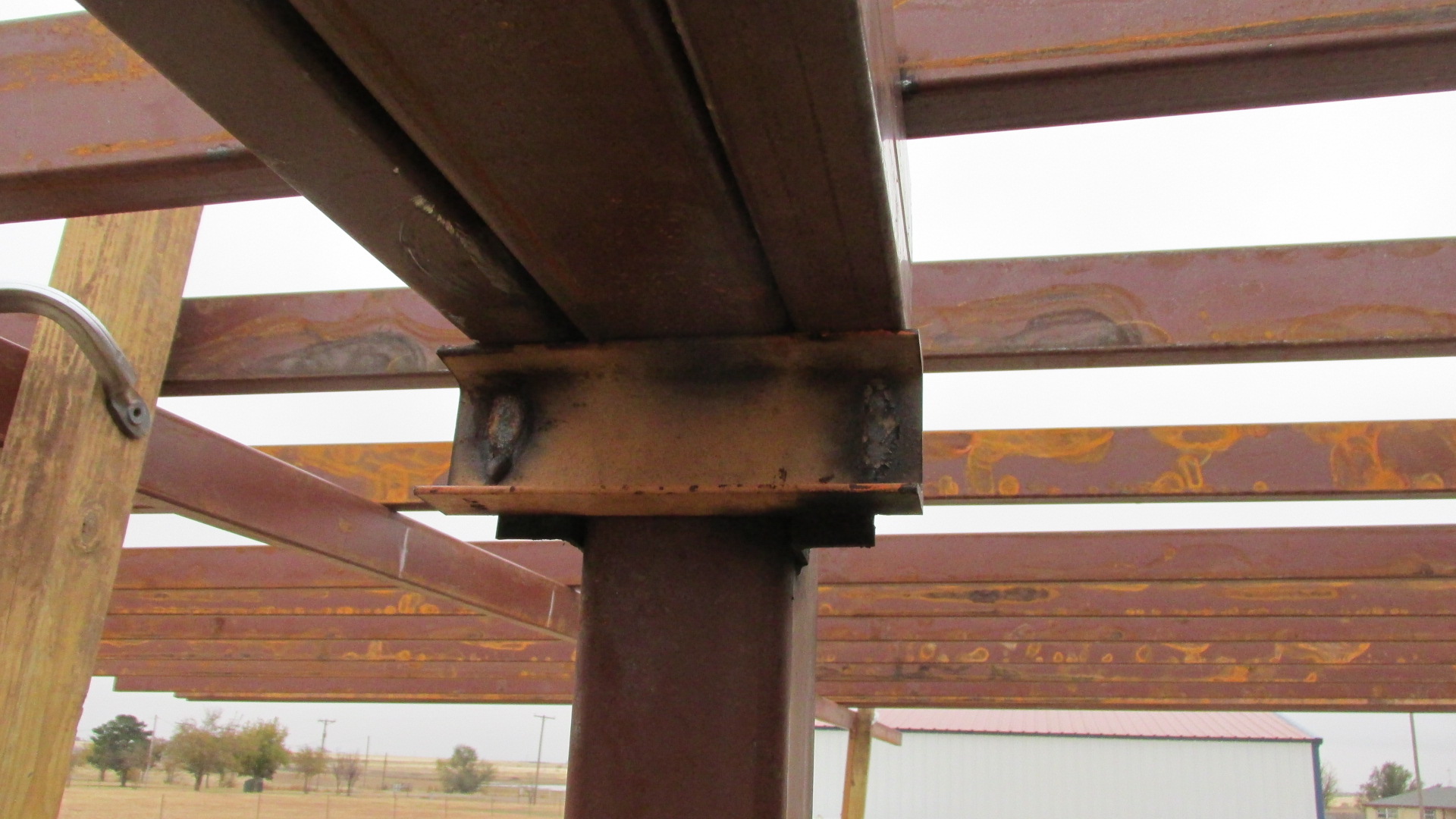

Some details of the header I installed.

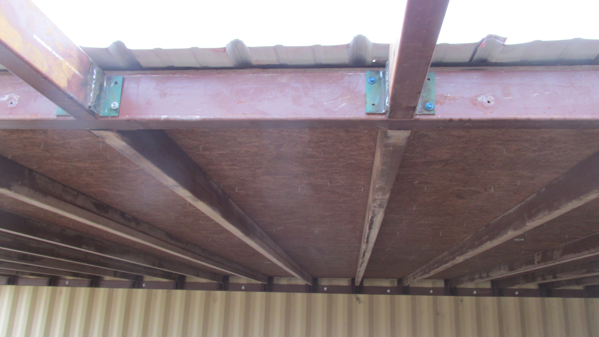

Additional framing and some construction details.
How the new rafters are attached to the existing shed.
First attached with screws.
Then welded with E 6011 1/8 rod. Be advised, I am not a welder.

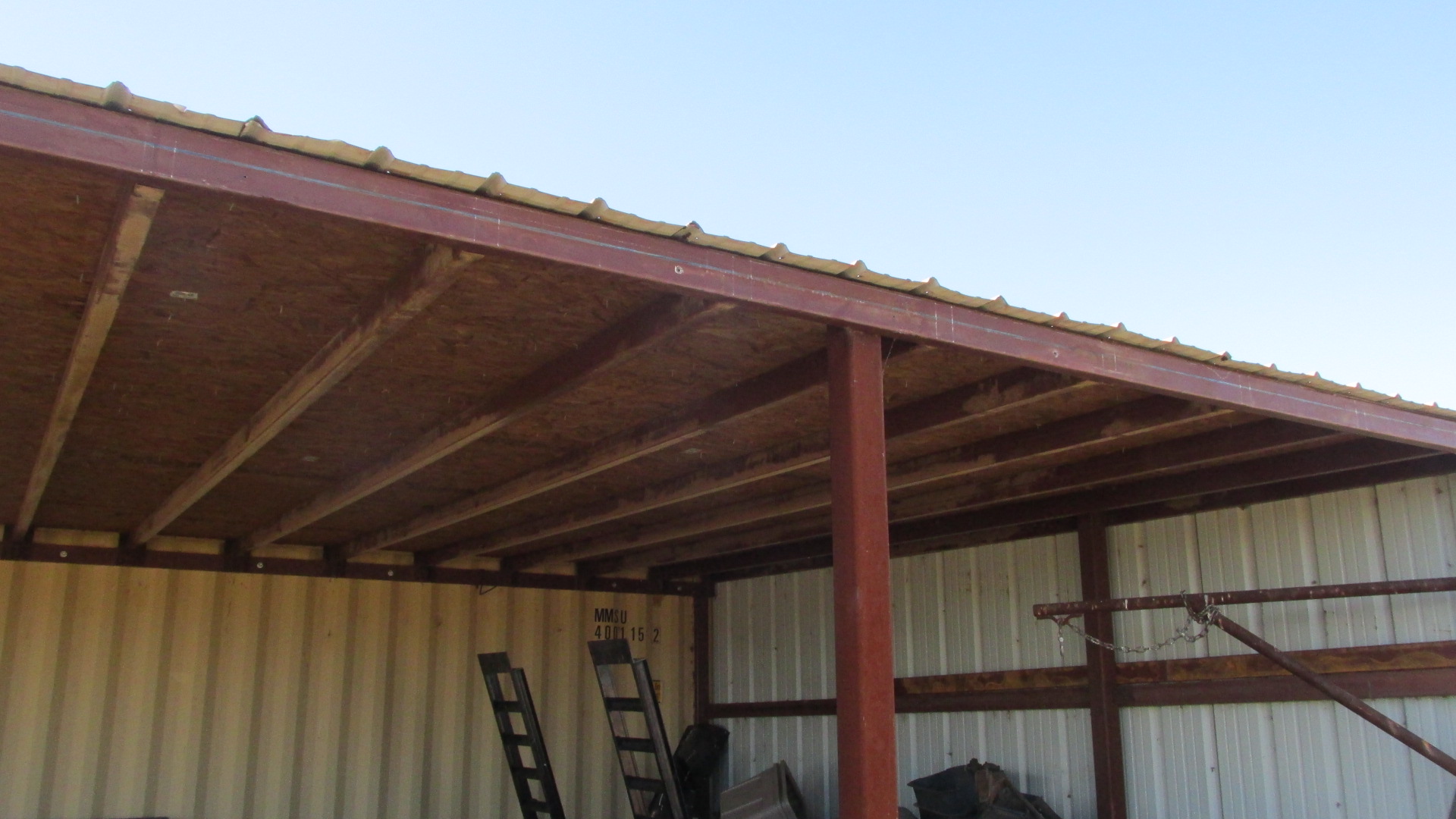

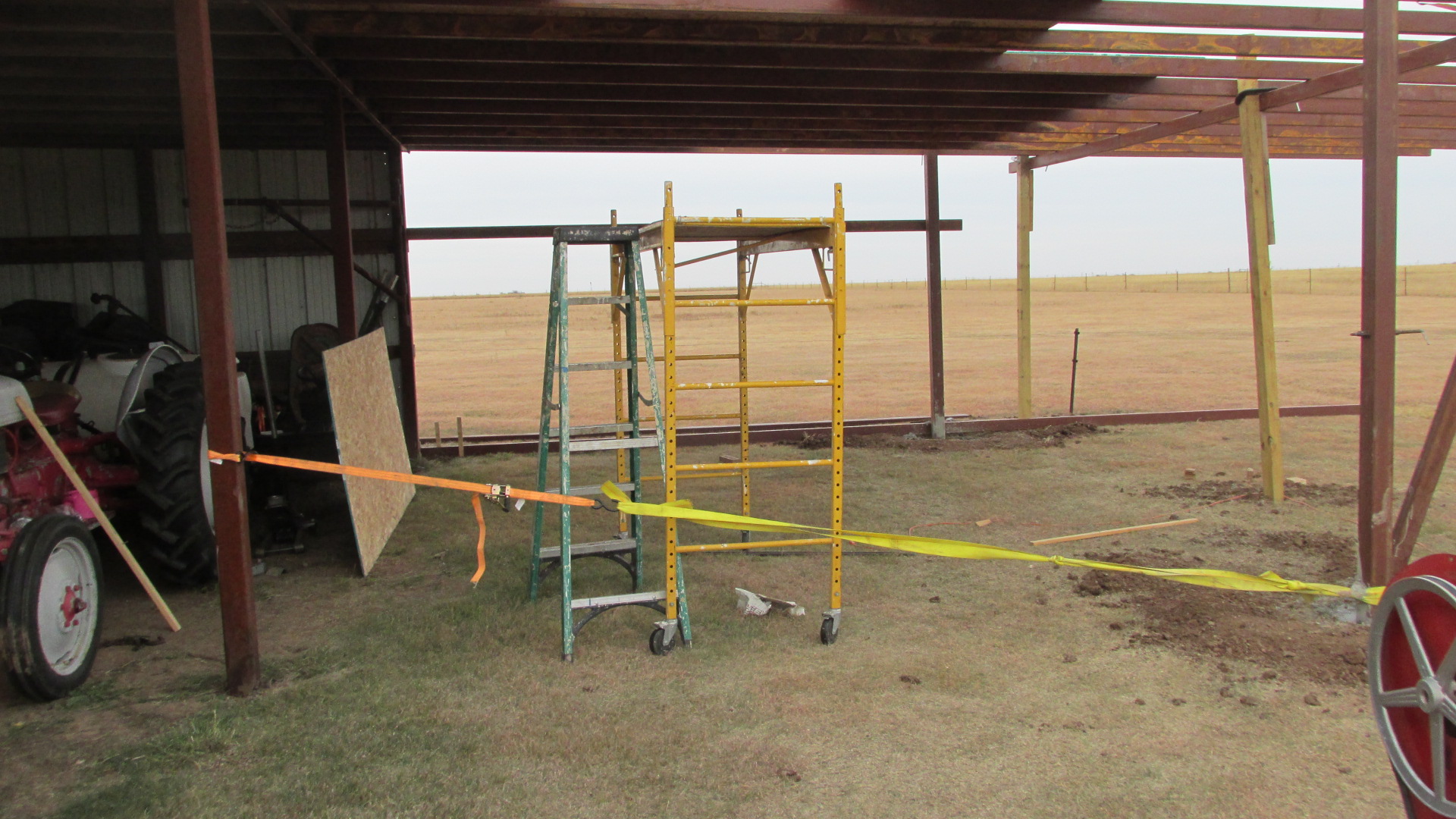

I started out with a 40' shipping container. I built a shed and it was attached to the container. That shed was 20'x40' To start this addition to the existing 20'x40' shed, I had to remove the TRIM on the existing shed, 2 nd picture.
Origional shed. I removed the blue trim.
When I get all finished it will have a total of 2000 Sq. ft and be fully enclosed with 2 overhead doors and 1 walkthrough.

How did you attach the rafters to the side of the container? Did you drill through it to attach bolts?
/ Equipment shed.
#20
Like this.
