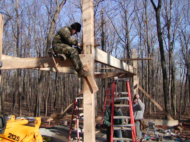

Wanted to post some shots of progress on the barn from the last week or two. This one shows some of the forms going in to support the beams- Bill the contractor used the BX22 to dig the holes, he was quite impressed!

Here's one of Bill cutting a form, looking back from what will be the door of the barn- shop is on the right.

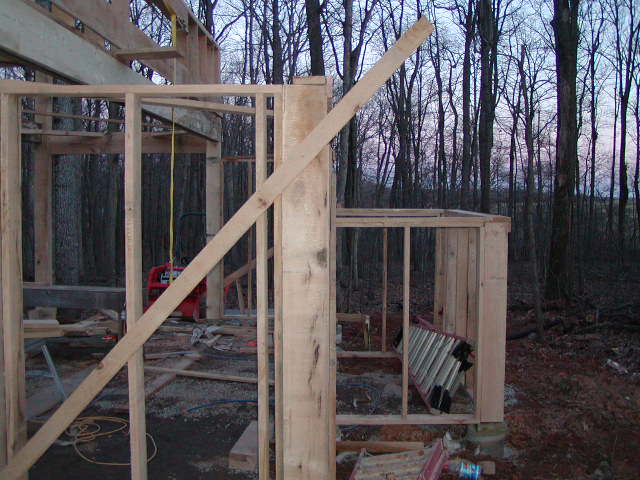

Here's one of the notching in one of the main oak beams.

Last one for today. Standing by the shop looking in to the barn. These are some of the main posts that will be put in place tomorrow morning. The posts will be set on a piece of pressure treated 2X that is on top of the concrete footing. A piece of rebar extends from the concrete, through the pressure treated wood and about 6" into a hole in the bottom of the post. The cross beams will be 2X12X24, pressure treated to fit in to the notches on the posts. The cross beams are at about the 8' level so I can drive underneath them with the ROPS up on the BX22.
Will post more later with progress.

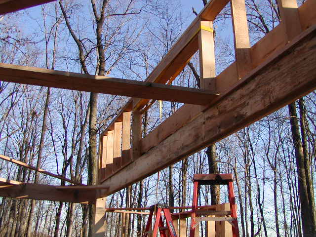

Here's a shot of the main posts and beams going up for the center section of the equipment barn.

Thatl's nice work. It's terrific to see a timber frame go up in the same way that barns were historicaly built. There's real pride of ownership in a structure like that.
Did you kiln dry or air dry your oak? Green oak structures are now quite common but I don't like the resultant splits in the wood that develop.

The wood is generally green, the posts have come mainly from logs that have been down for 5-8 years but because of their size, are still green. I know we'll have some splits, etc. because of this but in the end, I don't want to forget it's an equipment barn!
I hope to have the same builder put up a gazebo this fall and planning to handle the wood for that project differently. We're toying with the idea of putting up a solar kiln this spring and could then dry most of the wood that way for more finished projects and for some furniture, etc. I'd like to do next winter.
Just as a reminder, I'm not doing this work myself but I am trying to document it- I provide the funding and some tools, the mill, etc. but the guy doing the barn seems to be enjoying the work. I sneak out and watch (help?) when I can and have learned a bit about cutting logs but the work is theirs. Bill has some help this week and part of the reason they're helping is because they get a chance to do some timber frame construction which they all enjoy. I looked through a photo album of work they have done and some of it is amazing- one arched roof for a single family house was a work of art.
I'd also say that they're using modified timber framing practices in that they're using modern bolts to hold this one together rather than wooden pegs, really couldn't justify that much labor time for a barn although it would have looked impressive.

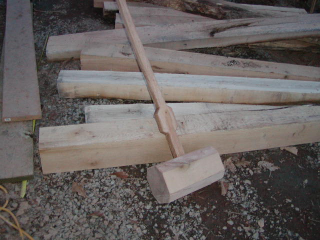

Here's a picture of a timber maul the guys made when they need to do some minor adjustments. Head is 8"X8"X12"!

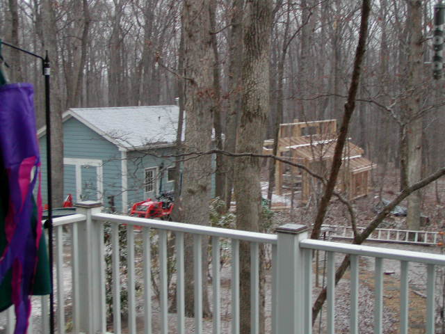

Here's a shot from the deck showing the barn structure about halfs completed. Have to built out the left side to match, then the upper structure, and then will be able to move to roofing/siding.
May lose a couple of days, calling for 6-10" of snow here today through tomorrow morning so Monday might be a bit of a challenge to get any progress.

A wider perspective to show where the barn sits in relation to the shop.

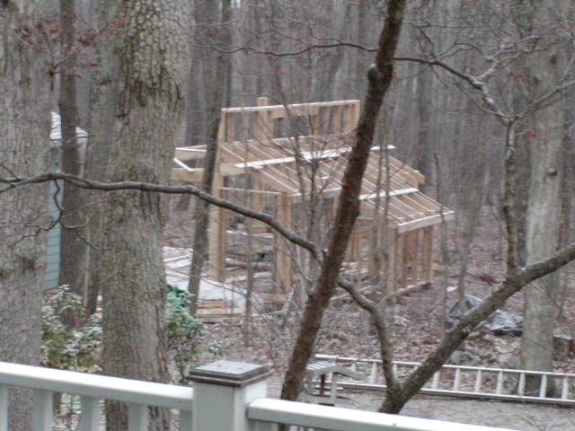

Still moving along slowly- framing is all up and starting the decking for the roof. Probably will have to mill a couple of more logs to have enough to finish the decking, plan is to do that this week. One new picture attached.
