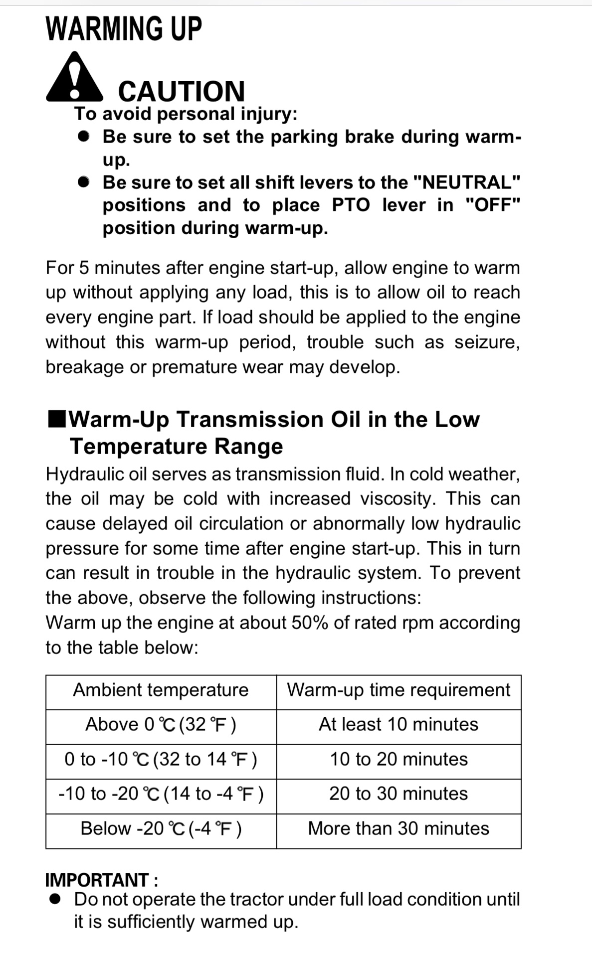

I don't strictly follow the manual's recommendations, but here they are for an L3301 (same as my L4060 and previous L3410) .
HST warmup is likely much more important in even moderate cold temps.
I find your chart very strange as my Kubota HSTC 4240 manual has a chart that starts at -10C (14 F) and a warm up time of approx 5 minutes, at -15C to -10C 5 to 10 minutes, and below -20C (-4 F) Kubota recommends more than 20 minutes in warmup time. There is no mention of idling as a part of warm up time, so I interpret warm up as a common sense approach of low power and light loads and not high power until after warmup criteria is met. I think the use of synthetic oils in extreme cold conditions also provides a huge advantage in rapid oil flow to critical parts.
