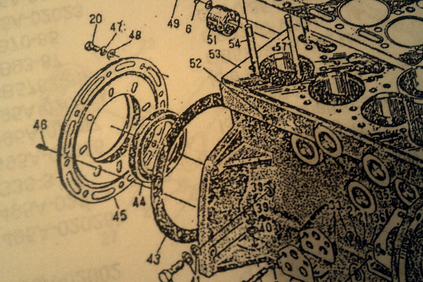

a pic of the rear seal of the Shanghai 495A engine block both an outer seal #43 and the actual crankshaft seal #44 assuming the 552 is the same as my 554 which i am not convinced yet
/ Engine oil pumping into hydrolics #46
Oil pushing from a bad rear main seal would also have to push past the transmission input shaft seal, all the while not leaking onto the ground from the clutch area. I'm just thinking several of the TBN sleuths would like to have 1 hour looking at this mystery tractor.🔎

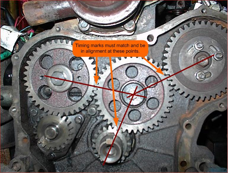

The small gear on the left drives the hydraulic pump via the big idler above it. It rotates at engine speed on a sleeve bearing. It has a stub shaft with a seal that connects to the pump shaft, so engine oil will not migrate to the hydraulics. Virtually impossible. Yeah, I know we're discussing the transmission.
Sorry haven’t had a chance to mess with it until today. Clutch is dry . I know
The tractor had been sitting for a few years befor I bought it. Could it have drank that much oil? I do not see anyway oil could get to trans. But trans is way over full. So idk. Can hydro get into the trans in the rear of the tractor somehow. I unplugged all the hydra lines going to fill the oil and run it again when I can and see what happens.

In pic two of four the forward pump is the one that on my tractor runs the FEL and power beyond for my rear remotes and grapple. The top of that pump is the inlet and pulls oil from the main transmission rear axle sump. the bottom of that pump is the hi pressure output, and like mine in your picture No relief is in that circuit.
The rear pump that is mounted right behind the front housing on the same axis as the pump mentioned above is a constant pressure pump for your power steering. The first pic with the small round tank on the left side of the tractor just under the fuel tank behind the engine starter is the Power steering fluid reservoir. It does not power anything else. from the pictures your tractor has one of the other power steering systems it is different from what mine looks like.
There is also a 3rd pump in the transmission sump on my tractor and probably yours- It powers the 3 point.
