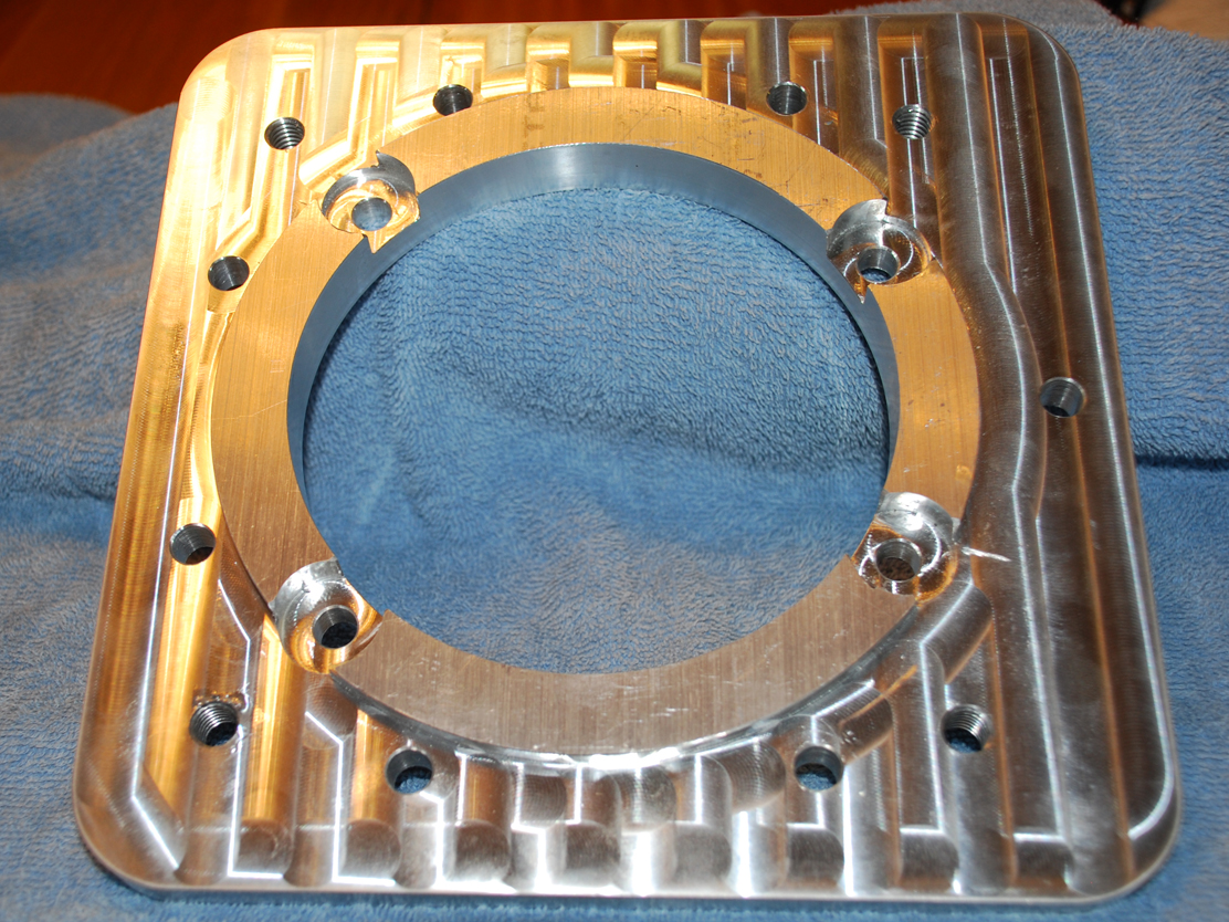

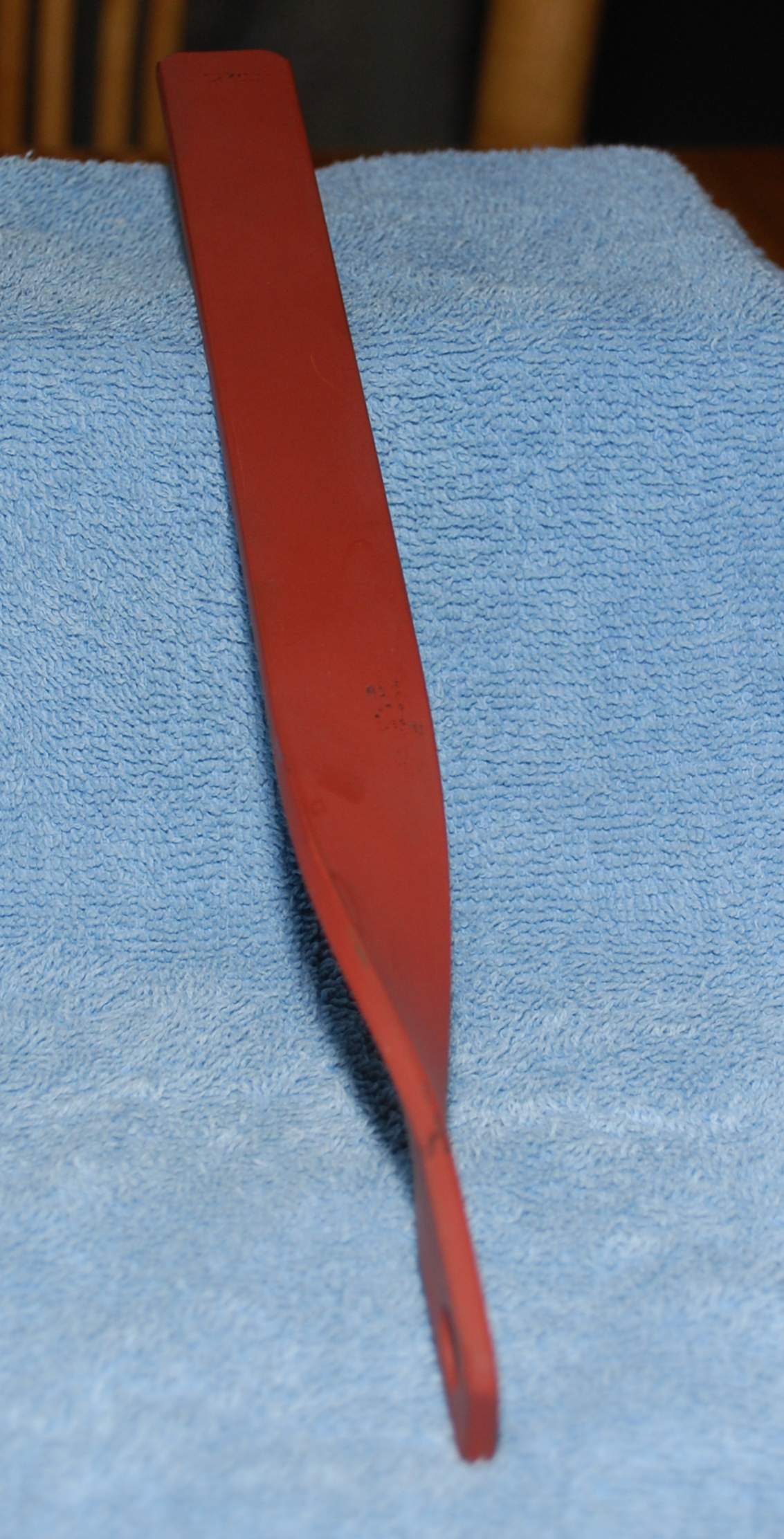

So here is a list for the Model L, C tractor Re power kit
1 ea CR11545 seal 2 X 1.75 X 1/4 $8.00
1 ea The Gear is part # GR 045 $150.00
1 ea pilot bushing is # GR 054 $20.00
1 ea. spacer plate is # GR 049 $125.00
1 ea Alum Re power Plate is # GR001 $60.00
Or Redrill your Kohler adapter for $5.00
6 ea 5/16 X 18 X 2. inch long set screws $.00
1 ea. 3/8 X 16 X 2. long hex bolt and nut $.00
1 ea 3/8 X 24 X 1 1/2 long Allen cap screw $.00
6 ea. 3/8 X 16 fiber lock nuts $.00
6 ea. 3/8 washers $.00
Shipping $15.00
Total
So ck the engine you want so I can send the right screw.
What Hp engine do you plan to use they have to have a 1 inch dia crank shaft?
This is for the Honda engines or clones with 3.3/4 long cranks.
I am making up some brackets 1 X 3/16 X about 12'' long at $10.00 ea extra
2 can be used to bolt the handle bars on to the Re power plate to trans
2 can go from the bottom axle bolt holes and back to the bottom of the engine
if you want all 4 it would be $40.00 extra
You will still need to get parts from a Gravely Dealer
15718 Engine to adapter spacer gasket
10732 adapter to Kohler adapter gasket.
12592 model L Engine chassis gasket (Kohler adapter to Transmission Gasket.)
Some people use ( RTV Blue Glue or gasket eliminator) instead of gaskets

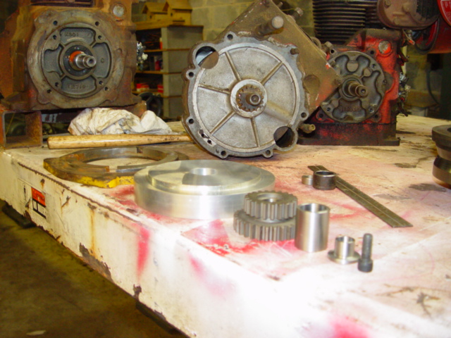

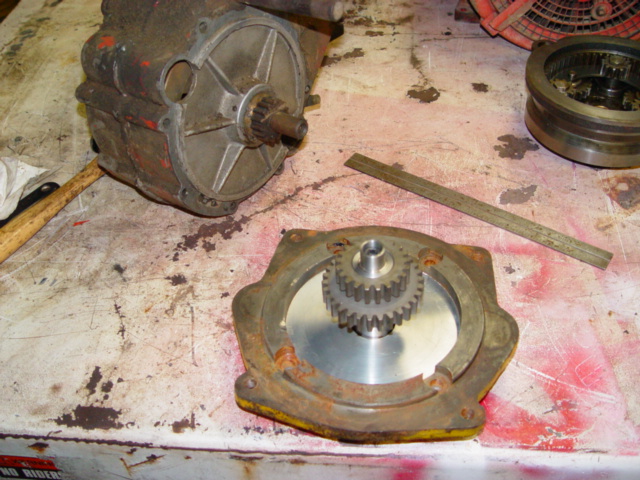

Well I was at harbor freight the other day and one of there new 420cc engines followed me home for $300 after the 20% :thumbsup:
So its going on my 5240, I like the smaller hood line of it verses the the larger hood of the L8 when I'm working with it(brush hogging) I'll keep the L8 for a bit of a restore job (ok just a paint job :laughing:)
Now now I'm cheap as ****, I'm thinking what was the shaft length of the kohler engine when mounted to the stock adapter plate? I know the shaft diameter is .75" or .875" I can take that to work and bore it to 1" and deepen the keyway.
Now if the length from the end of the stock shaft to the adapter plate isn't that short I can pull the crank from the new engine turn it down to length and mill the keyway a little longer.
So I would only need to get the pilot bushing. Cause my local gravely dealer doesn't take any prisoners. $66 for a shipper shaft :confused2:
/ Engine ideas #399

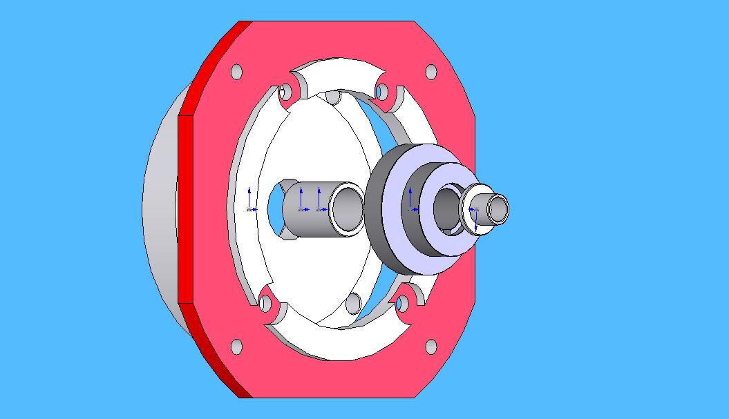

so all you will need is the plot bushing
and cut out or use flanges for the muffler.
Here is a print of the pilot bushing
Before you cut the crank you may
need to drill it deeper and tap it deeper.
With the tools you have you can do it all.
Here is also a print for the aluminum spacer.
so you won't have to cut the crank.
  • 004 PILOT BUSHING 13 HONDA 2 W HEEL R.pdf
  • 100 EXHAUST FLANGE HONDA.PDF
  • 008 C10A 500 ADAPTER SPACER 1.125 0.PDF 008 C10A 500 ADAPTER SPACER 1.pdf
  • 101 EXHAUST FLANGE HONDA.PDF
/ Engine ideas #400
Thanks gravelymay! you are the man! :thumbsup:
I think I might actually have some drops of 4130 I can turn the pilot bushing out of. Dont know if I have anything to make the spacer with in aluminum but I do have a stack of 10" diameter 2" thick drops from the center of some pipe flange we did on the plasma table I was going to make some indestructible spinner for my range but I can stand to have a couple less targets :D.
