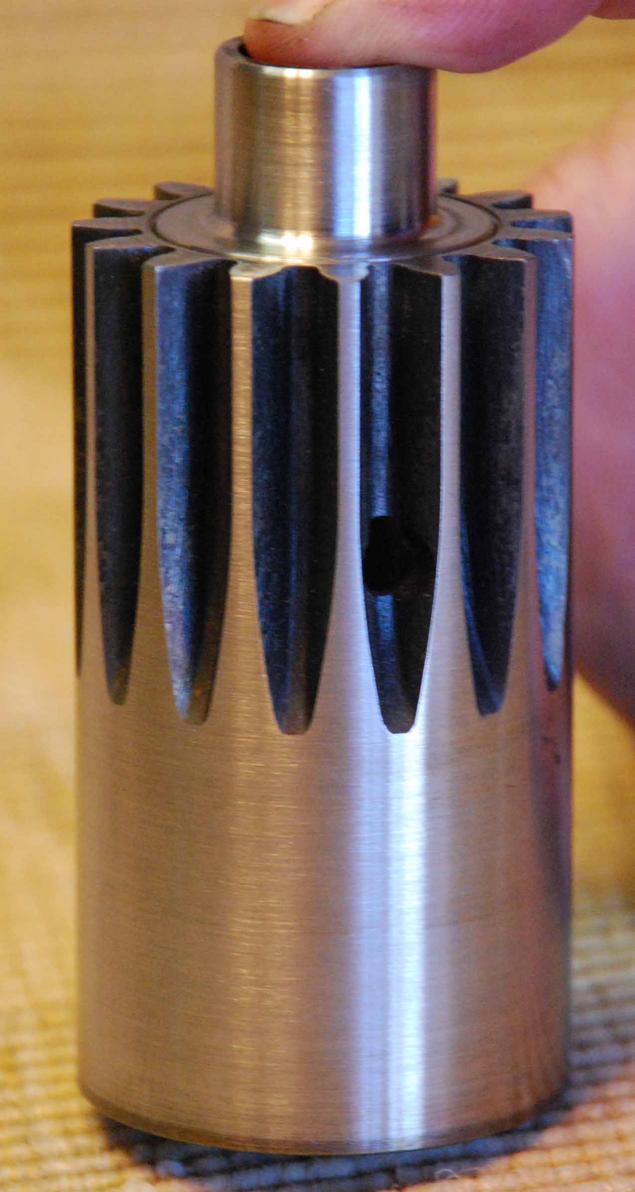

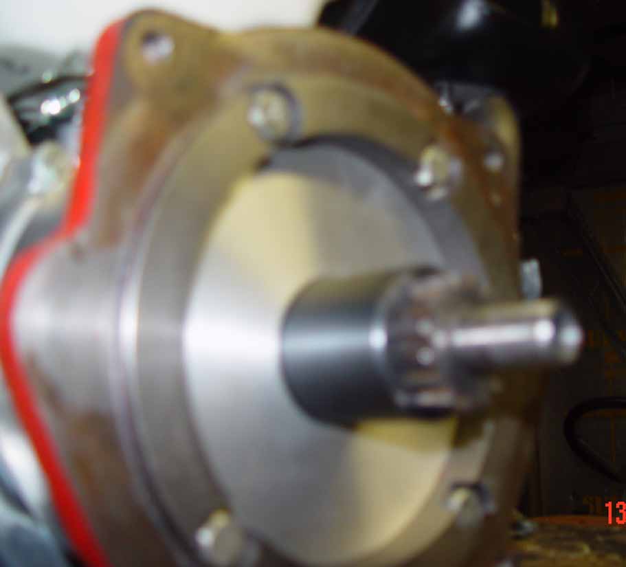

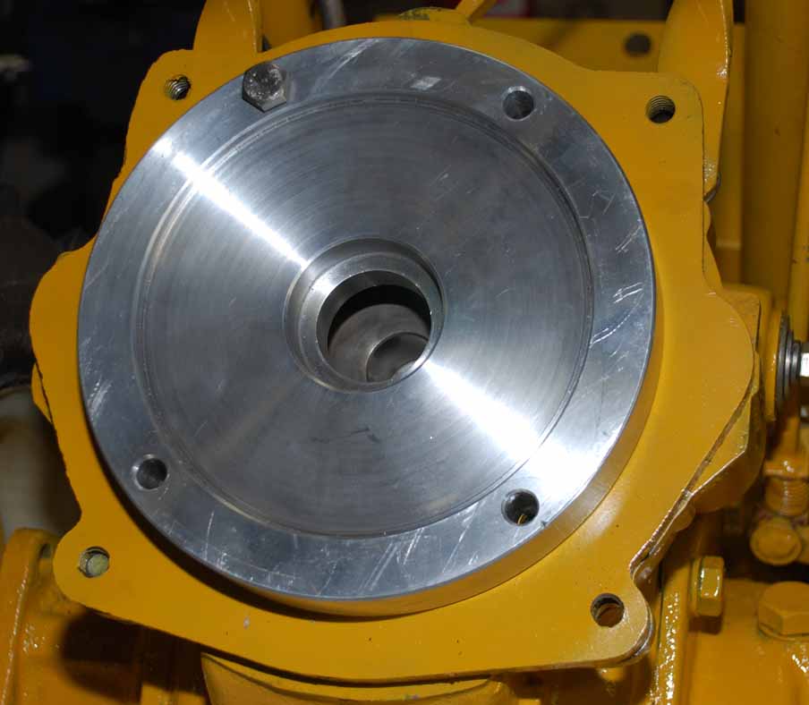

The crank has to be 1 inch Dia.
The length can be set by using the right adapter spacer.
The first pic is parts to repower
Second one is a old picture to see lay out
third is the new gear I had made to replace the Input gear from the old gravely engine and the Kohler C10 models
The 4 th picture is a adapter plate on a C10 transmission
What I am doing is redrilling a Kohler plate to fit the old C8 and the model L transmission
Then we can add the spacer plate
