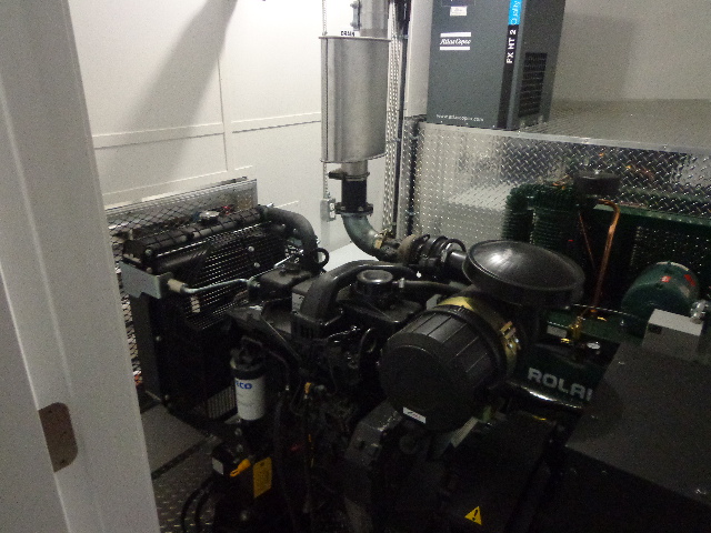

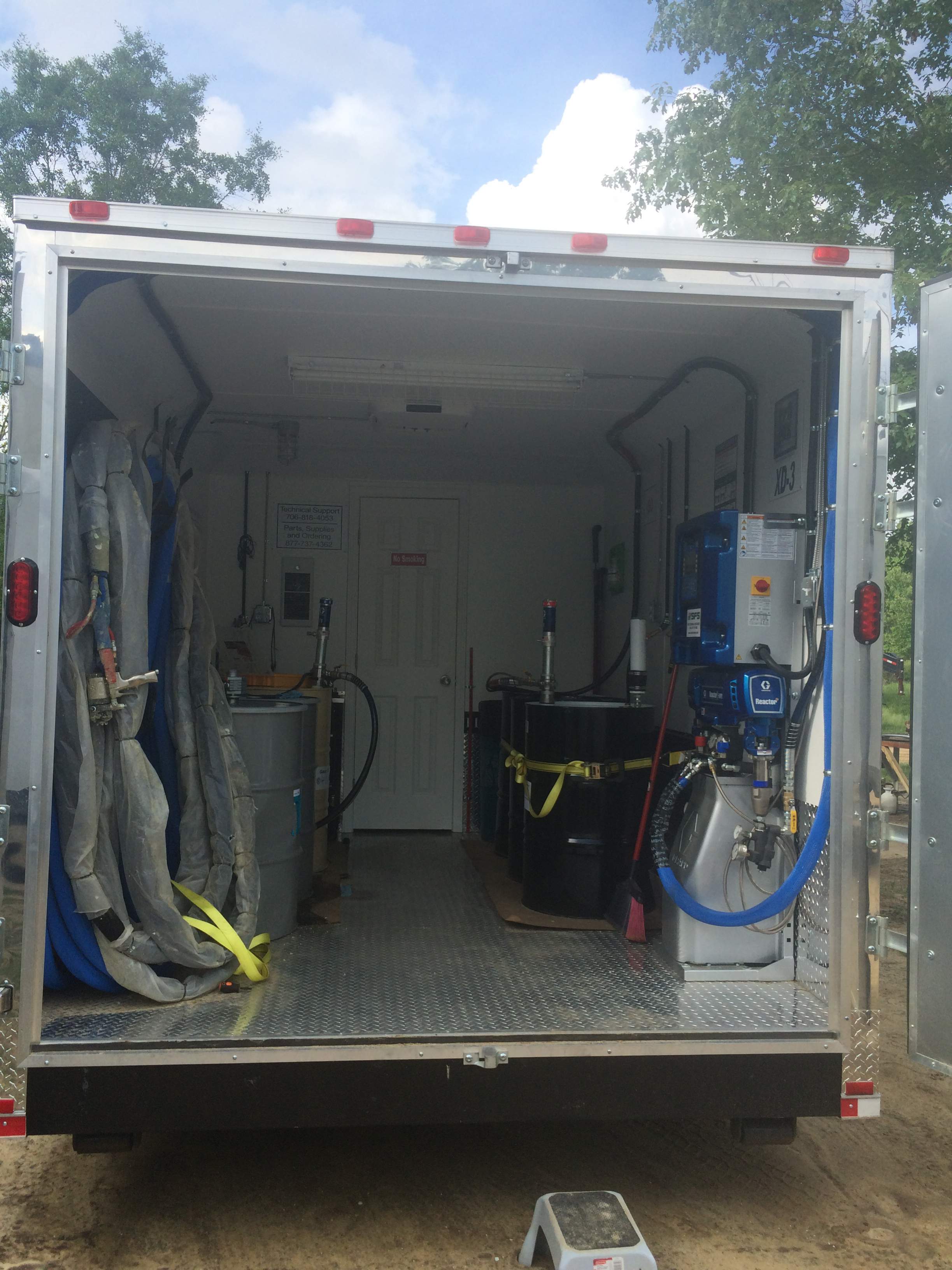

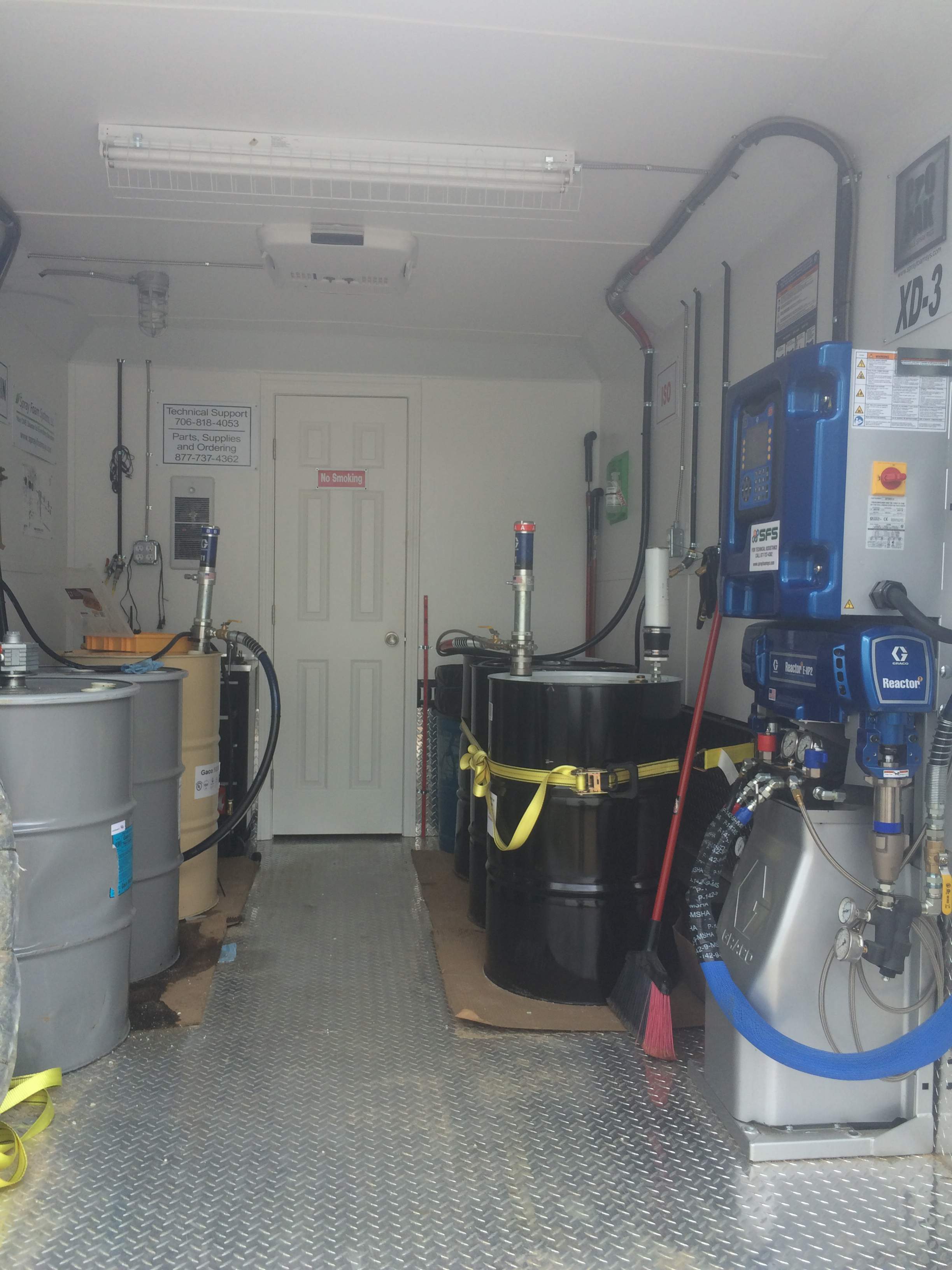

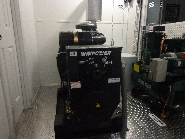

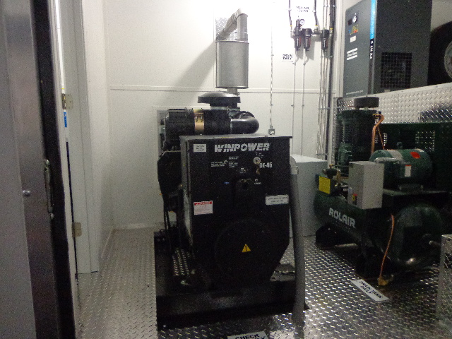

Sorry, it's been a long day. We sprayed it with commercial spray foam equipment. The pictures I posted earlier (8 x 28 enclosed trailer) is our new commercial spray foam rig. I guess it's hard to know what's inside unless your familar with foam. We plan to have the trailer warped, but just have stopped to have it done yet. We can spray both open and closed cell foam along with polyurea's.
The system is completely self-contained inside the trailer. I have added a few pictures of the inside and the equipment.
Back half.
Reactor, Pumps, Hoses.
Front Half. Diesel Generator
Compressor, Dryer,
