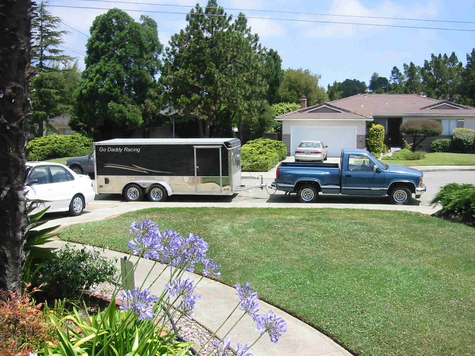

I bought a 7 x 16 Pace used and no complaints... the floor is sturdy, I have D ring tie downs and the ramp is very convenient...
Over the last 6 years my only repair has been to replace one row of ramp hinge screws.
Only other issue is the molded ABS? where the front meets the roof does have a few cracks that I covered with black tape.
I had looked a real nice... read expensive trailers that were 4 to 5 times what I paid.

I bought a 7 x 16 Pace used and no complaints... the floor is sturdy, I have D ring tie downs and the ramp is very convenient... Over the last 6 years my only repair has been to replace one row of ramp hinge screws. Only other issue is the molded ABS? where the front meets the roof does have a few cracks that I covered with black tape. I had looked a real nice... read expensive trailers that were 4 to 5 times what I paid.
That's a good looking trailer! That's kinda what I'm looking for.
/ Enclosed trailers? #18
If i was to buy one today, it be a Neo All Aluminum. Got a Pace and wouldn't recommend it..
/ Enclosed trailers? #19
I think I got lucky... just about to give up when this one came along for $3200.
Had only been used for motorcycles... took out 6 Motorcycle Wheel Chocks so I'd have a clear floor.
The guy was going bigger and decided to sell.
The 7' size lets me see down the sides of the trailer with my truck mirrors... have also towed wider and didn't feel as comfortable to me.
My neighbor uses a 8 x 22 full height trailer for his business... seems like a monster to me... besides it would be too big for my 1/2 ton Silverado.

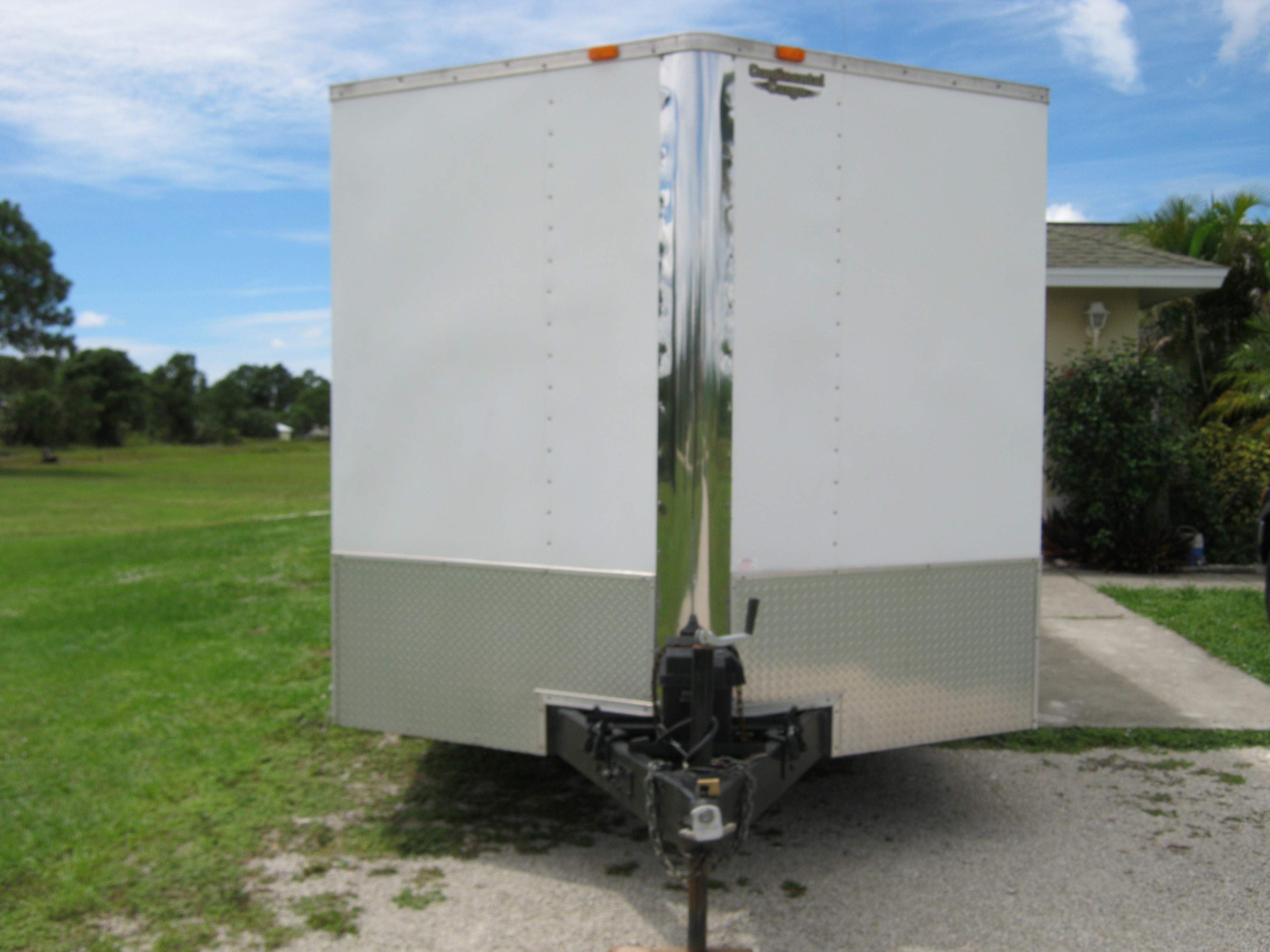

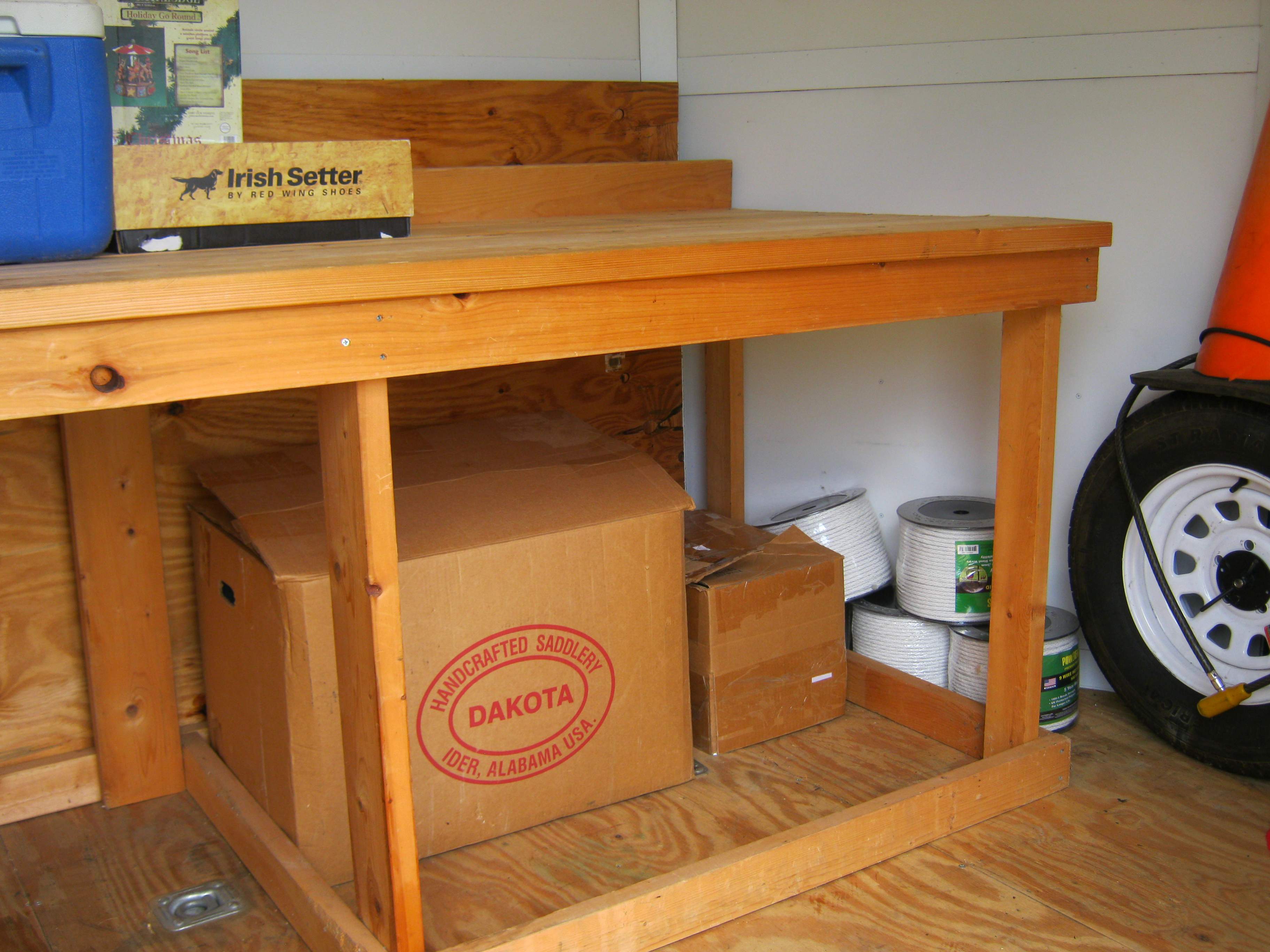

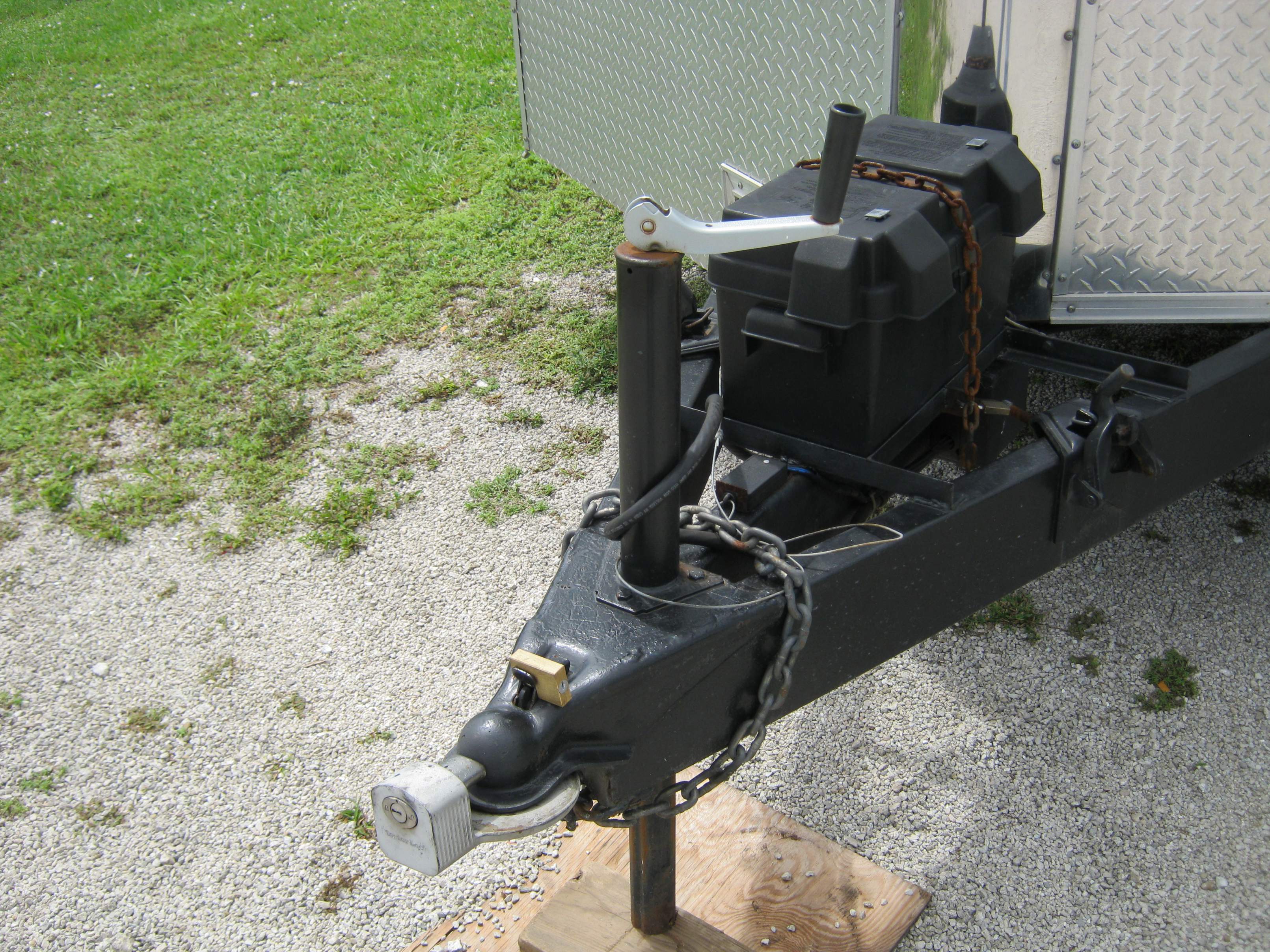

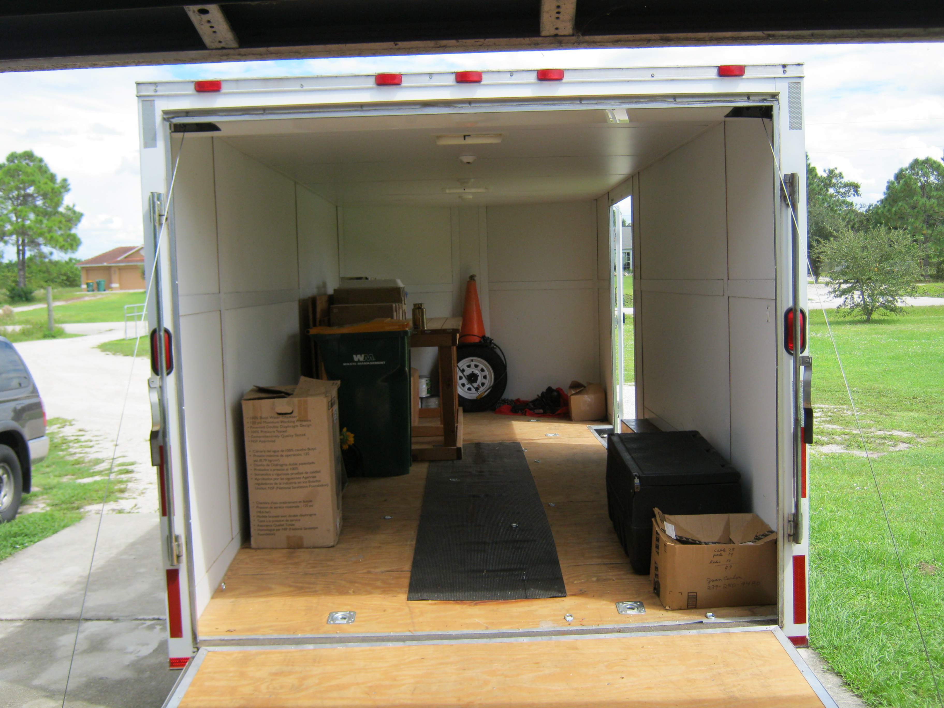

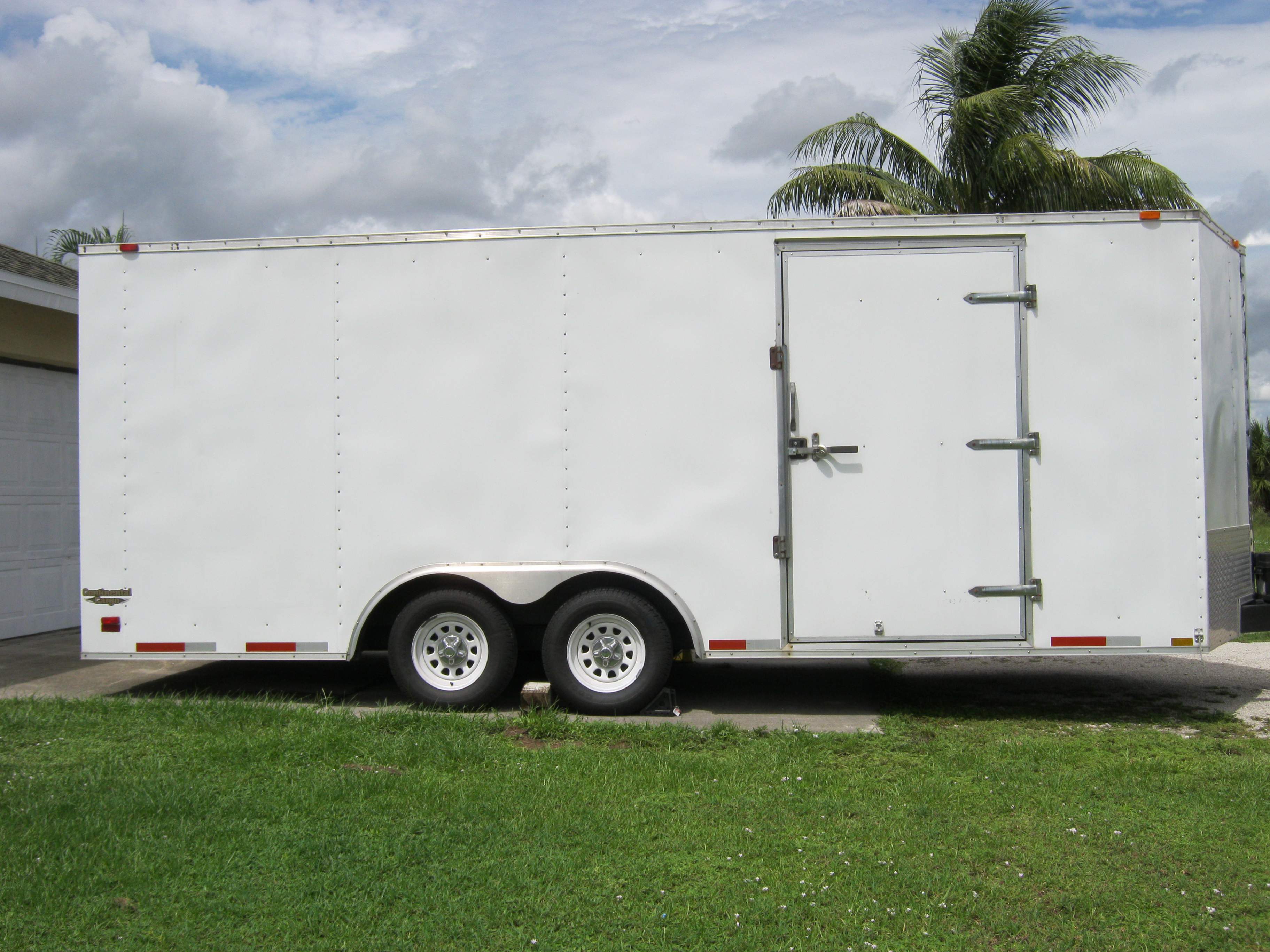

I'am not saying its the best ETC but heres my 2005 Continental car hauler , 20'x8' high and high enough to drive my Bota L3400 w/FEL into it.
I have tie downs in it, its paneled, 4 inner lights in /on roof, stabilizer bar and load levers, upgraded batt from small mini they come with to deep cycle marine, 4' side cargo door upgrade from 3' standard, 2 roof vents, no leaks . Been very pleased with this unit .
I pull it with my 2011 F250 4X4 Diesel (def) 6.7 . I currently have a workbench in it .
