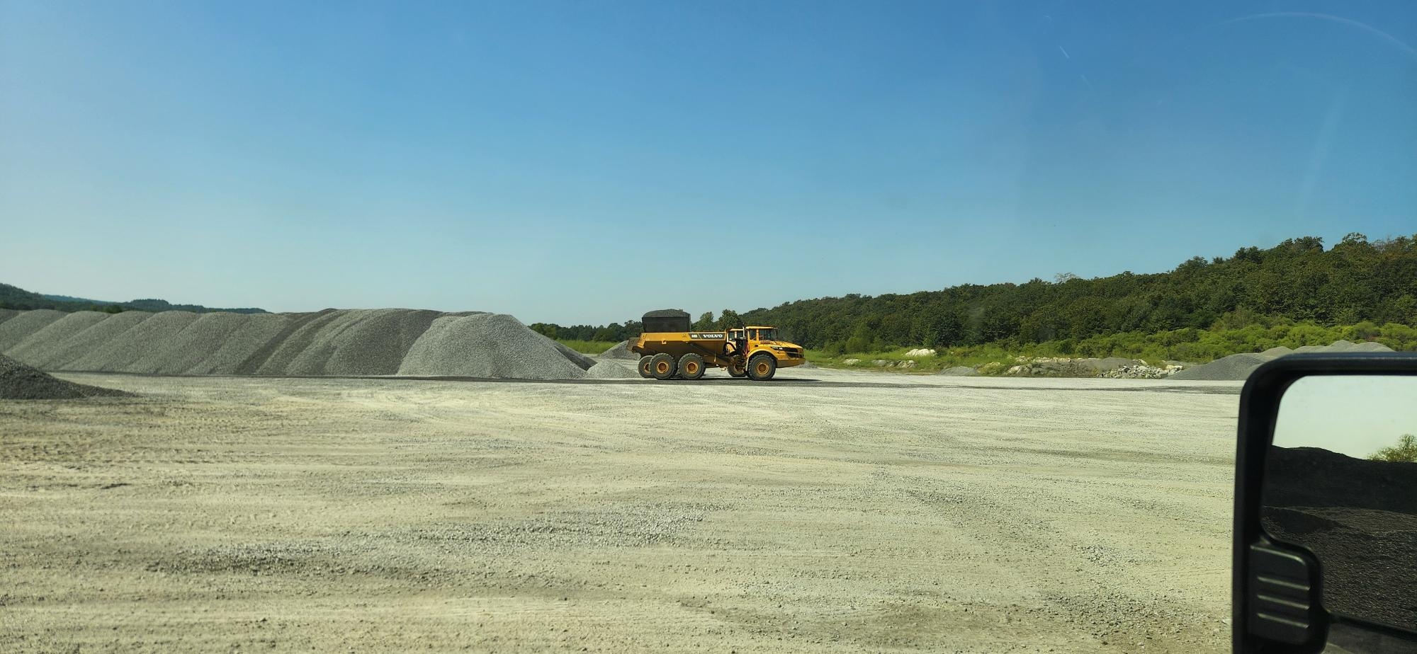

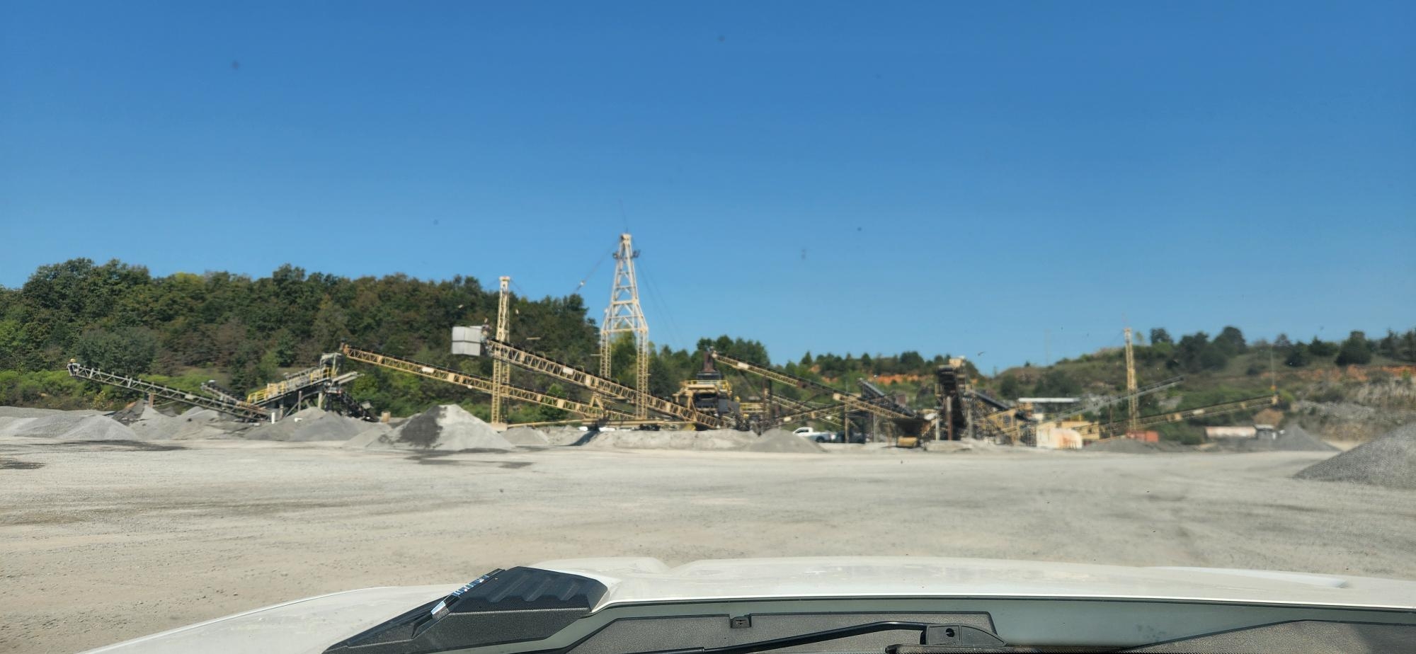

In case you are wondering, this is what a basically max GVWR load looked like this weekend on my little SRW truck. The whole thing weighed about 23,500 coming out of the scale house. 10K truck and 14K trailer. I absolutely would not want to pull much more than this with a single tire. My best guess for trailer weight is right around 15,000 lbs.
   / ton Ram-single vs dual wheel? #35

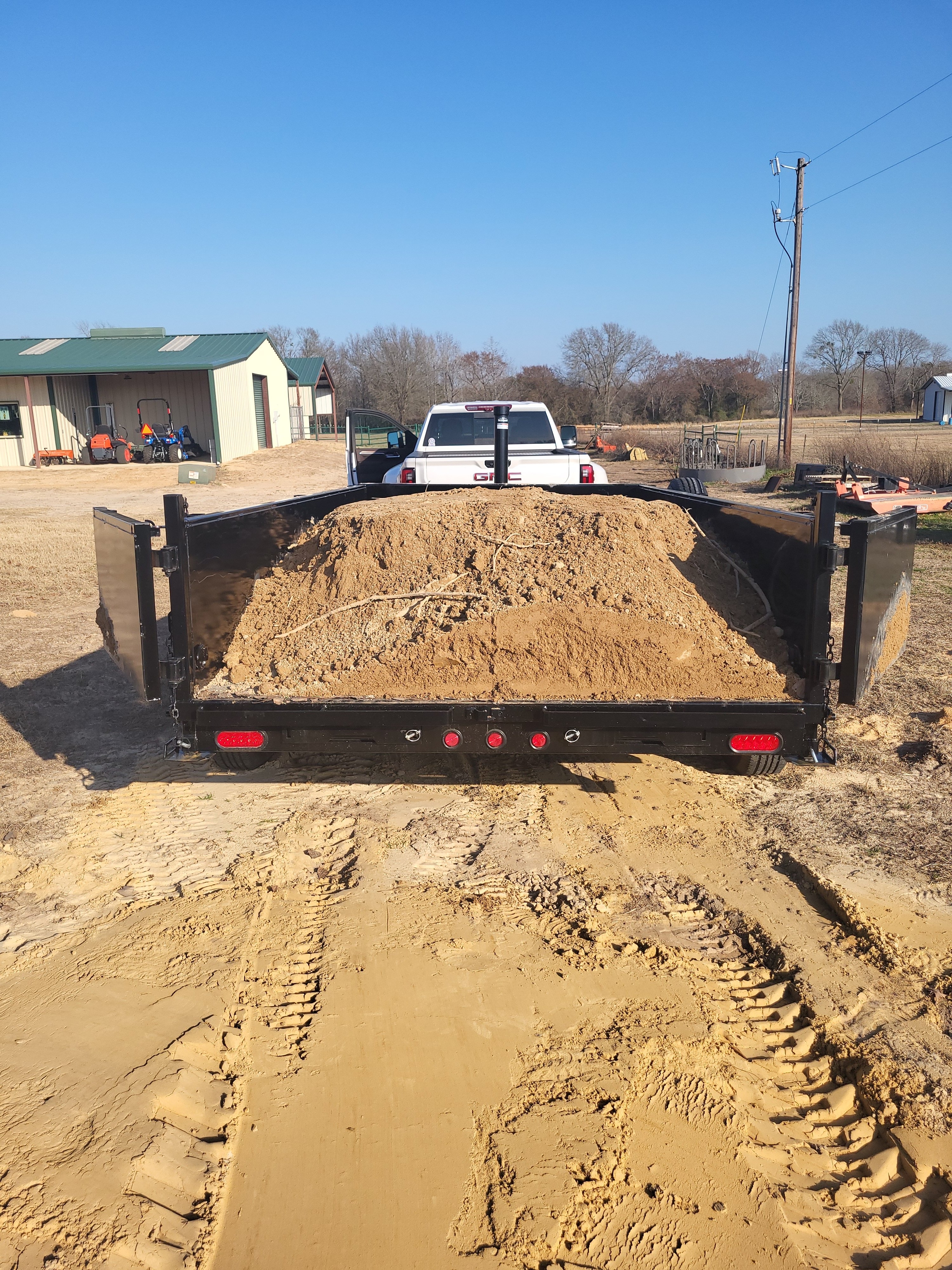

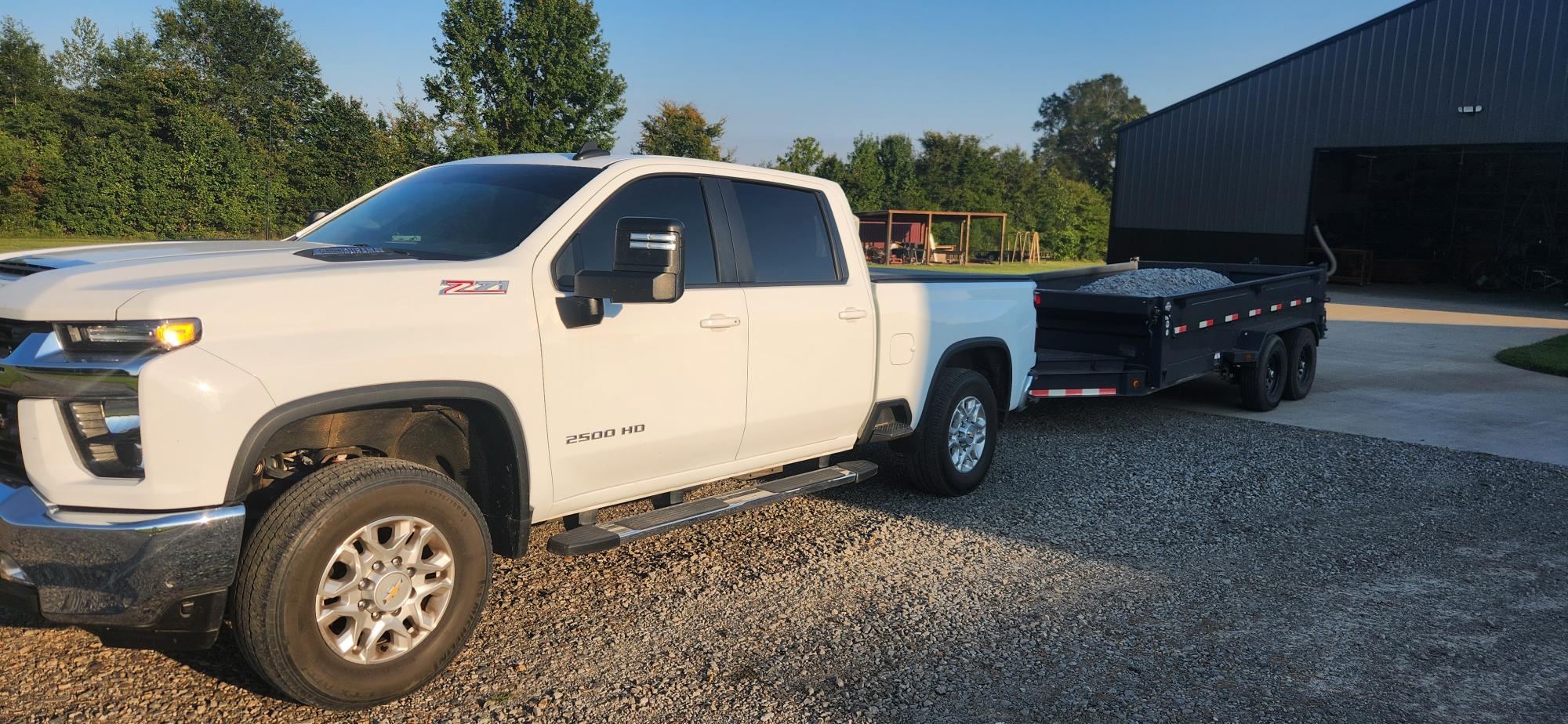

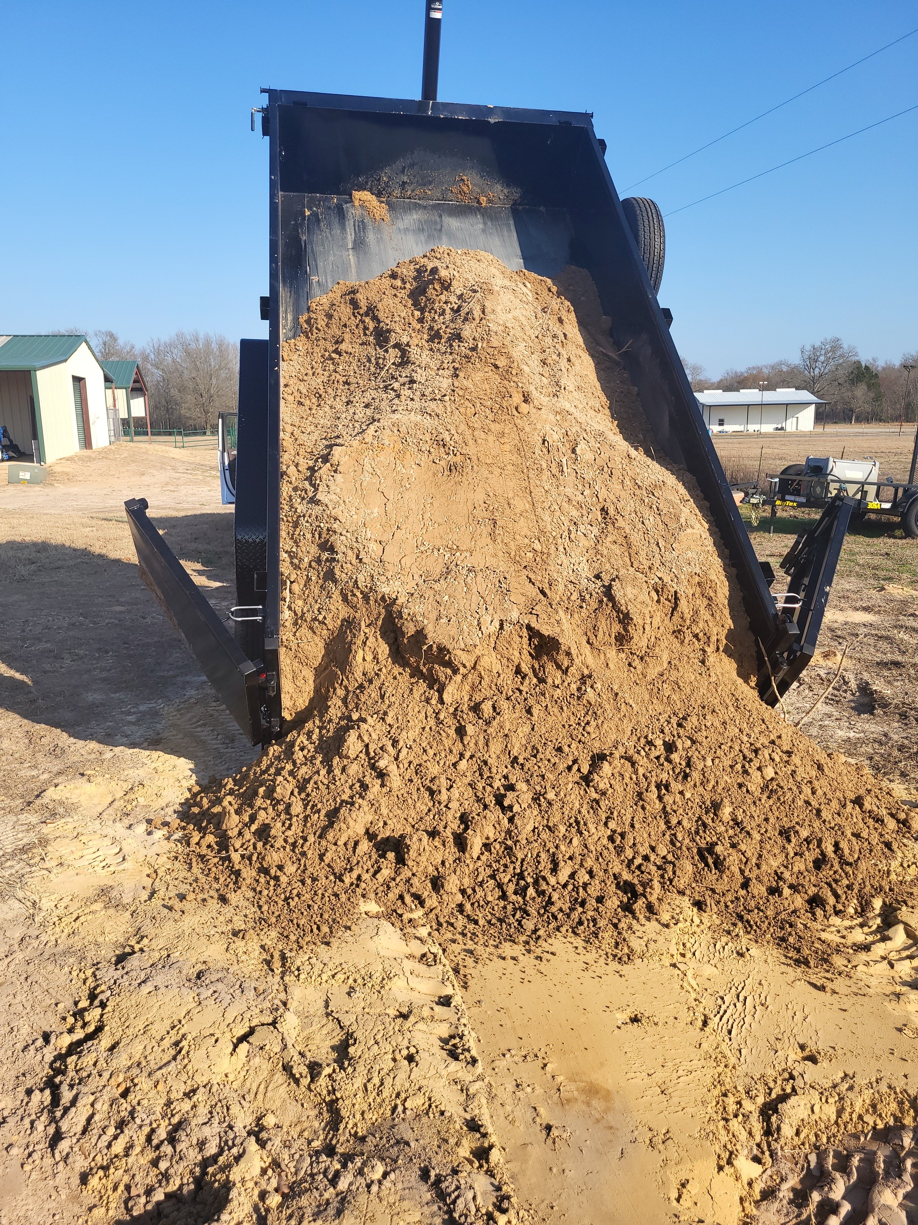

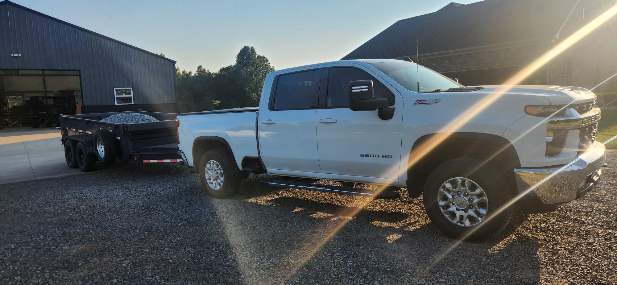

Yep, I know that feeling. That is why I switched from a 2500HD to a 3500HD DRW. I could have pulled all my trailers with the 2500HD, but I sure feel better with the 3500HD DRW. My wife said get what I needed to feel safe, so I did.
I try to limit my loads based on weight per yard to avoid going overweight. Means only hauling 4 yards of recycled asphalt or rock at 2600# per yard, instead of 6 yards which easily fits. Even 6 yards of topsoil at 2000# per yard dry, which fits fine in the trailer, puts me just over the limit of 11,250# that is the trailer cargo load limit. The new ram lift trailer handles it, no problem. I also switched to G rated tires on the trailer for extra security.
