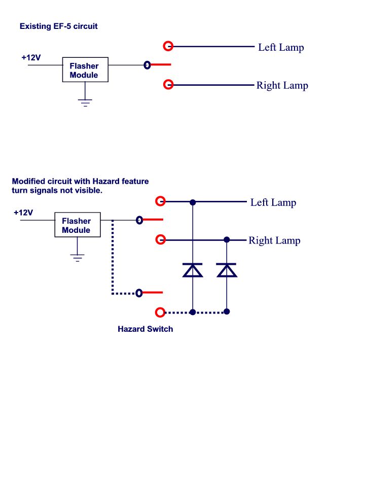

Mark, Finally finished diagramming the flashers. (I have to admit that the Kubota schematics are a bit wierd/w3tcompact/icons/crazy.gif )
OK, this first attachment has your original circuit as I understand it and below that a simple flasher circuit that overrides the turns signals. The diodes for this type of arrangment can be something like a Radio Shack 276-1185 full wave bridge rectifier (but you only use 3 of the four terminals and can use standard crimp- on connectors /w3tcompact/icons/smile.gif ). Either of these circuits are pretty simple - but wait till you see the next message "Kubota Style".

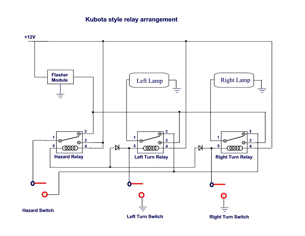

OK, now things get really strange./w3tcompact/icons/eyes.gif The attached is the Kubota method of providing turn signals and flashers.
When no turn signal is present, engaging the hazard switch causes the flasher module output to go through the normally closed contacts of the relays and flash both turn lamps. So far so good.
Now when you engage a turn signal normally (no hazards) the related relay closes and the lamp draws on the flasher module.
When both the hazard and the turn signal are engaged: the active turn signal remains connected to the flasher module output, while the inactive turn signal switches from the flasher module output to +12VDC (on but with very brief blinks when switching)./w3tcompact/icons/tongue.gif Trust me - this diagram is far simpler then the factory schematic./w3tcompact/icons/eyes.gif
Words of caution - I found the same relay I brought from my dealer for about 1/4 the cost in the Radio Shack catalog. ARGGHH! /w3tcompact/icons/blush.gif The only thing you may want to add is a fourth relay on the output of the flasher module so you don't have to worry about loading, though I suspect that won't be too much of an issue with the LED lamps./w3tcompact/icons/cool.gif

Ok, I think I pretty much understand what's going on as you diagrammed it. (You went to a lot of trouble to do that - thanks!) So are all those relays actually in the Kubota flasher? Or is the schematic's depiction of a flasher with 7 terminals just a misleading grouping of the flasher and the associated relays? And, if the flasher really is just an ordinary flasher and doesn't have 7 terminals, why do they want 50 bucks for it? (That last question is rhetorical, of course - at least as far as you're concerned....) Strange.

Near as I can tell from my schematic (for the L3710) they are separate relays (and they show separate plugs for each). One of these days I will pull the shroud off of the instrument panel and take some pictures. The hazard unit (flash module) looks like a 3 pin device. Now if they were to combine a flasher and a relay - it would logically be about 7 pins... go figure.
