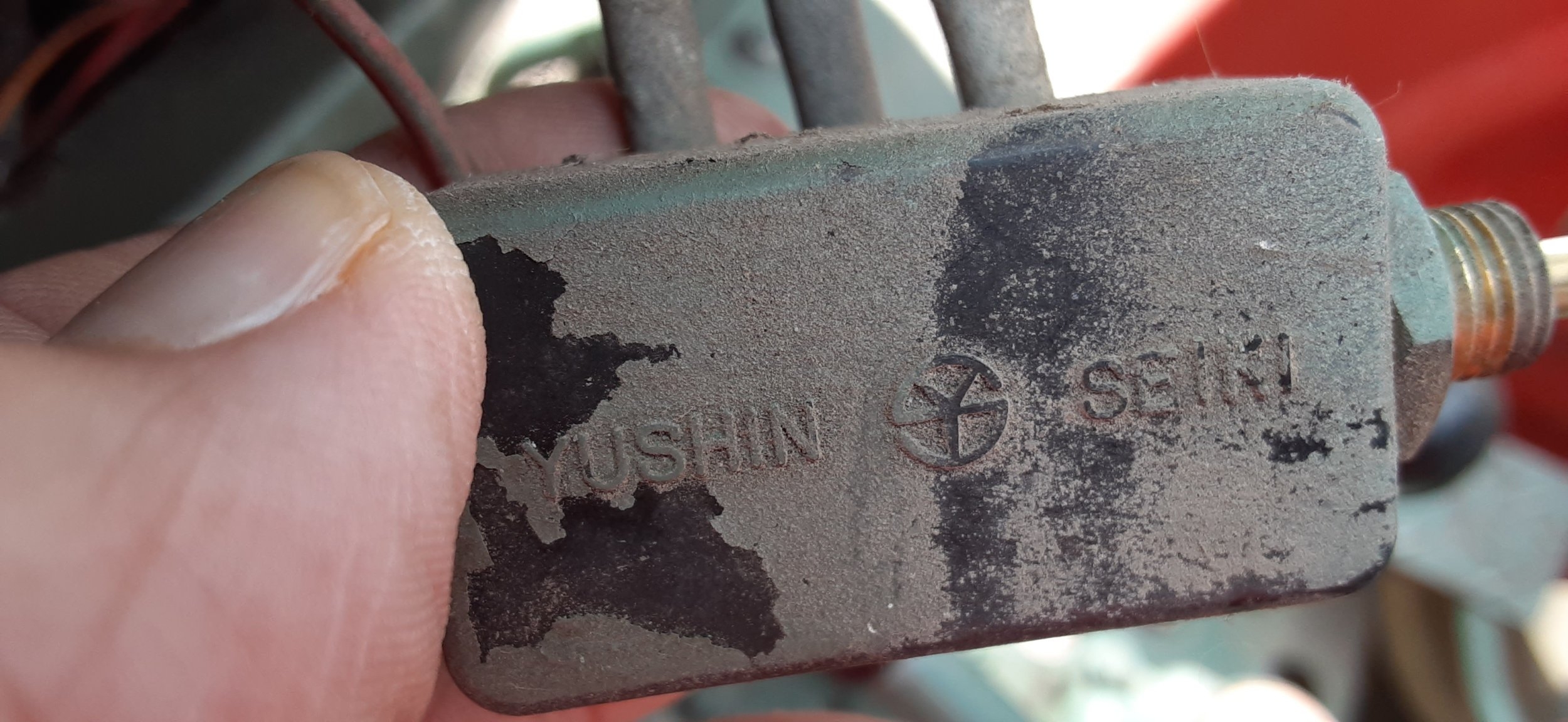

The last item to deal with was the switch. The machine was made in 1981. It had late 1970s technology. I was expecting the worse to order a new switch, if I could find one. Took the access panel off, undid the set screw and took the knob off.
The taller and most middle wire supplies power coming from the fuse box.
The other two white terminals are for low and high beam. Sort of cheesy for old tech. It makes the connector just up behind the headlamps a 6-terminal.
The wire with the black terminal and red wire supplies a lamp to illuminate the tach-hour meter.
The tach-hour meter bulb must of been original with the machine. Still works. Just lots of crud nearly making it black over the bulb. Took a few shots of CRC electronics cleaners and a towel to scrub all the grim off.
The Yushin-Seki switch.
Here it is all buggered up inside,
Can't use harsh cleaners either. The trace board is phenolic. The CDC product is made for this material.
Retested and it worked. The machine has lights again.

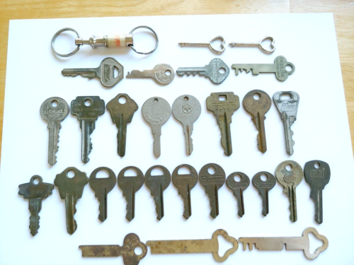

If a person looks at Yushin-Seki over the 50, 60, 70, 80 eras, they made mostly motorcycle electrical parts. Many of the Japan tractor companies used those electrical parts too.
Its possible the Yanmar and Deere tractor keys were made by them as well.

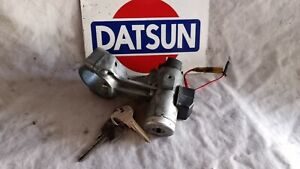

Yushin-Seki made all of the Shibaura (Ford) tractor keys and ignition switches. Likewise for Mitsubishi (Massey), etc.
And why for Yanmar would I take a guess, well, many of our tractor parts come from this Japan car company, ;)
Datsun 70-78 240z, 260z, 280z, OEM ignition switch and key.
And the Ford New Holland keys look very similar to the Yanmar Deere keys of back then.
My 2 keys from the JD850 and YM2610. Both work in every Yanmar and Deere I tried them in. lol

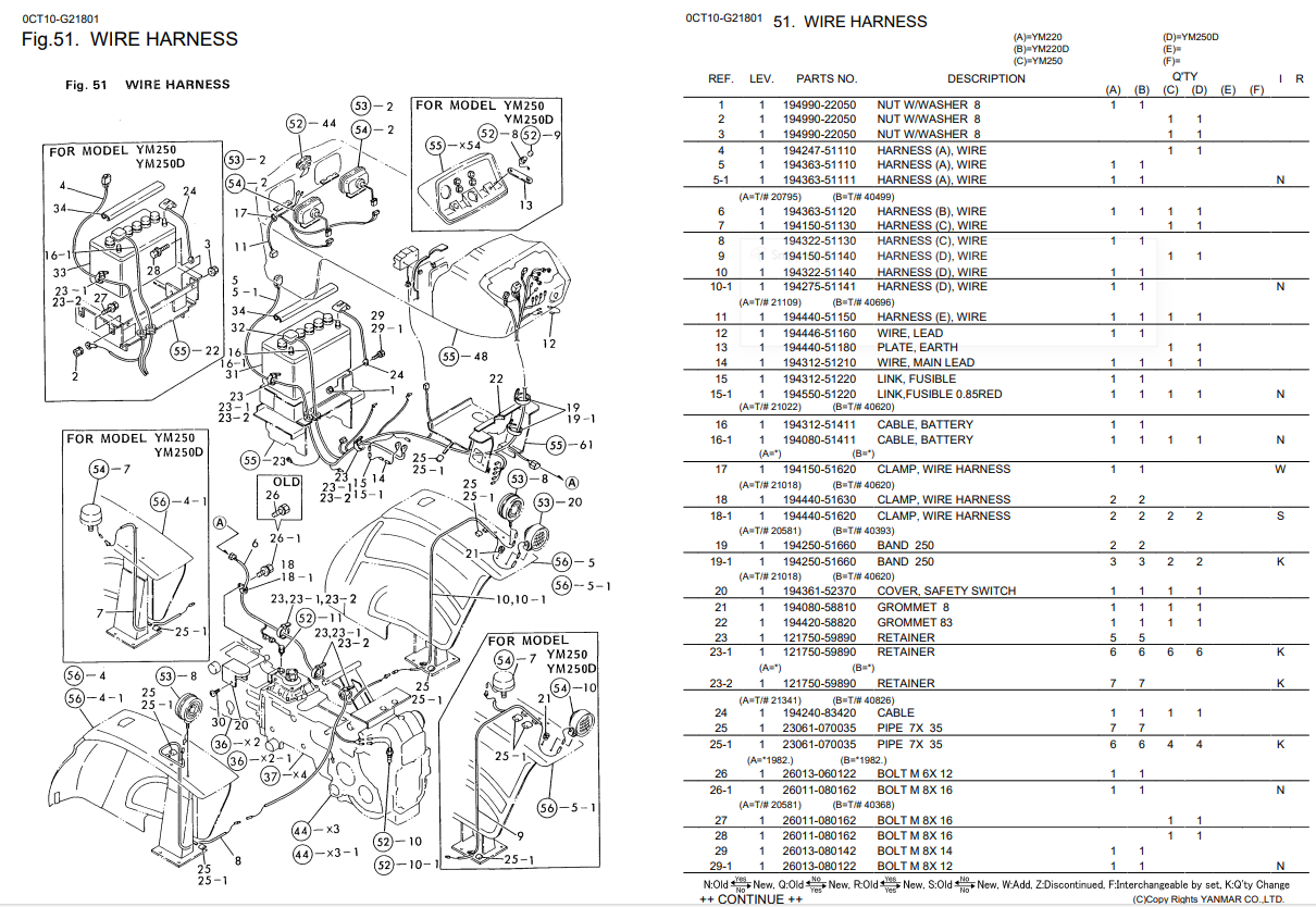

Knowing about the switch and how the wires attache, it's very possible now to add marker lights and parking lights to the rear of the tractor for roadway use. Already have the turn signals.
There is a YM250 model based off the YM220. The YM250 is the European version of the YM220. The YM250 has all of the roadway safety panels and lights. Using the manual, I could see how the roadway schemes are laid out and take a few queues
from it.
If people love their YM220, the YM250 is the deluxe version of it.

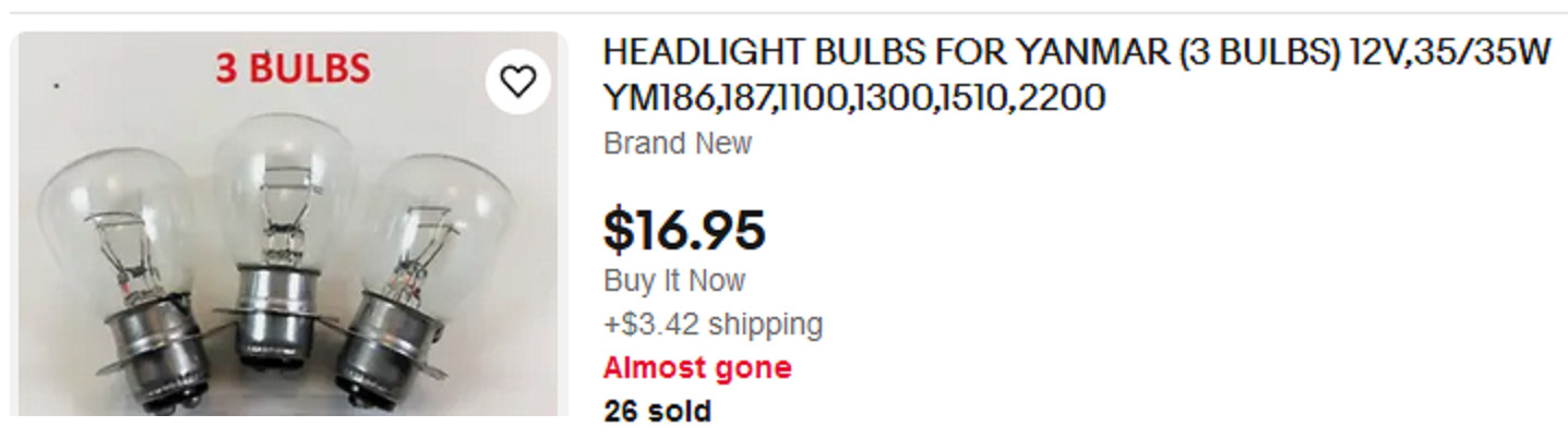

Was browsing eBay for info and noticed 3 bulbs going for a mere $17+shipping.
This is basically Ag eBay robbery of the consumer !
That's right, look for the deal and for a BETTER halogen bulb too.
   / Headlamps flickering then quit working, finally solved. #9
Lots of sellers like that. It always pays to double check other places, as you did.
