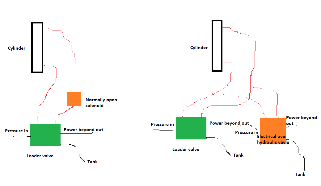

Just for the fun of it:
Does anyone know if this will work? For a level stop.
If I put a 12 volt hydraulic flow solenoid between the curl fel connection hose of the tractor and loader, once my "level" rod switch is activated and shuts off the hydraulic flow to the curl function, will the bucket stop and be stiff at level until the solenoid opens again? Just like it is stiff when I release the control lever? Or will there be play back and forth in the pistons?
Something like this valve, they have one with 26 gal per min also.
Northman Fluid Power Hydraulic Directional Control Valve 16.8 GPM, 4500 PSI, 2-Position, Spring Offset, 12 Volt DC Solenoid, Model# SWHG02B2D1210 | Power Solenoid| Northern Tool + Equipment

Would you put the plumbing in series or in parallel to your normal loader valve?
If you put it in series, you would need to manually curl the bucket & your simple on/off valve between the loader valve & cylinder would trip according to the sensor. Then the system would immediately go into relief, pretty much like you limited out the cylinders. Once you heard the relief valve start squealing, that would just be a signal to let off the curl lever. I'm sure you could replace the loader valve with something detented to pop out, but that would be a bit costly & complex (and beyond my knowledge for now).
If you plumbed in an open center electronically actuated valve into the power beyond loop you could probably have both your normal loader valve & your electronic return to level valve feeding the curl cylinders. When both valves are centered, it will block the work ports & not let the cylinder move. If you were to use either valve, it would open 1 work port to pump & the other to tank, just as normal. Essentially you'd end up with a normal loader valve operating as usual & an electronic valve initiated by a button or 2 to electronically return the bucket to level. Plumbing something in parallel like that would be more brainless to use I think, but harder & more expensive to implement.
Just brainstorming ideas based on my limited knowledge of hydraulics.
Thanks for commenting and helping out Fallon
I would like to put the valve between one of the two fel curl hoses at the quick connect. Just one quick connection. In and out of the solenoid /valve. I realize it will only stop one way.
Install an on/off button on the joystick and pilot light on the dash showing when power is on for the solenoid.
So after dumping the bucket, press the button on the joystick, power light on dash lights up to let you know the solenoid is waiting for the trigger. Once the bucket curls back up after dumping and hits my level sensor for my Fel level light (already on the tractor) . The solenoid kicks off the hydraulics to the curl and the bucket stops at level . Let go of the joystick, hit the on/off button off, go get another load.
(Nothing myself or any other operator can't do manually)
Could it be something that simple? Just seeing if I can make a simple auto level option.

The only way an on-off solenoid valve in 1 or both work ports between the loader valve & cylinders would be effective is if there is hydraulic pressure/flow in that line. The only time that would happen is if you manually are engaging the loader valve's curl function. Otherwise you'd just be blocking a line that's already blocked by the loader valve (or opening a solenoid on a line already blocked by the loader valve), doing nothing. I'd assume blocking either work port would work, you need pressure & a place for the oil from the other side of the cylinder to go to get stuff to move. I'd expect blocking either line would stop things. Somebody who has more practical experience than I should probably confirm that though.
To be able to hit a button & nothing else then have things return to center via your sensor gear, you'd need another entire valve & hydraulic supply circuit from my understanding. The work ports on your existing loader valve & your new solenoid operated valve should be closed & able to keep cylinders from collapsing. So you should be able to put a T between work port A on the loader valve & the solenoid valve, then another T between the 2 B ports. If you operate either valve it should open 1 work port to pressure & 1 to tank, properly moving the cylinder.
Be careful of taking advice from somebody who has yet to finish his first hydraulic project & can't tell the difference between 3/8" & 1/2" fittings. :p
I'm a nerd & have recently moved from computers to tractors as my tinkering obsession. I see value in doing cool things for engineering sake, regardless of if I have the skill or not.
Very nice work, WAX. It is nice to see such a practical device made and installed with such
good workmanship. I can esp see this helping on snowy nights, as you say. (I, too, have
pimped out my tractor with numerous mods.)
As for the hydraulic limiter you want to use: you can install a 12V spool-type solenoid
valve on one side (curl or dump) of your bkt cylinder circuit, and that would stop your
curl action when your switch hits the detent in your rod. I use one-sided solenoid valves
to do a similar function on my 4-in-1 bkt and hydraulic hoe thumb.
You can use a very small valve, however, like the HydroForce valves I used. Use a
normally-open valve, and avoid the more common poppet-type valves out there.
Go for it, and let's see what you come up with.

It would be pretty easy to wire up. Normally open hydraulic control solenoid wired with your level sensor & a push button wired in series. Push the button & engage the loader valve, things start moving. When your level sensor trips & closes the circuit, it would close the valve & stop the bucket. The relief valve would probably start whining prompting you to let go of the loader valve. When you let go of the button the solenoid would open up returning things to normal loader valve operation.
If you wanted it completely automatic with no need to manually manipulate the loader valve, you'd have to put in another entire electrically operated valve (with 2 ports, 1 for pressure & 1 for tank).
Attached is a quick sketch, the series option would be on the left, parallel on the right.
As long as 1 valve in series was closed there should be no movement. Both valves in the parallel option would have to be closed (which they should be when centered) to keep things from moving.
You could probably tweak the engagement point of your sensor to compensate for any delays in the valve activating. & what not. I don't have enough experience to say if 1 or 2 valves would be required for the series (left) option or other issues.

Thanks dfrug. is this the valve your talking about?
HYDRA FORCE 12 VDC N.O. SOLENOID VALVE
It's nice and small, I could put a quick disconnect on it and sandwich it between my fel connection.
65 bucks or so is worth the experiment.
/ Electronic FEL level indicator #35
"When de-energized, the valve allows bidirectional flow from port 2 to port 1. When energized, the valve�s poppet closes to block flow from port 2 to port 1. In this mode, the cartridge allows free reverse flow from port 1 to port 2, after overcoming the solenoid force (50-150 psi)."
That would function as a 1 way valve when energized. Your return to level would work when dumping the bucket towards level, but not raising to level (or the other way around, depending on which line you put it on). You'd end up needing 2 of those. I didn't see something that looked right when I did a quick look.
That is not what you want; it is one of the common poppet valves that I mentioned above.
I bought a new one (Sterling) just like that on eBay for about $35 and experimented with it. One
way only, or buy 2 valves, as FALLON says.
You are better off just ordering what you want from a solenoid valve maker's disti.
