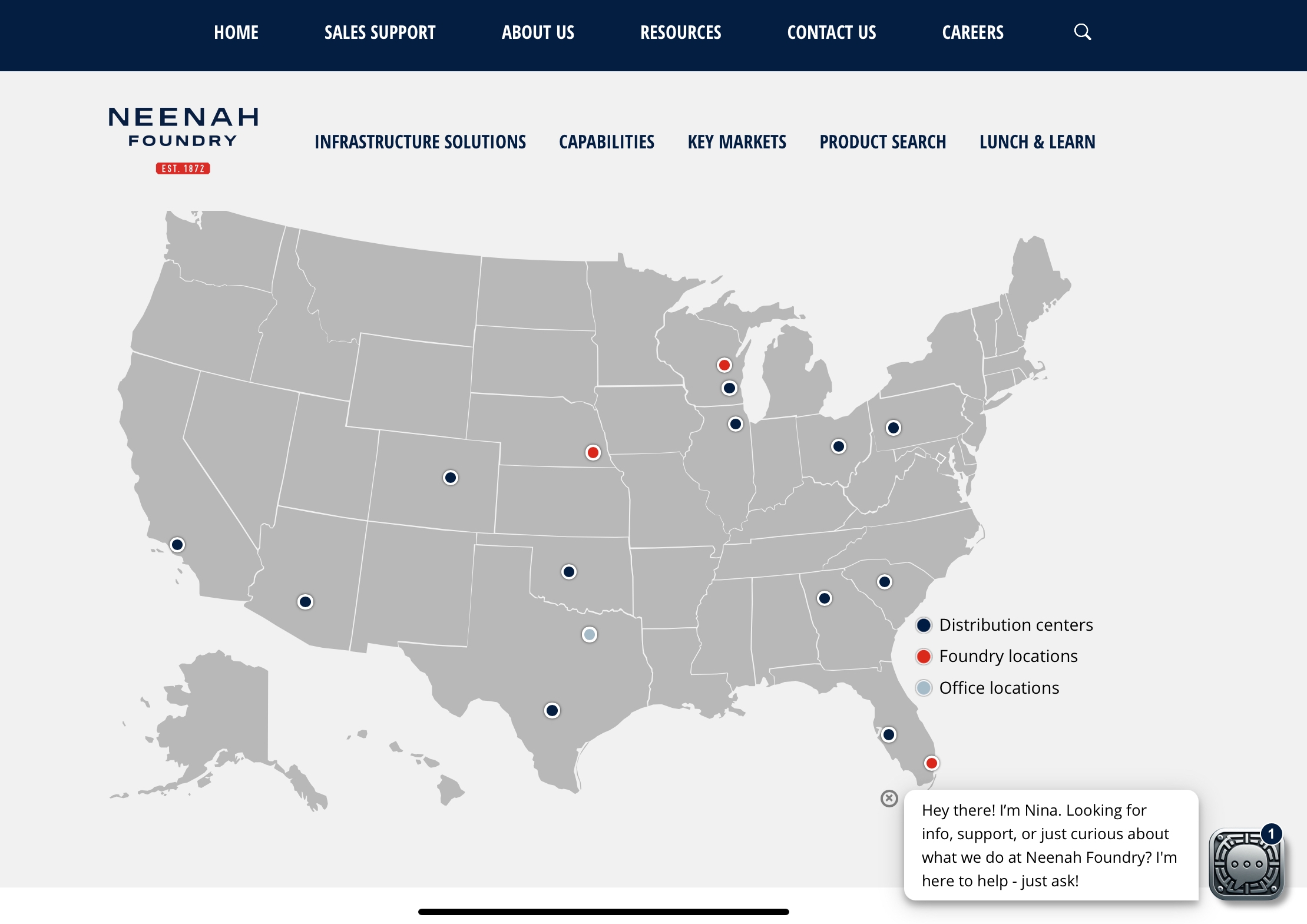

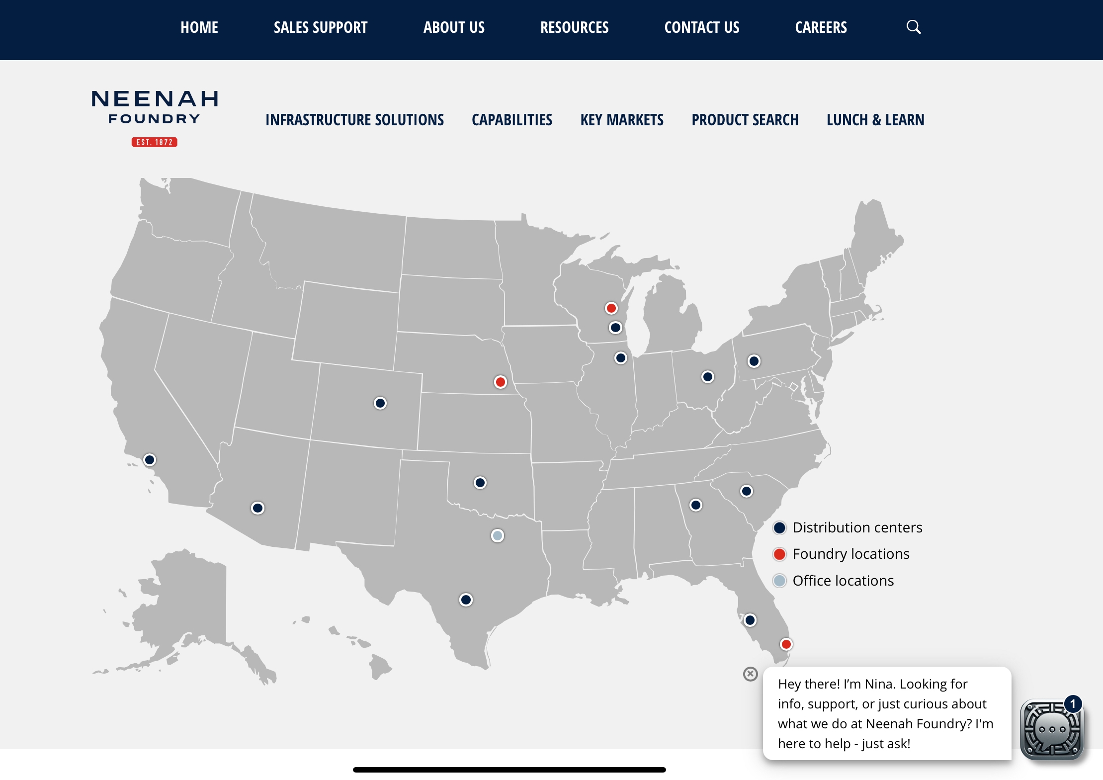

Yes, it was that foundry. I always enjoyed seeing their products around the area, rather like seeing the Neenah foundry products.
All the best,
Peter

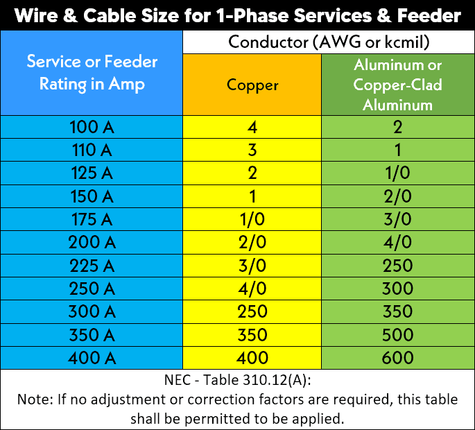

Agreed, as aluminum conductors weigh approximately 3 times less for the same conductor size vs copper.
For aluminum needing to be sized larger to have the same ampacity as a copper conductor the weight of the Al conductor is still around half the weight of Cu.
Half the weight factors into installation being easier to install and lower transportation cost.
