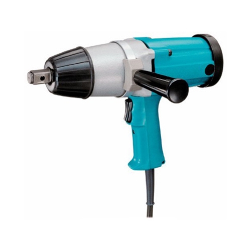

/ Electric VS Air #24
Far as electric impacts go, I've been very satisfied with my Makita 3/4-inch. :cool2:
