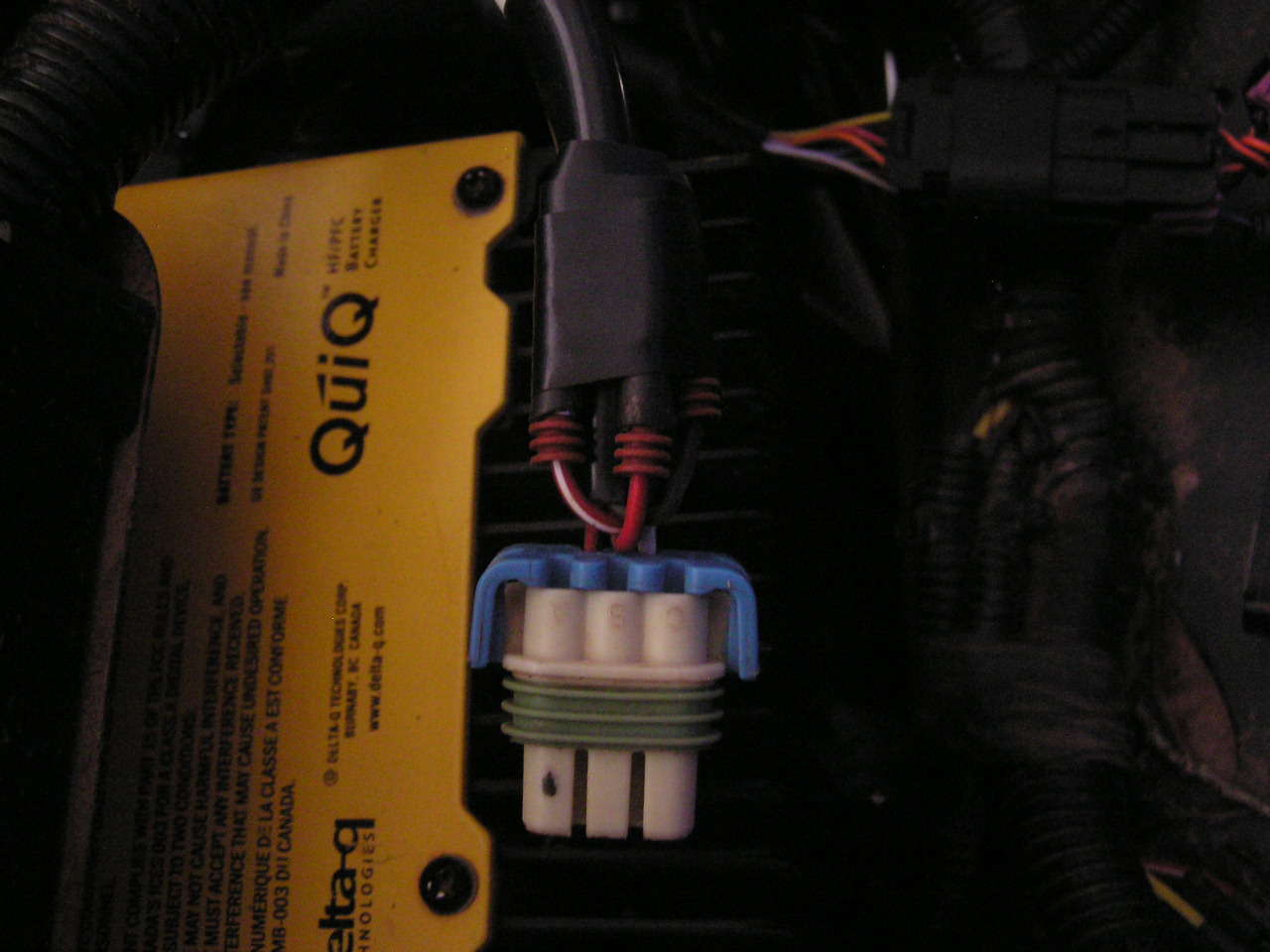

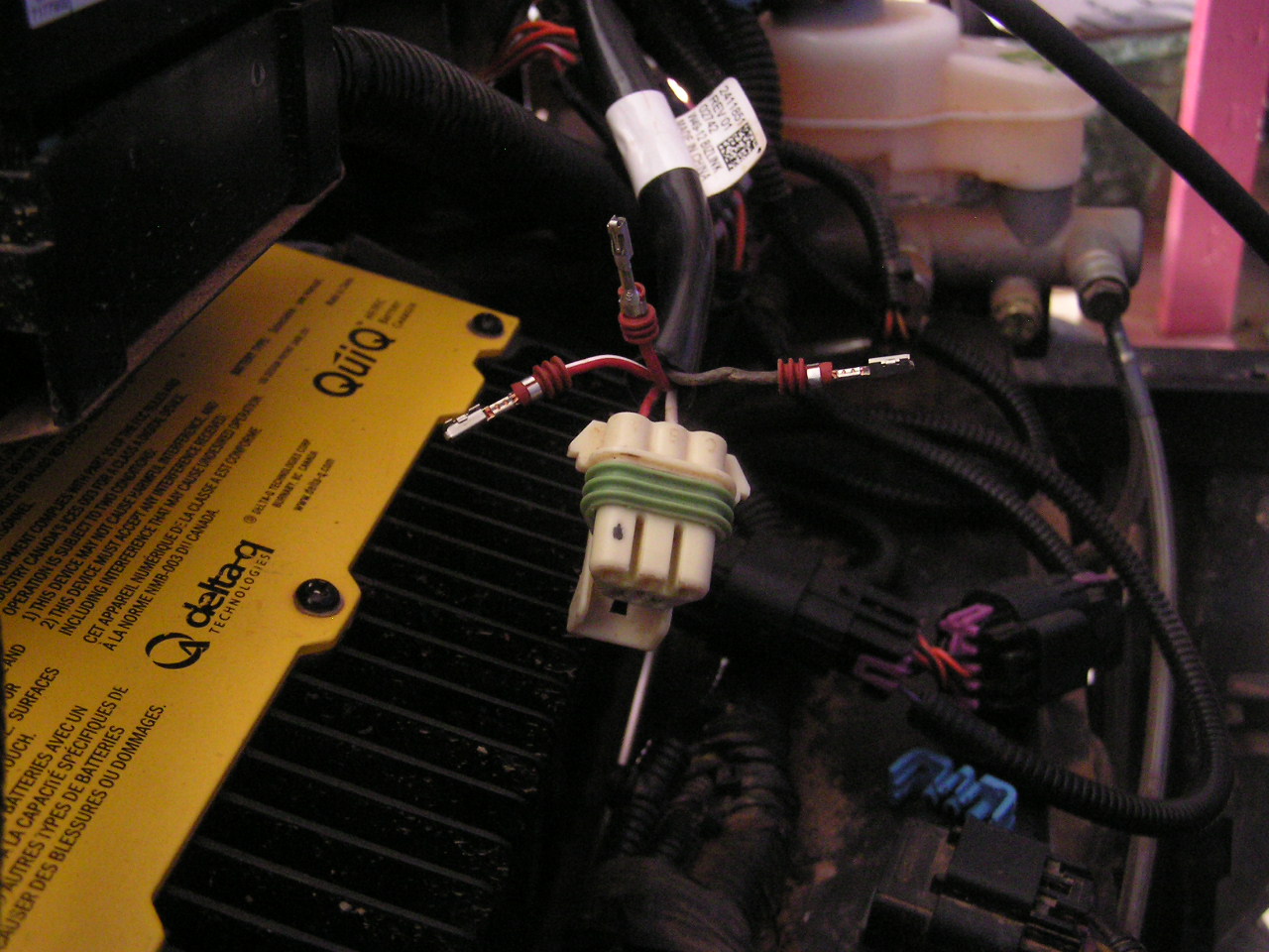

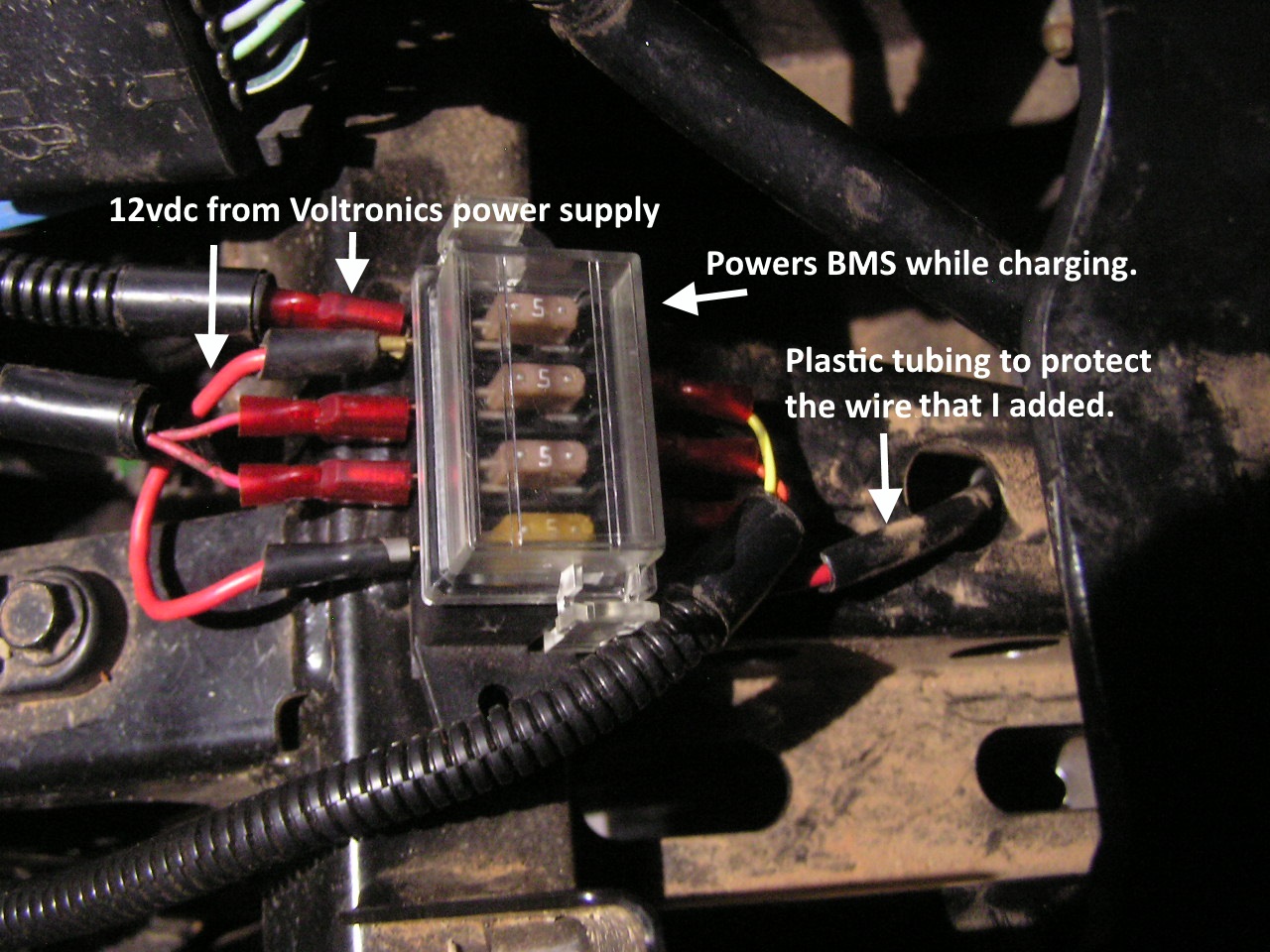

For reference powering the charge status indicator, read this and post #130: http://www.tractorbynet.com/forums/...c-polaris-ranger-post4886706.html#post4886706

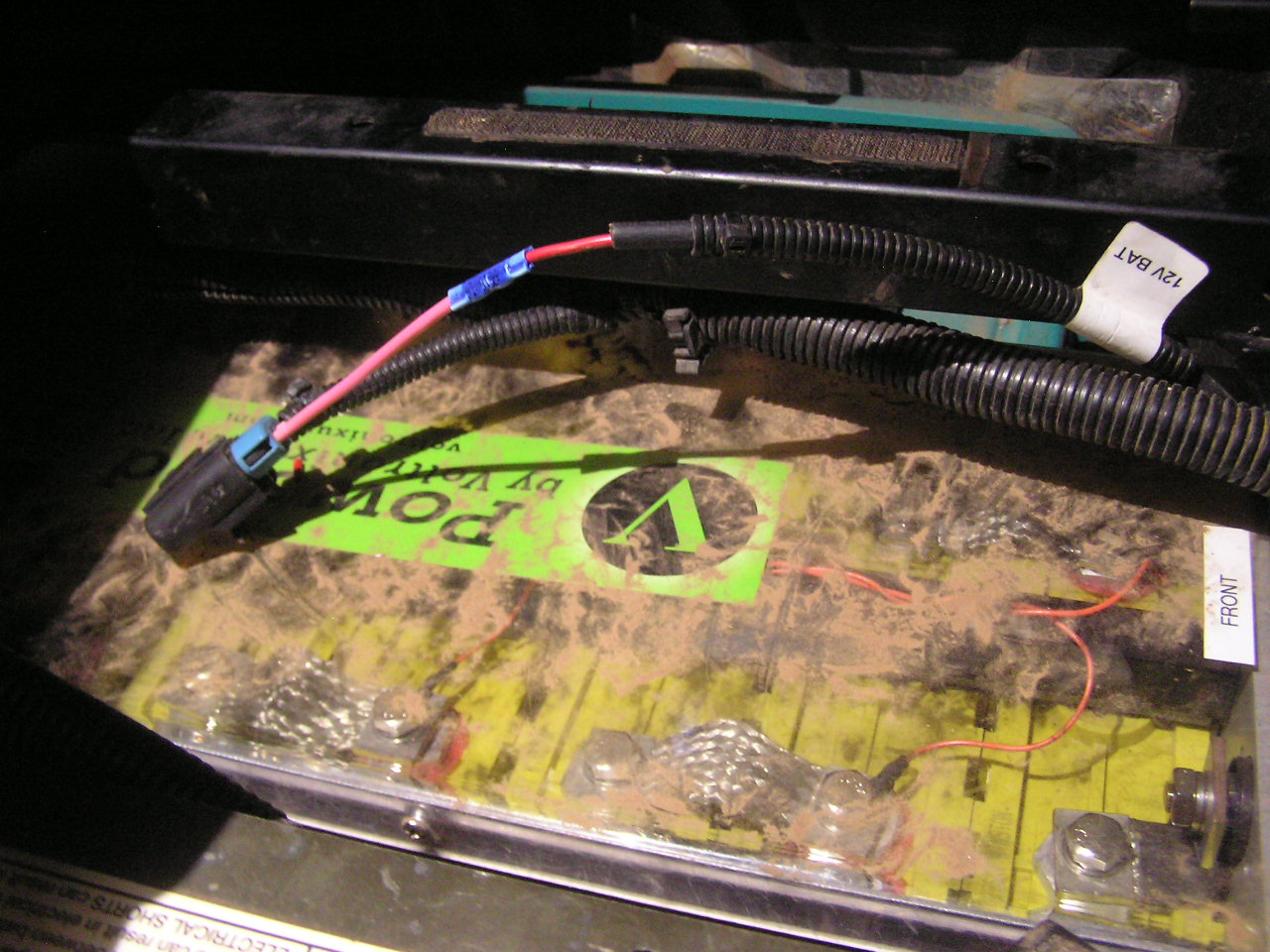

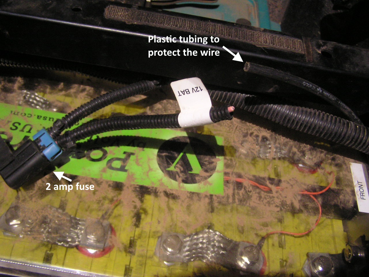

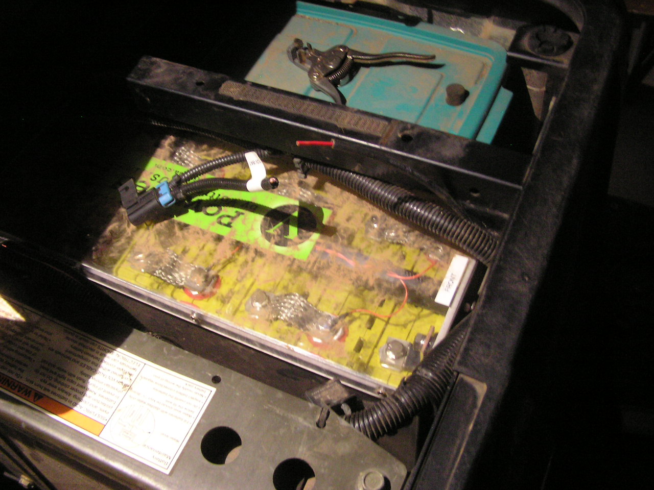

The easiest thing would be to run a wire from the power supply to one of the fused +12v Bat wires under the seat, because they have a diode that would prevent the back feed from the converter.

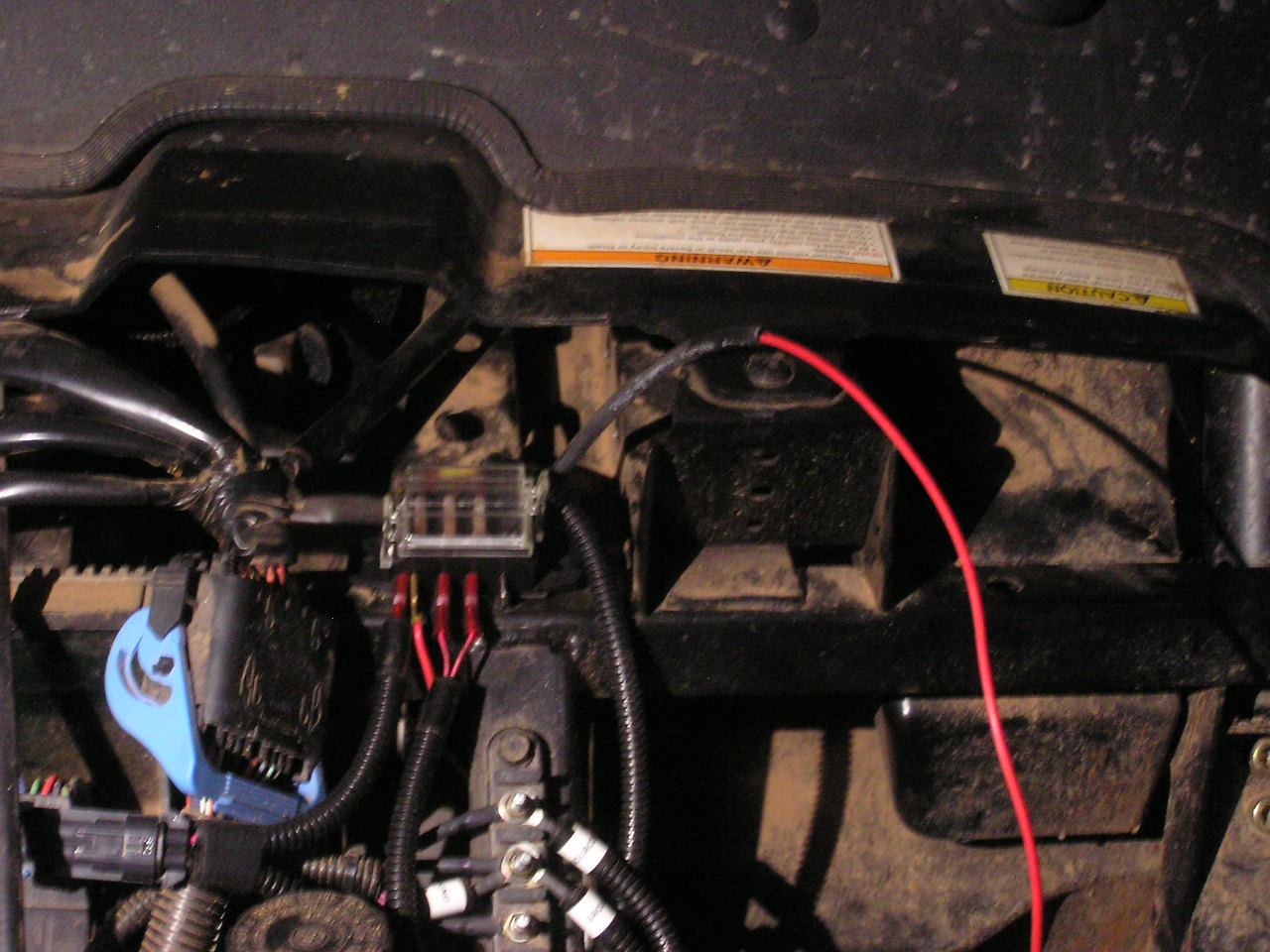

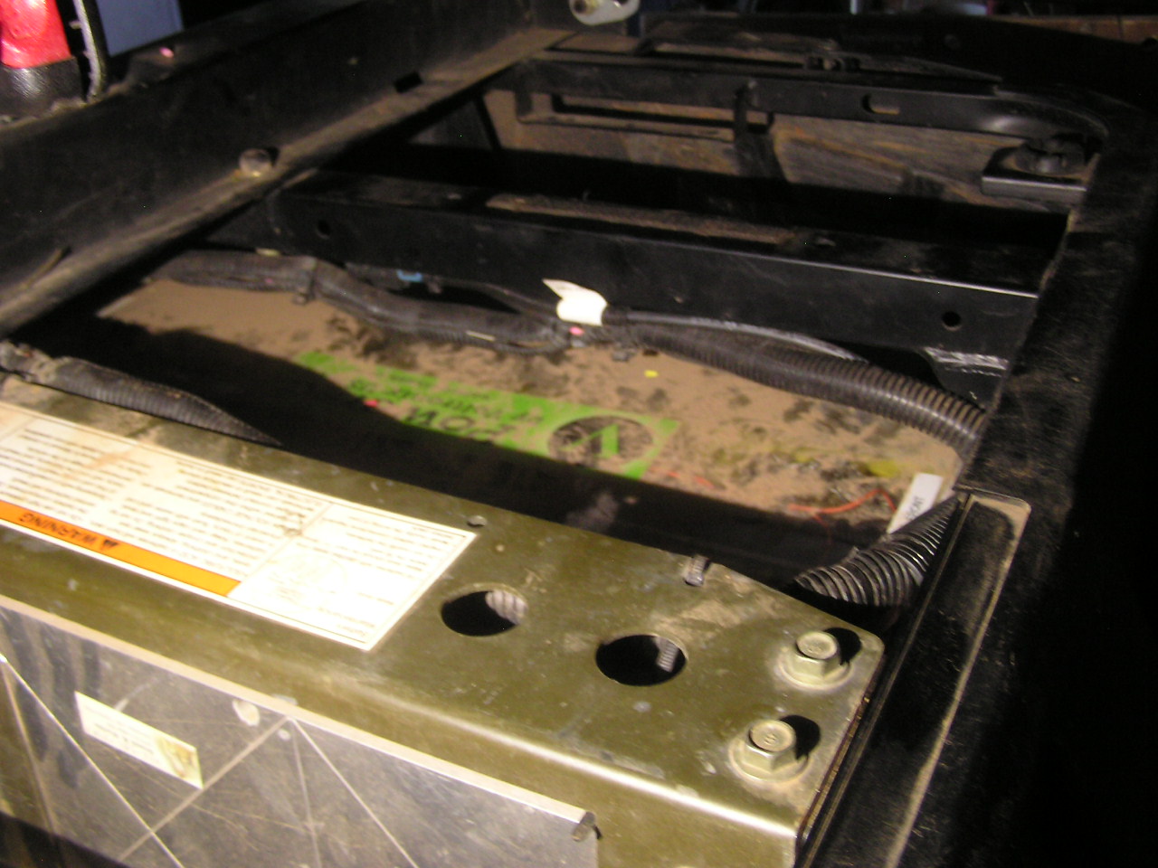

Could not find either diode, so I did it the "easy way". Used some small tubing to protect the wire coming from under the hood to under the seat:

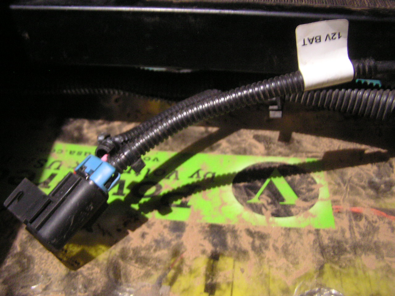

Poked the wire into the tubing and pushed it through:
Spliced to the pink 12v bat wire that was on the first deep cycle battery in the series string:
Slid the covering back over to the fuse holder and put it back up out of the way:
The Voltronics power supply is only on when charging the battery packs:
It now puts it's DC voltage through a diode to the constant power wiring system causing the Charge Status Indicator to operate:

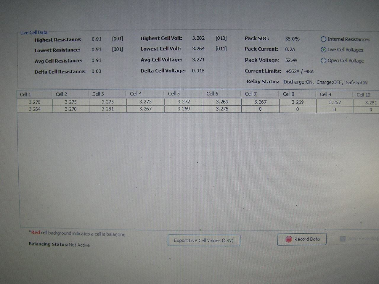

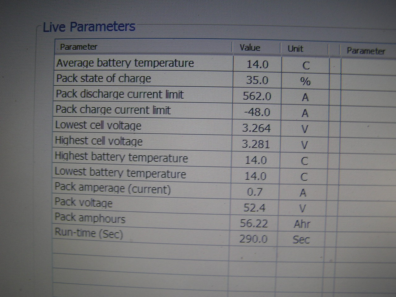

It has been about 20 days since I charged the Voltronics Lithium-ion batteries, the SOC was showing 40%:

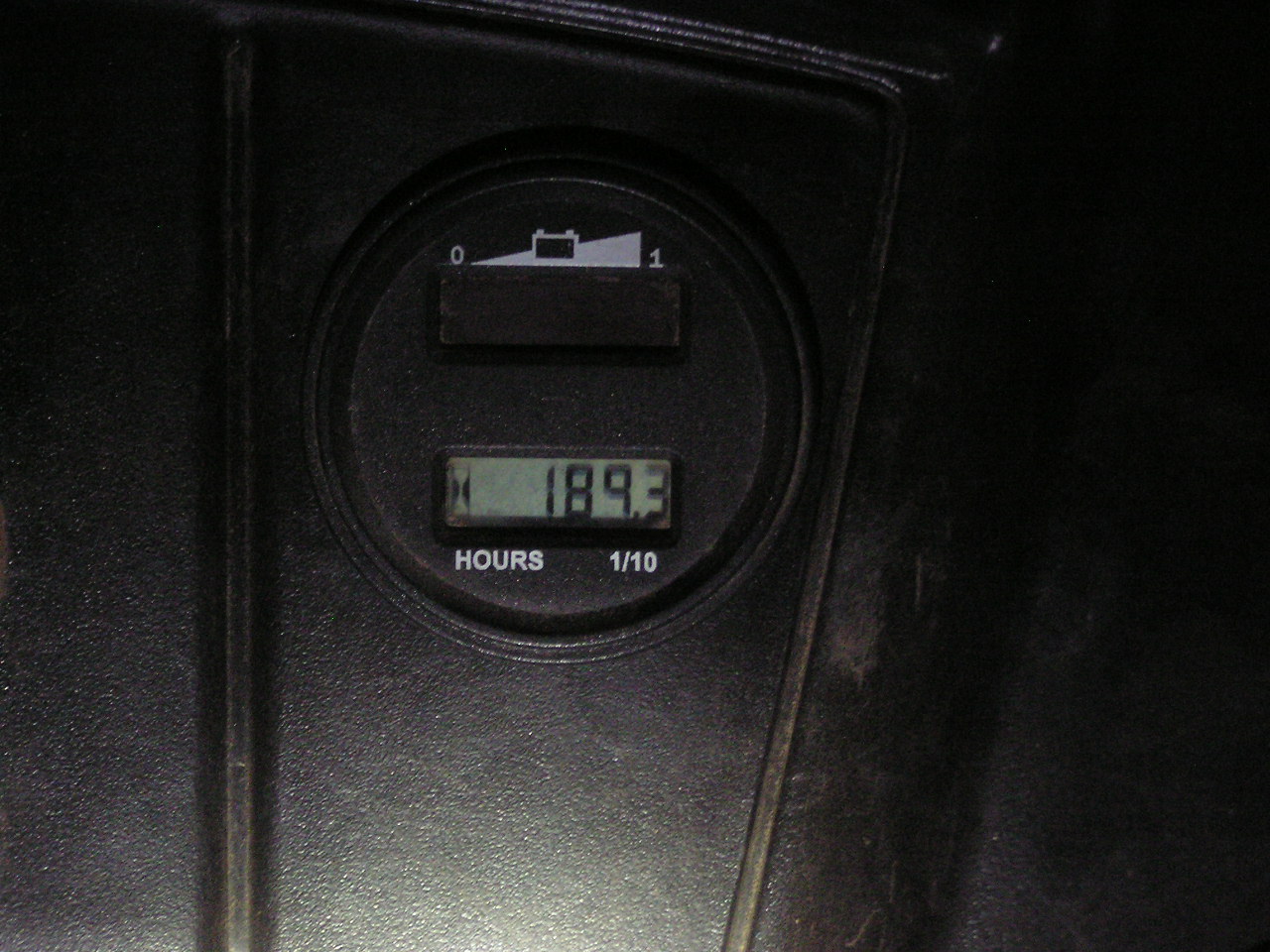

And 189.3 hours:

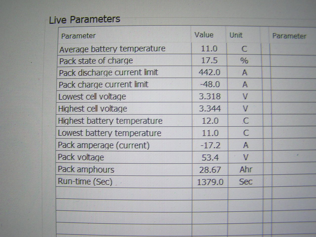

Screen shots from before plugging in the charger, Pack voltage is 52.4 volts:
Right click this one and open in new tab, to see it better

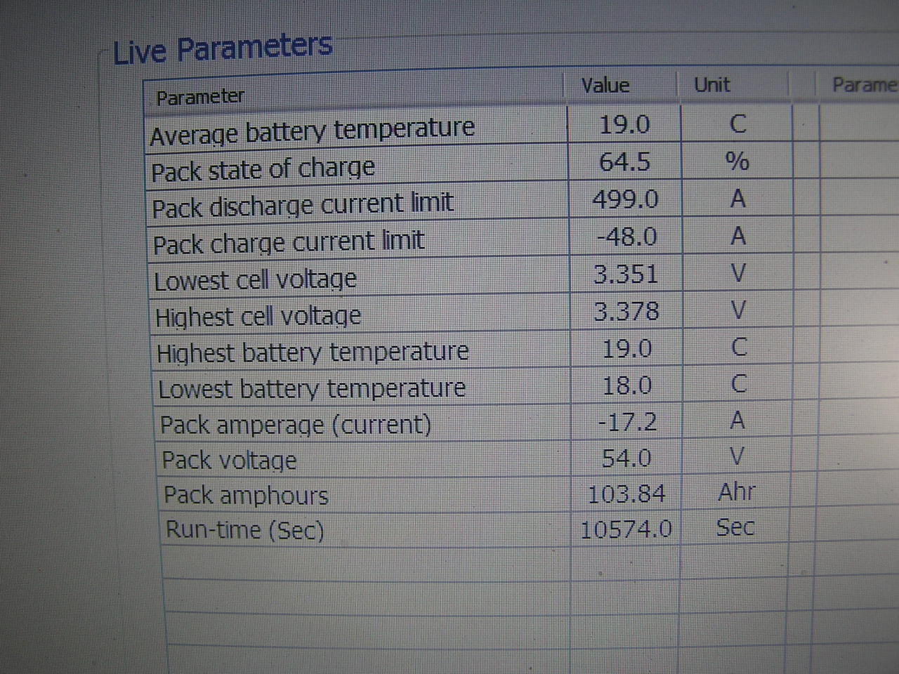

Plugged in the charger at 10:30, the Charge Status Indicator started flashing, my wiring modification is working!
Came back after lunch, SOC is up to 64.5%, 17.2 amps going into the batteries. Pack voltage is 54 volts:

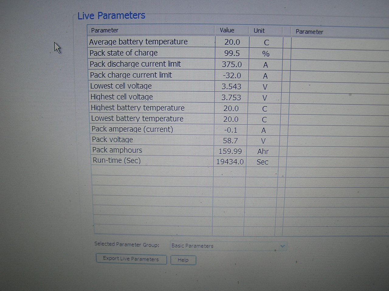

Just over 8 hours charge time, the Charge Status Indicator is on solid:
Pack voltage is 58.7 volts:
Fourth time charging was successful.

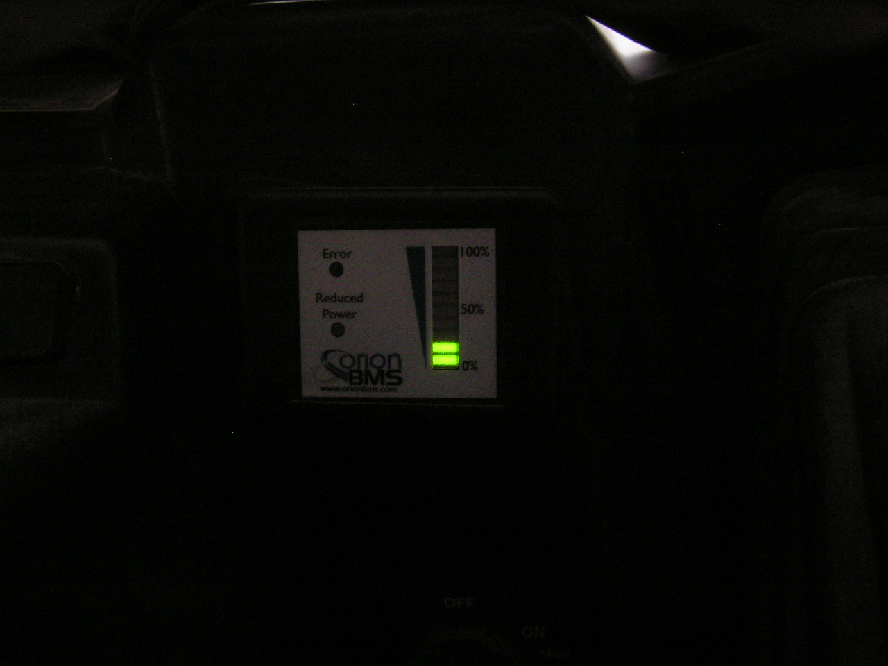

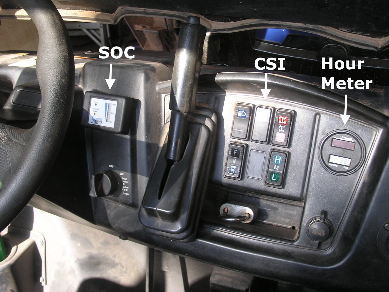

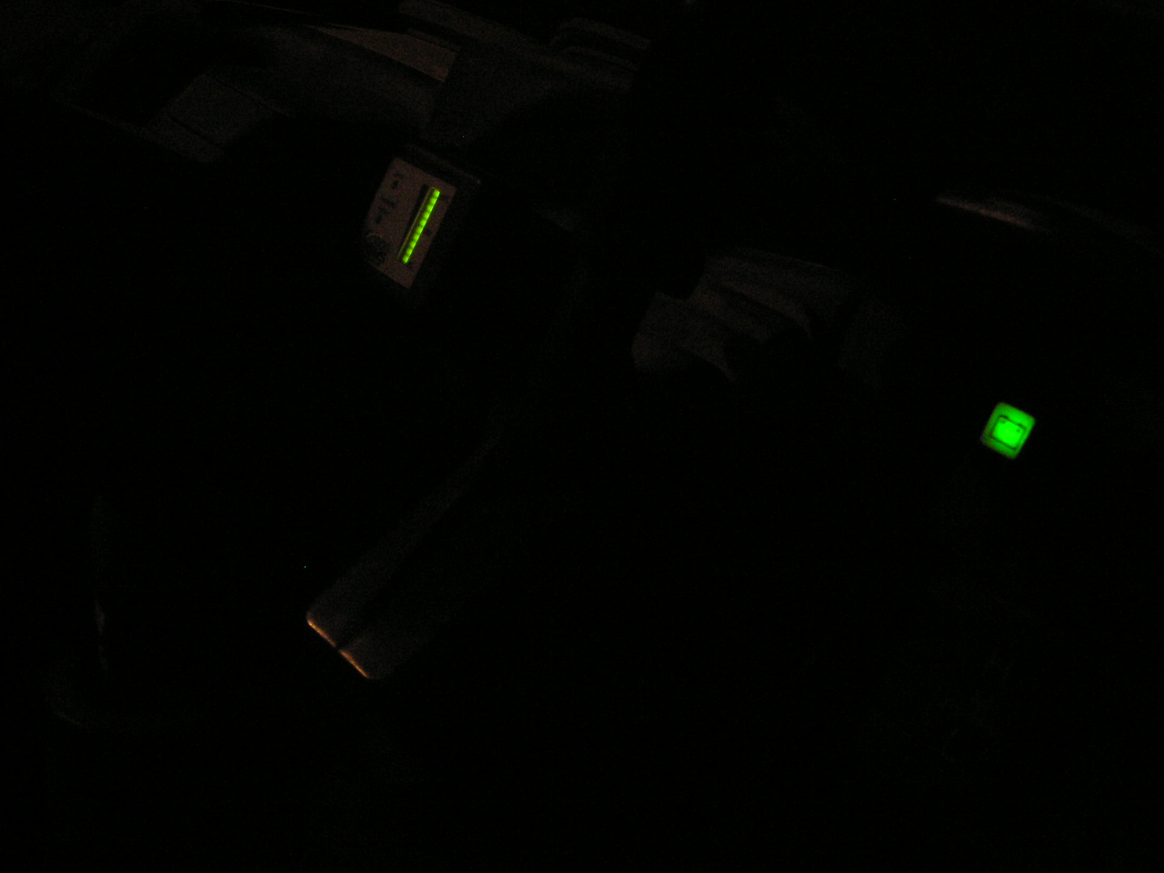

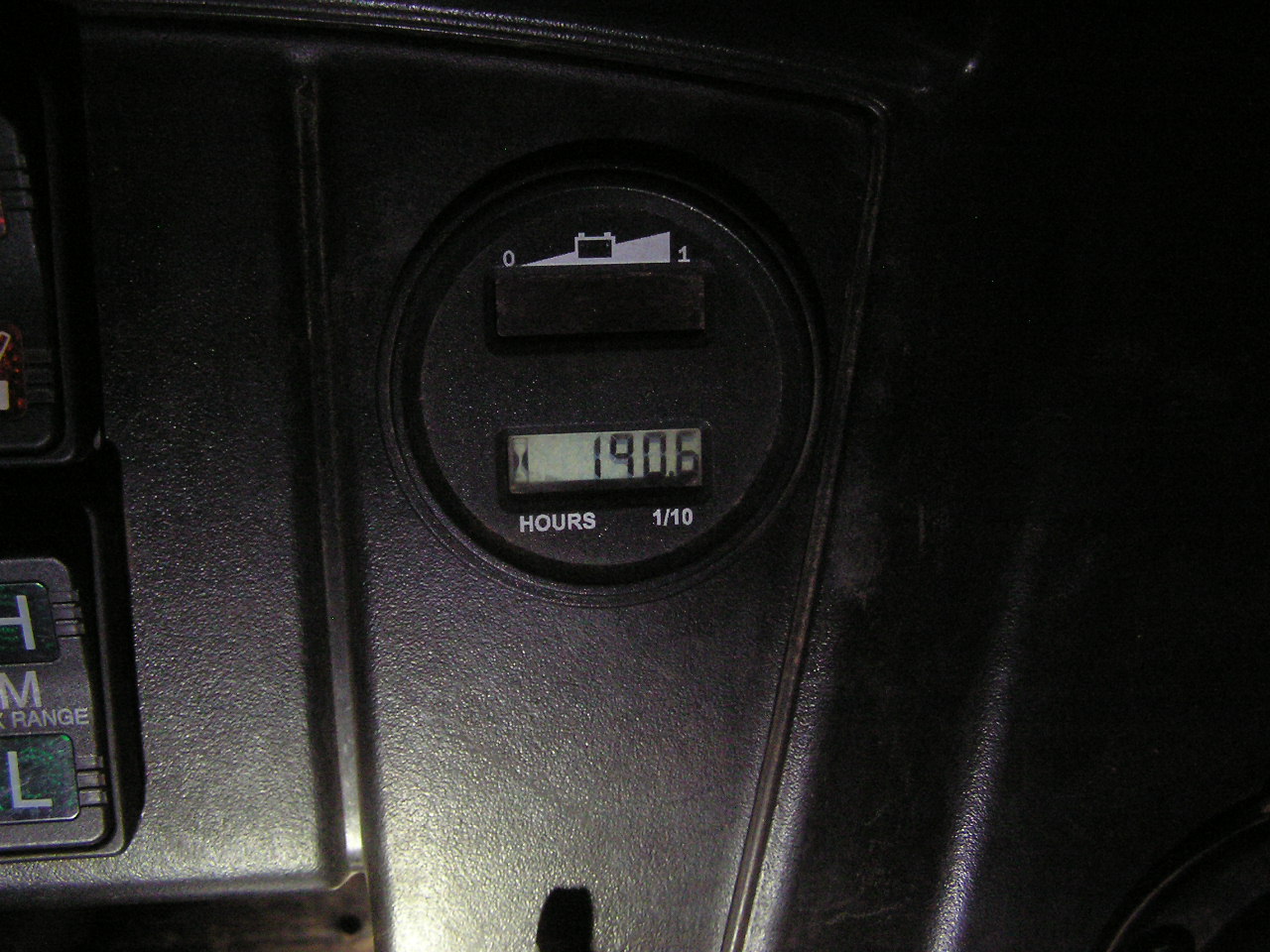

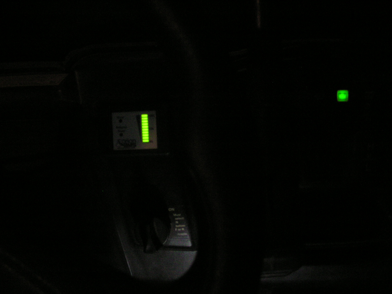

It has been over three weeks since I charged the Voltronics Lithium-ion batteries, the relocated SOC meter was showing 2 bars:
And 190.6 on the hour meter, nice to have it back in the dash:
Screen shots with just the BMS powered, before plugging in the charger, Pack voltage is 52.5 volts SOC is 17.5%%:
Right click the above picture and open in new tab, to see it better.

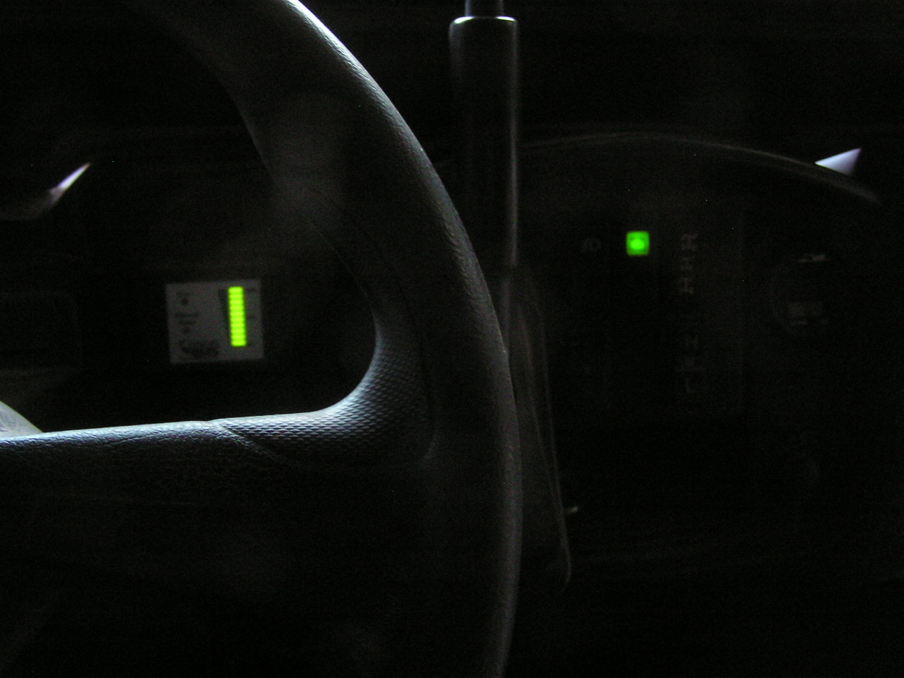

Went out at 5:30 pm, ten bars on the SOC meter and the Charge Status Indicator is on solid:
And the green light on the charger is on solid:

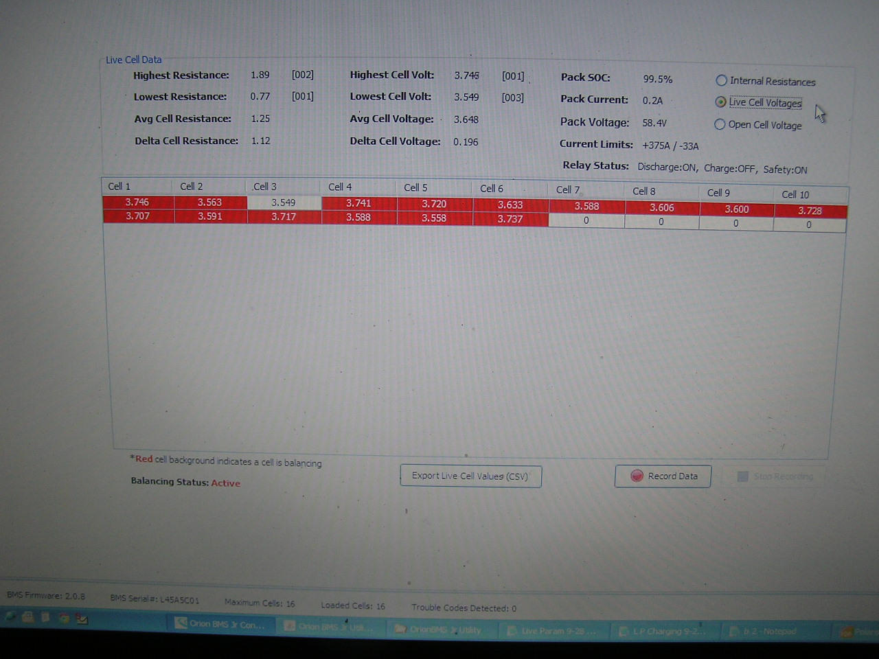

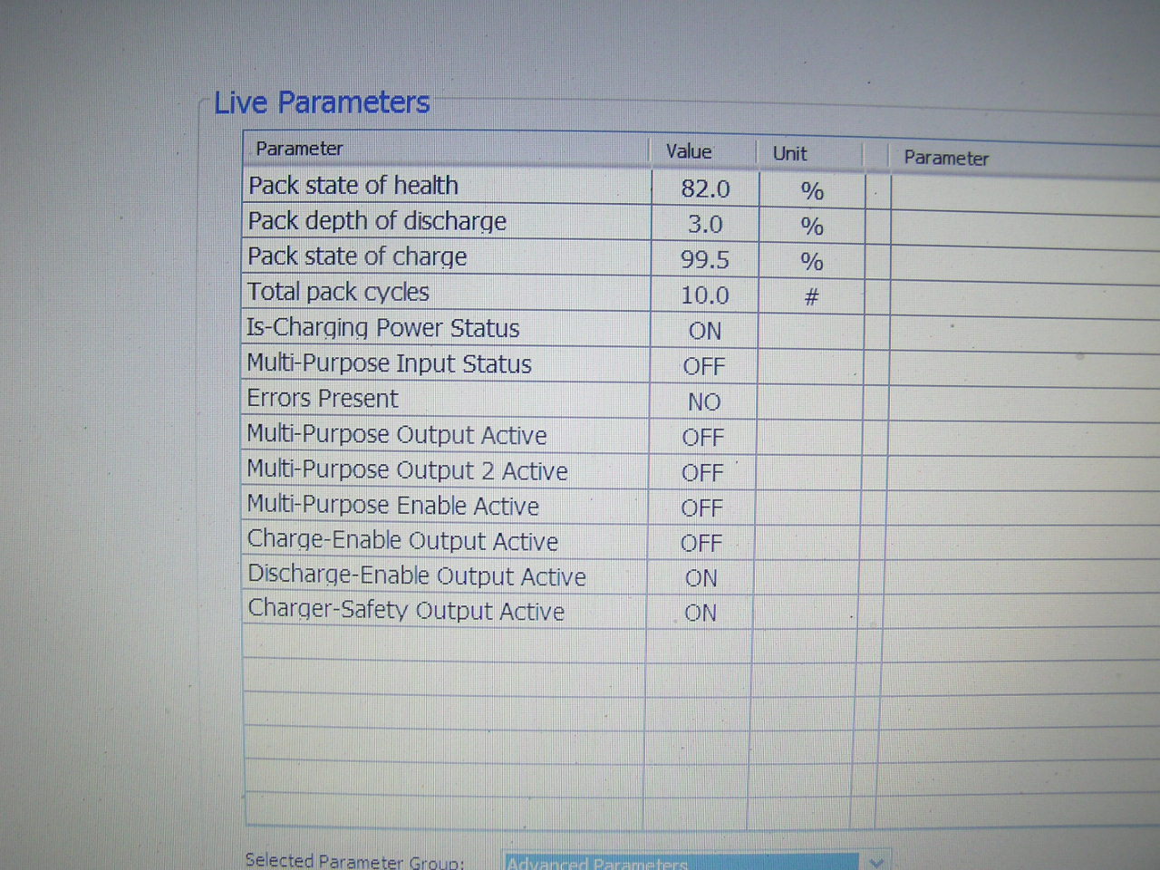

Pack voltage is 58.7 volts and no charge current flowing:
More information overload from the BMS program: :D
Fifth time charging was successful. :thumbsup:

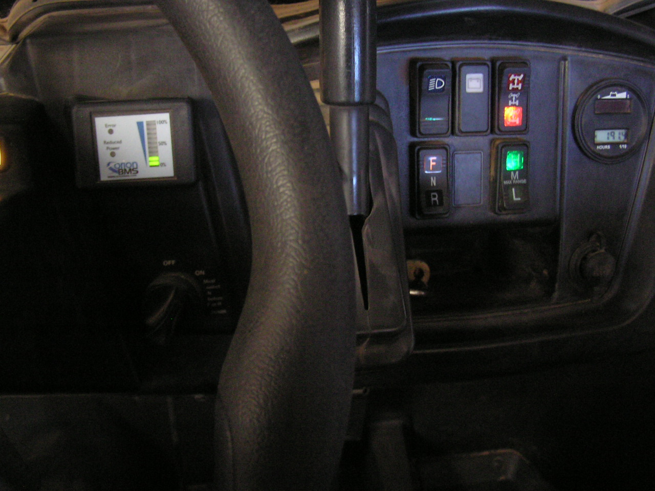

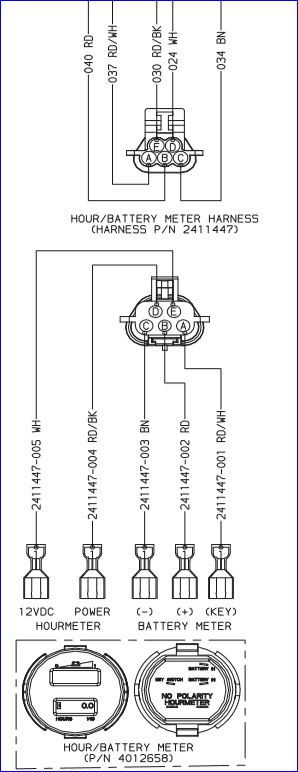

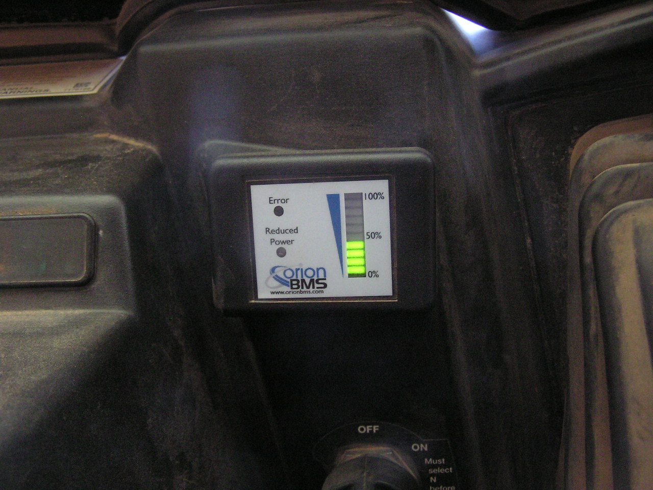

I decided that I want the LOC back in the dash so the hour meter is visible. ---------------------
Put the LOC meter back in the original location, will probably disconnect the red LED battery LOC, since it is not accurate with the new Li-ion batteries:
Checked the wiring diagram:
Unplugged it and pushed out the three connectors for the Level Of Charge meter:
Put rubber tubing over the connectors and taped with electrical tape and plugged it back together:
The key is on and the red LOC LED is off, yea!:
Now it is just a Hour Meter, yea!:

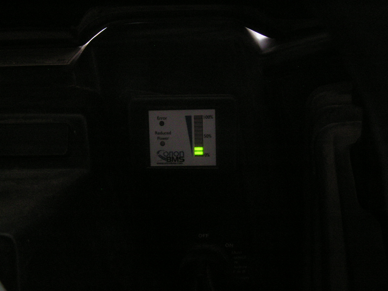

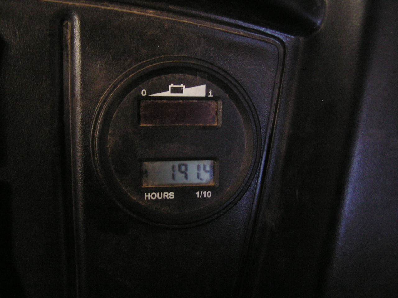

It has been two weeks since I charged the Voltronics Lithium-ion batteries, the relocated SOC meter was showing 2 bars again, just like last time:
And 191.4 on the hour meter

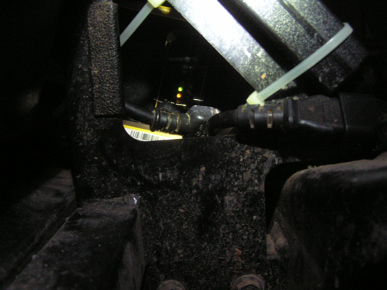

So yesterday after the modification to the LOC meter I unplugged the charger from the Y connection and plugged it in to turn on the BMS. Got a picture of the status before charging:
Plugged the charger into the Y connection at 3:05 pm. Went out at 9 pm, the Charge Status Indicator was flashing slow, meaning over 80% complete. While I was looking at the BMS data, the CSI went solid green, meaning charge complete:
Sixth time charging was successful. :thumbsup:

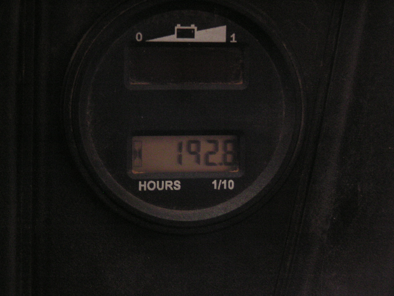

It was two and a half weeks ago that I charged the Voltronics Lithium-ion batteries, the SOC meter is showing 2 bars again, just like the last two times:
And 192.8 on the hour meter equals 1.4 hours of actual run time, mainly going to the mail box and back:

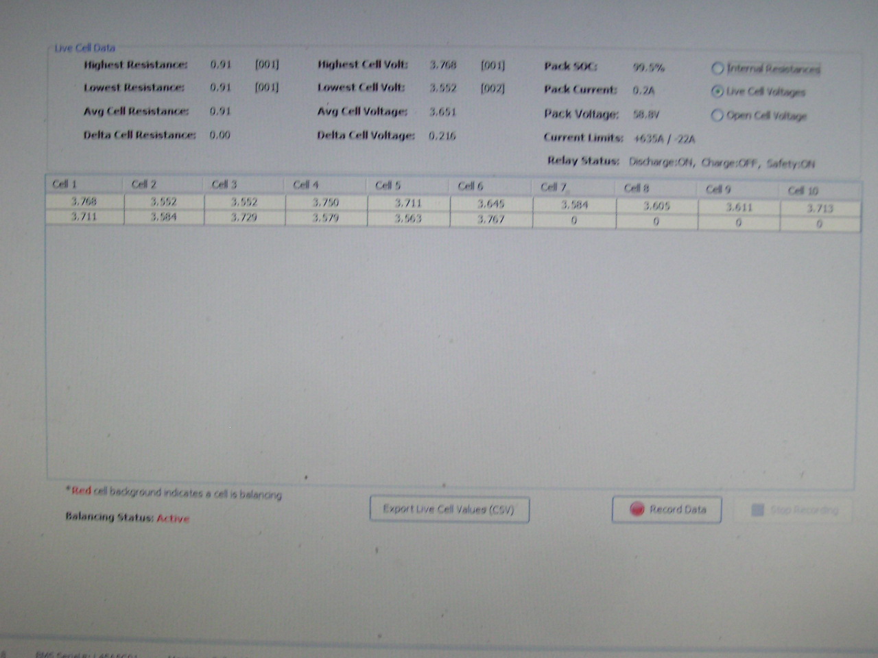

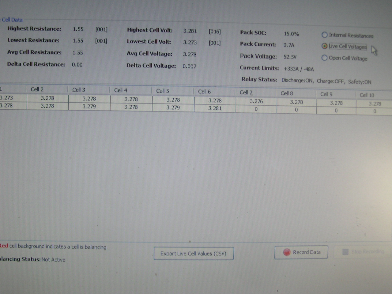

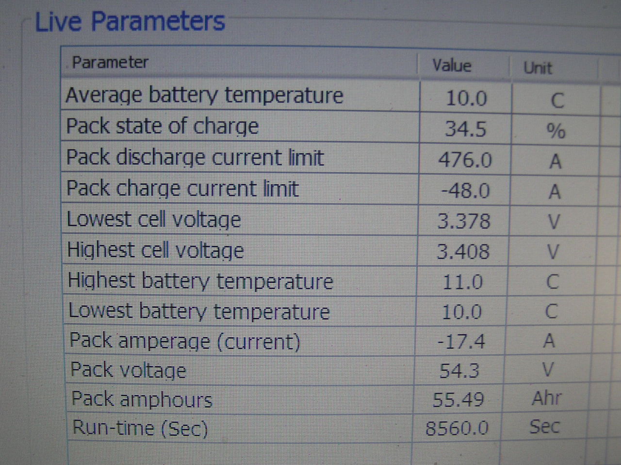

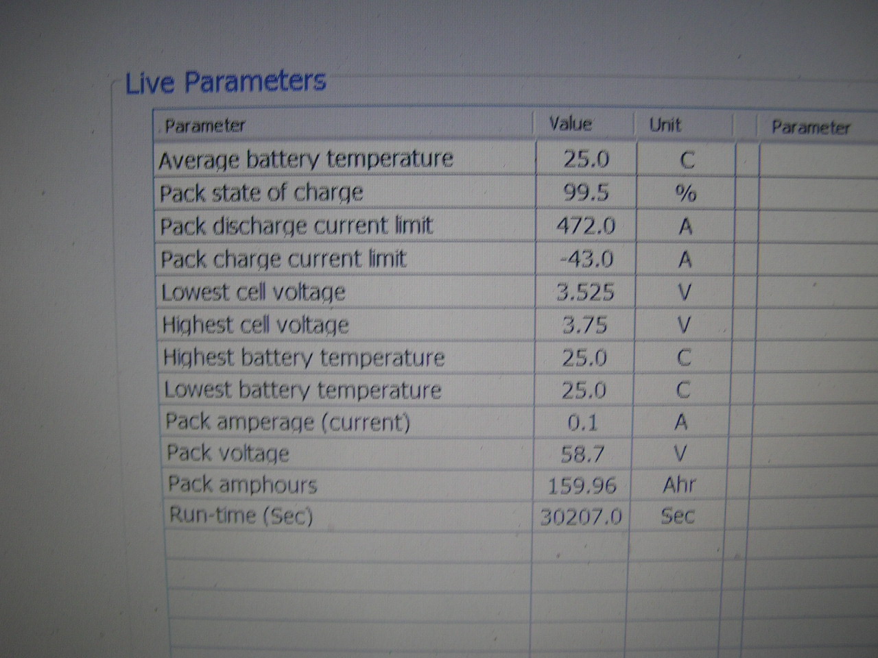

So yesterday I unplugged the charger from the Y connection and plugged in the cord to turn on the BMS. Got a picture of the Live Params before charging, showing pack voltage at 52.5 volts equals 15% SOC:
This shows the voltage of the 16 cells in the pack:
Plugged the charger into the Y connection at 11:20 am, to start charging. Checked the BMS at 1:17 pm, the SOC is up to 34.5%, charge current is 17.4 amps:
Went out to the garage at 7:20 pm,
ten bars on the SOC meter and the Charge Status Indicator is on solid, meaning charge complete:
Pack voltage is 58.8 volts and no charge current flowing:
Seventh time charging was successful. [/COLOR][/COLOR]:thumbsup:
