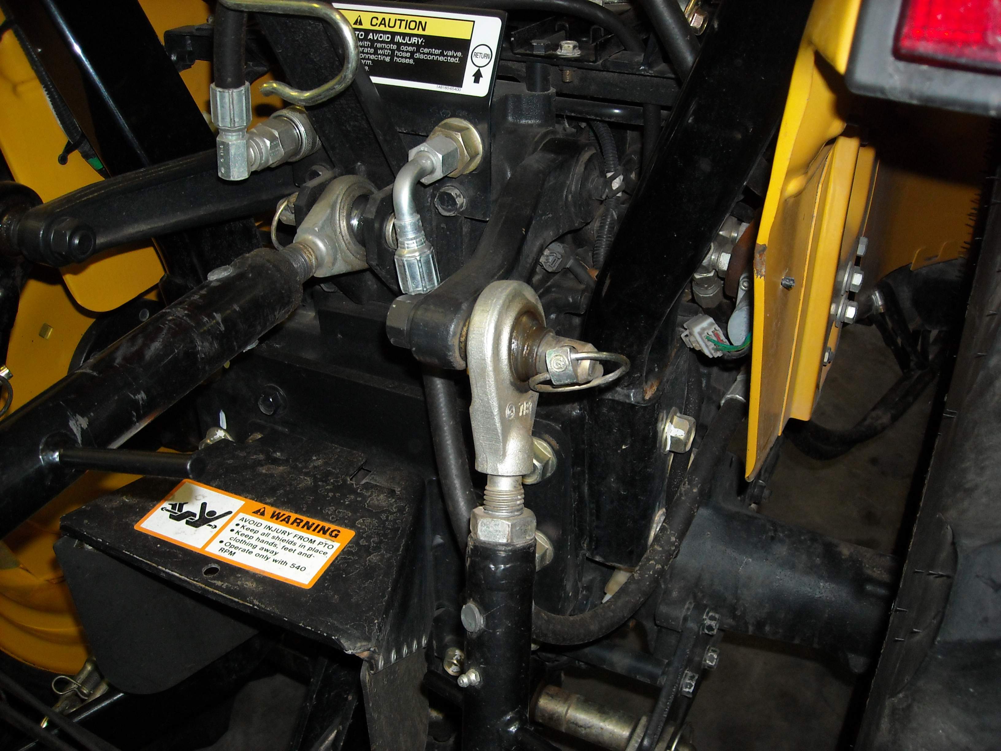

Ok, here are a few pics of the valve. Dont know if you can make it all out but from the "out" from the tractor goes to the valve, the opposing orifice on the valve loops back up the rear of the tractor and goes to "return". The other two lines just go to the front of the tractor as work outlets.

Here is some pics of the right fender area. The fender is decently stable, probably enough to mount a valve body to.

Its only in and out, no other ports on it.
If you read the rear plate on my tractor in the first pic is say "use only open center remote valves". I think i may just get a service manual and see if there is a hydraulic diagram in there. I dont know how much closer of a picture you need, I was right there and thats all you can see of the valve. Again the valve is getting replaced anyway so im not too concern with it, mainly concerned if I can hook up and open center valve block and be fine. I'll try calling a few dealers maybe they've ran into it before as well.

Ok, so I finally got word from the factory and got the "factory" rear remote kit instructions and took a look at them. All this kit does is take pressure from the pump BEFORE any valves and routes it through a normal looking valve (does not appear to have PB as there only 4 hoses) and then this fluid pressure goes into the loader valve which is suppose to be the first valve inline. Mind you this is the factory kit instructions. That seems sort of odd its not a PB valve.
I plan on doing the same thing just downstream between the loader valve and the 3pt valving. \
I have the instructions if anyone wants to see how its "suppose" to be done, this would be for a JD790 as well.

No, this is the factory add on remote valve they locate on the fender, just like most guys here are doing. Instead they plumb it between the pump and loader valve, before the loader valve to be exact. Looking at how the lines are run in the system pressure comes from the pump up to the top of the transmission case into a series of pressure relief valves(which i see on the diagram). From there it goes out of this into a high pressure line which then connects to the loader valve (Loader has a "P" on this port so I know its the inlet to the loader valve.
All they do is take this high pressre line out and put the applicable fittings in and run that pressure through their 'rear remote" valve. 4 lines total, pressure, return and two work lines. Thats it! From the remote valve it goes straight into the loader valve. The loader valve is obviously a PB valve as it has the other two ports, tank and PB clearly marked.
Its wierd a factory would do this as there would be obvious backpressure on the valve when operating the loader. If you PM me your email I can send the file over to you so you can examine it, its a .PDF file.
Like I said Im doing the same thing, except my lines come out downstream of the loader valve itself.
Btw- this is an 800$ option and is maybe 200$ in actual parts.
Ps- I just asked the factory for the instructions to see how they did it and this is what I came up with, with their instructions. Its clear as day what they are doing, i just dont understand the no PB valve.
