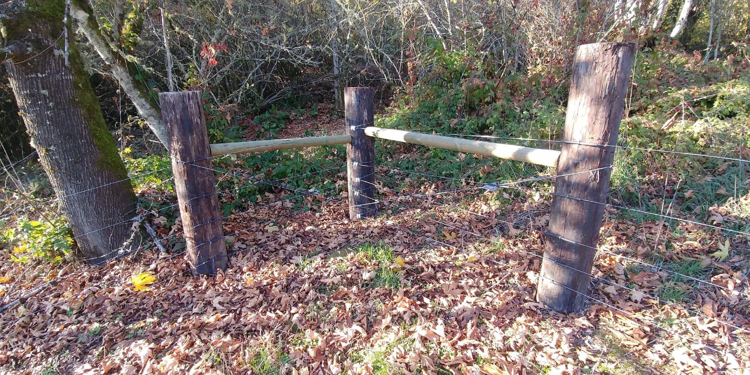

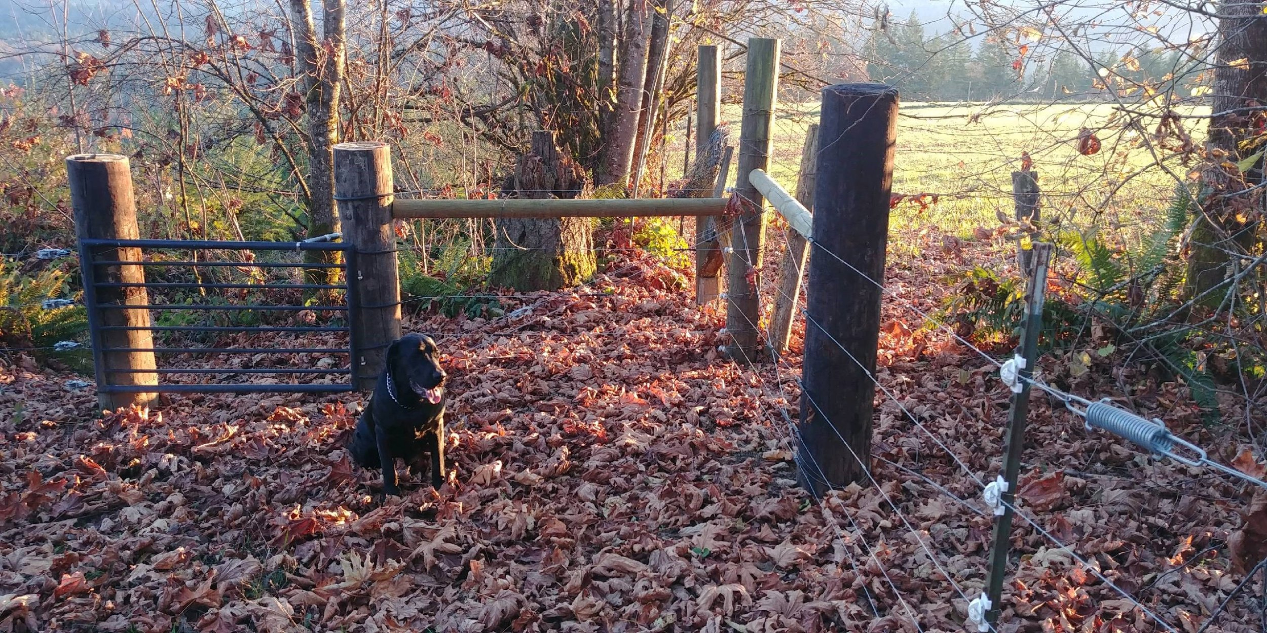

This is what I have. The remote is great when your in the back of the property and need to turn off the fence. I have 15 acres fully fenced with 5 strand. I run kikos and none have ever gotten out that I have seen.
