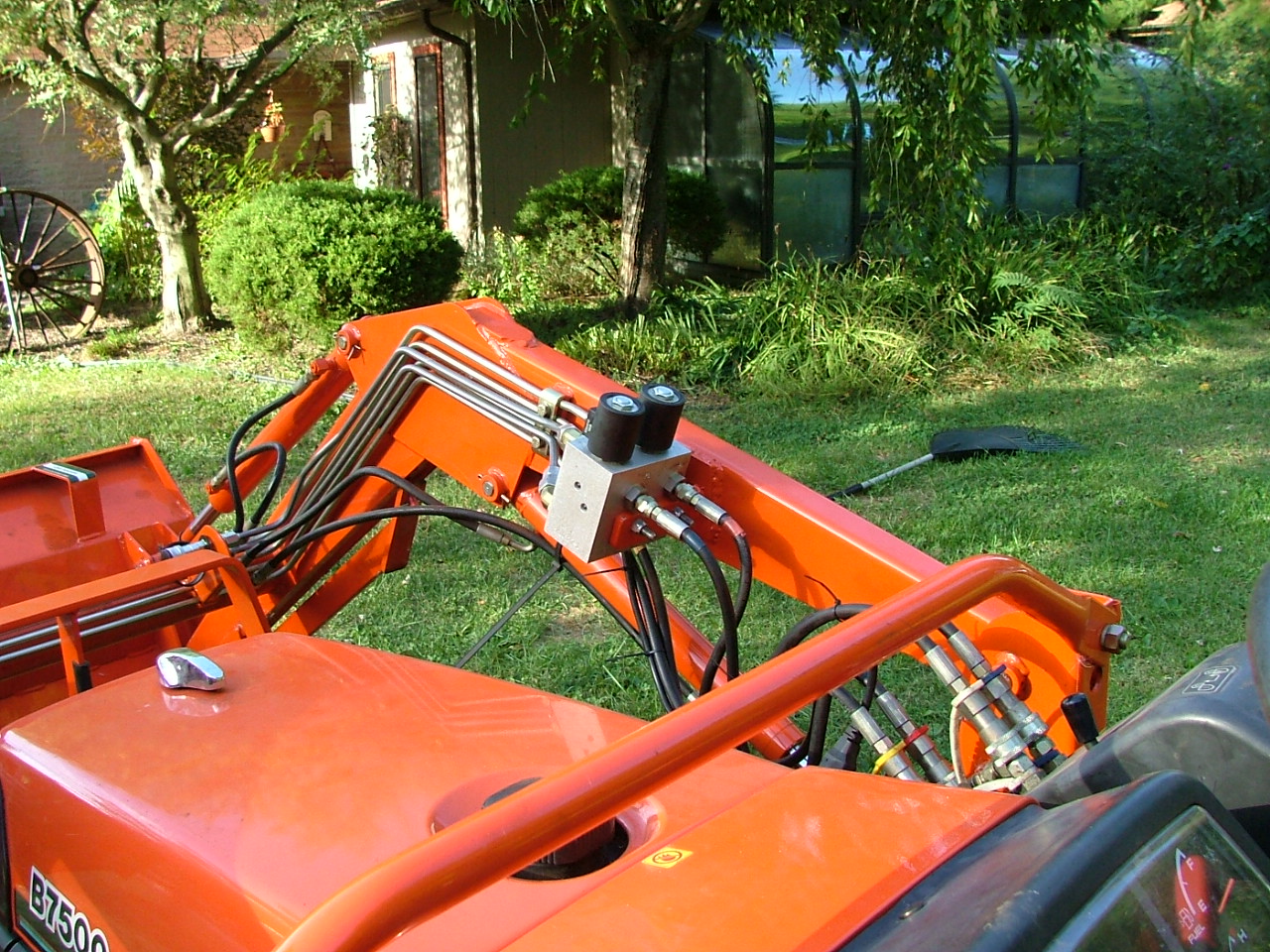

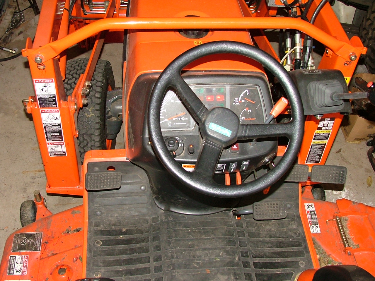

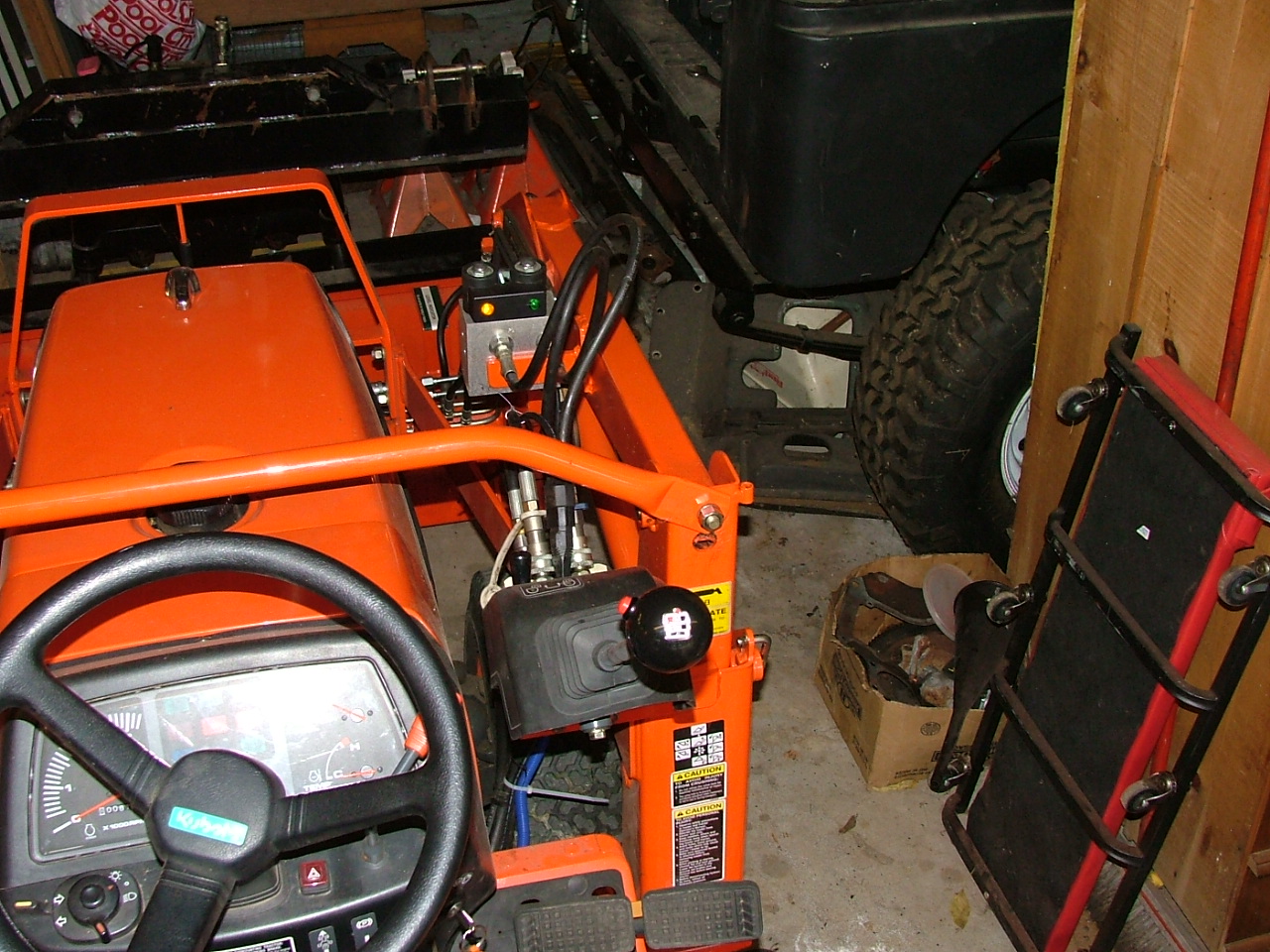

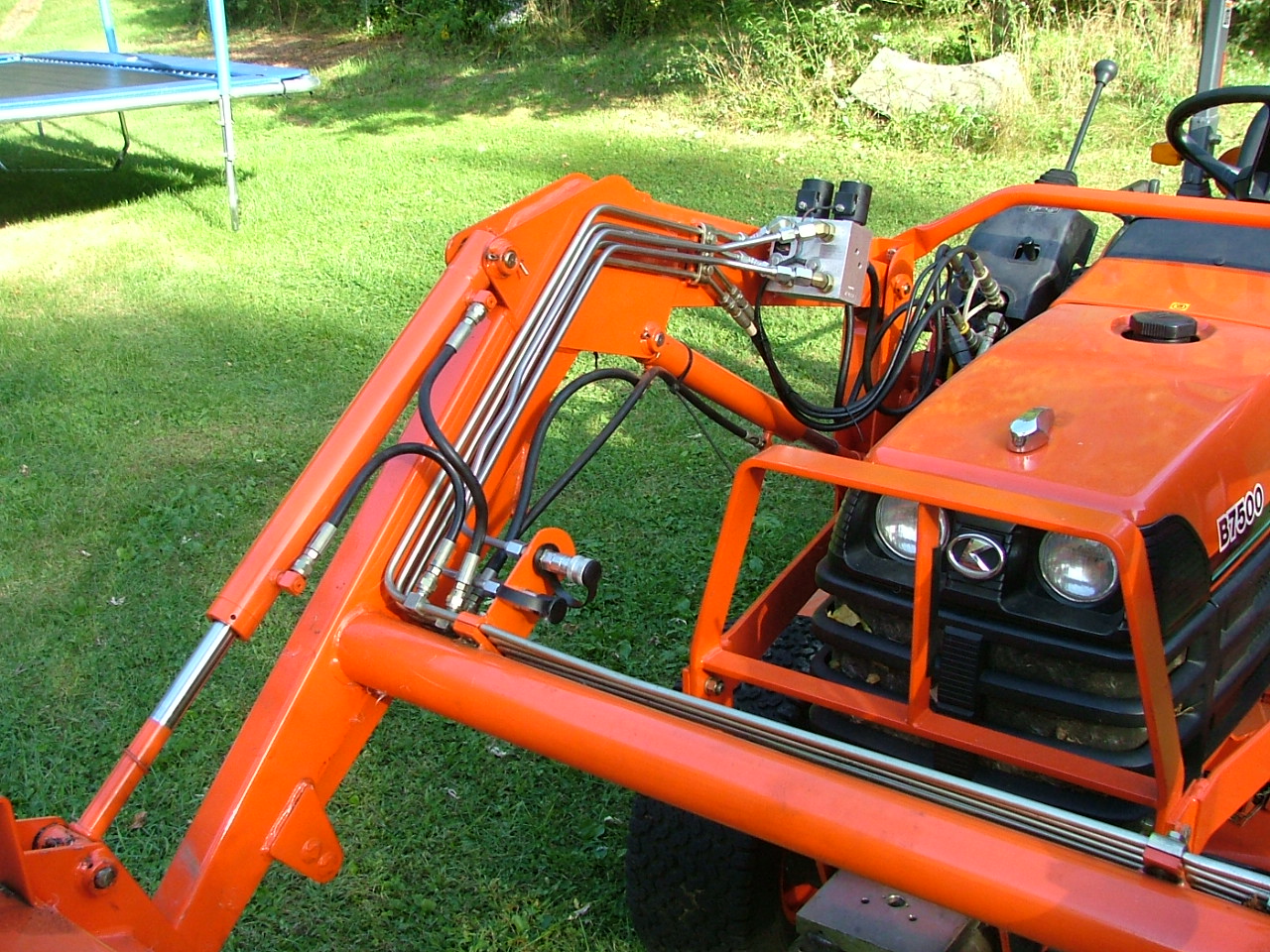

Here are a few pics of my installation, it shows my joystick mounted momentary switch, dashboard mounted toggle that is wired in parallel and the last ones of the valve mounted on the FEL and quick connects on the cross tube. If you need any info on how I wired or plumbed my setup just let me know.

I also agree with the thumb operated pushbutton, I have both a toggle on the dash and push button on the joystick wired in parallel. I don't think I've ever had an occasion to use the toggle. The Hurst shifter knob with NOS button works perfectly.

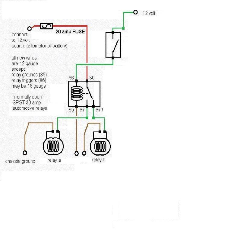

I used a relay so that when the switch is open the relay suplies power through the NC contacts, push the button and it goes through the NO contact

JJ - I understand that, tyring to get an example of proper setup.
DonT - Sounds like you have the same valve as me, as i'll need power in both direction also, but i would like to use that same Hurst shifter you used, i like the idea of having i built right in.
So could you tell me more about your wiring, with a the relay setup?
