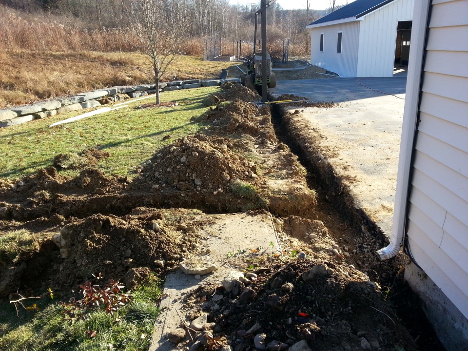

Anyway, spent a couple hours this morning filling in all the trenches and repairing the sidewalk, so my wife is happy. :thumbsup:
