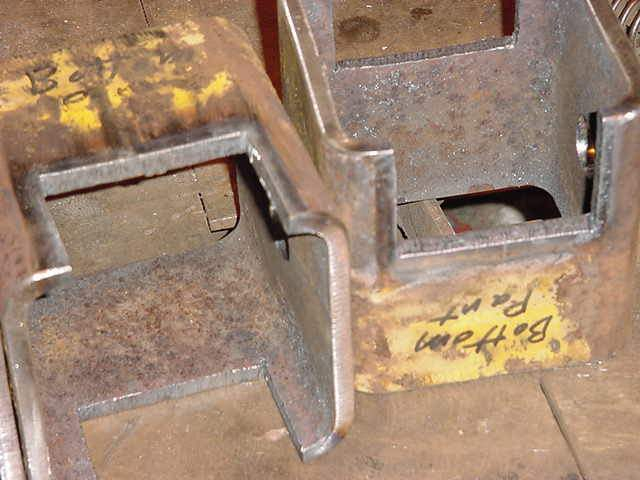

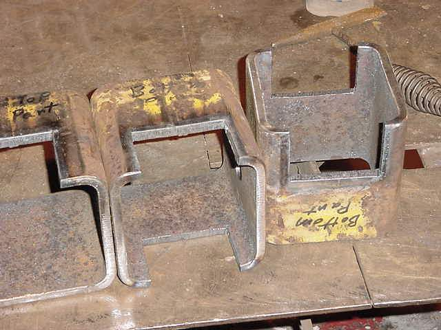

Torch can be fairly precision and it gets be
tter than this with a little practice.
