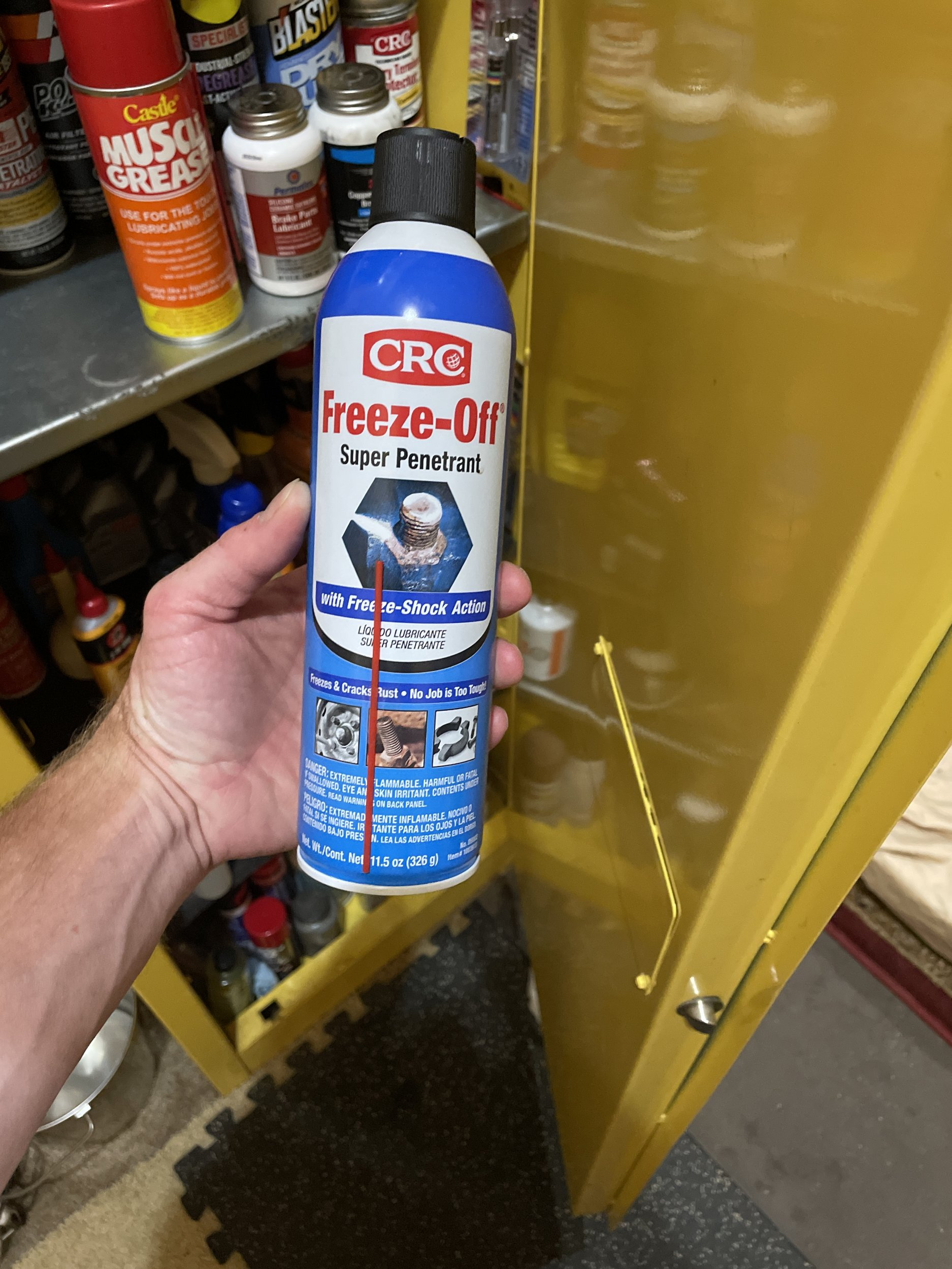

The next best option other than PB is a can of “Freeze Off” by CRC. You can hit bolt with a standard Propane Torch or even spend a couple extra bucks and use a can of MAP Gas (with the appropriate torch). Once it’s nice and glowing red (as should be the tip of the MAP torch if you’re using it correctly) then spray some freeze off and let science do its thing. Try this a couple times and you will be pleasantly surprised by the outcome.
If trying to use a 1/2” wrench on the blade bolts for a bush hog or in your case flex wing mower, no amount of heat is going to help. Those (like your backhoe) are “big boy bolts” and are secured around 200-400 lbft. That’s when an air impact or 3/4”-1” breaker bar with a long cheater pipe attached to it is needed.
