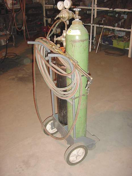

Buy a larger set of bottles. 125 O and 140 fuel. This will let it run larger cutting tips and some limited heating. You definitely should get a real torch, I have an anxity attack if I get farther than about 50 ft from one.
/ Educate me a bit on torches #4
Buy a larger set of bottles. 125 O and 140 fuel. This will let it run larger cutting tips and some limited heating. You definitely should get a real torch, I have an anxity attack if I get farther than about 50 ft from one.View attachment 710814
I've had a set of tanks this size since I was 18, so about 42 years. Sometimes I don't use it for 4-5 years, then I'll use the heck out of it for several months. I don't think I've had the tanks filled more than 4-5 times in that period. I did replace the regulators after about 30 years. It's one of those tools that most folks rarely, if ever, need. However, it sure is handy when you do need it.
