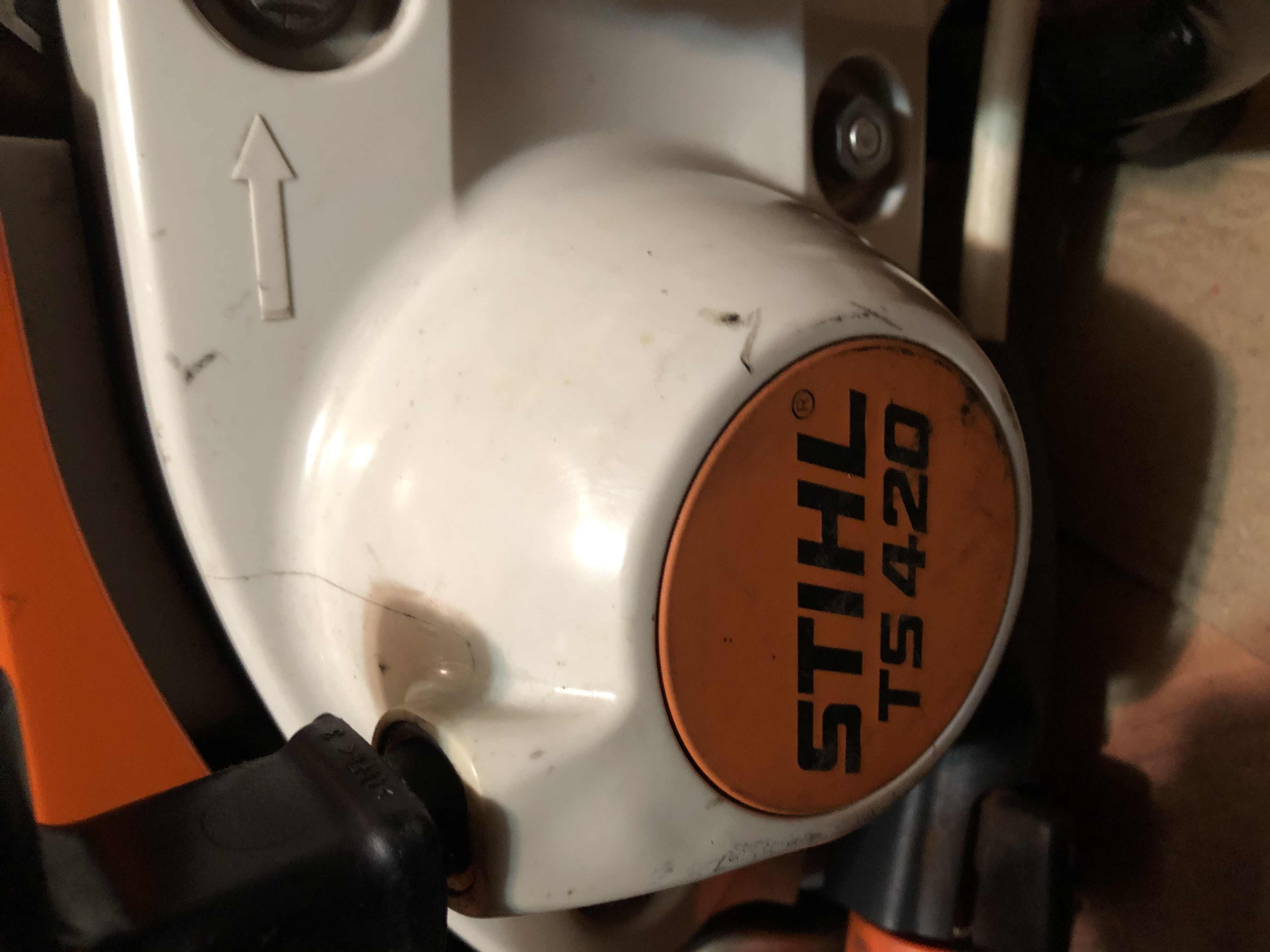

I had to get my Stihl TS 420 cut off saw out the other day after it’s been setting up over a year. Was thinking about all the hard start posts in this thread wondering how difficult it would be to start that engine. It has always been easy to start but it was left with some fuel in it so I was expecting some trouble.
Poured some fresh MotoMix fuel in to freshen up the old fuel and couple pulls and it fired right up. Ran a little rough at first but I let it idle awhile and reved it some. Shut it off and started it up then used it about an hour pretty constantly cutting some pipe and it never faltered. That thing is a pleasure to run and use!
