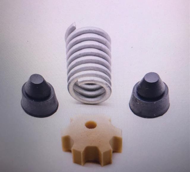

Never did it but seen guys in my group doing them. Parts in list in pic.
Google is your friend for such. Hopefully this guy helps. I'm not proof watching. He is using that pricey kit they sell.
   / New 500i #43
Oh nice I’m gonna get that for sure! Thanks for the link!
