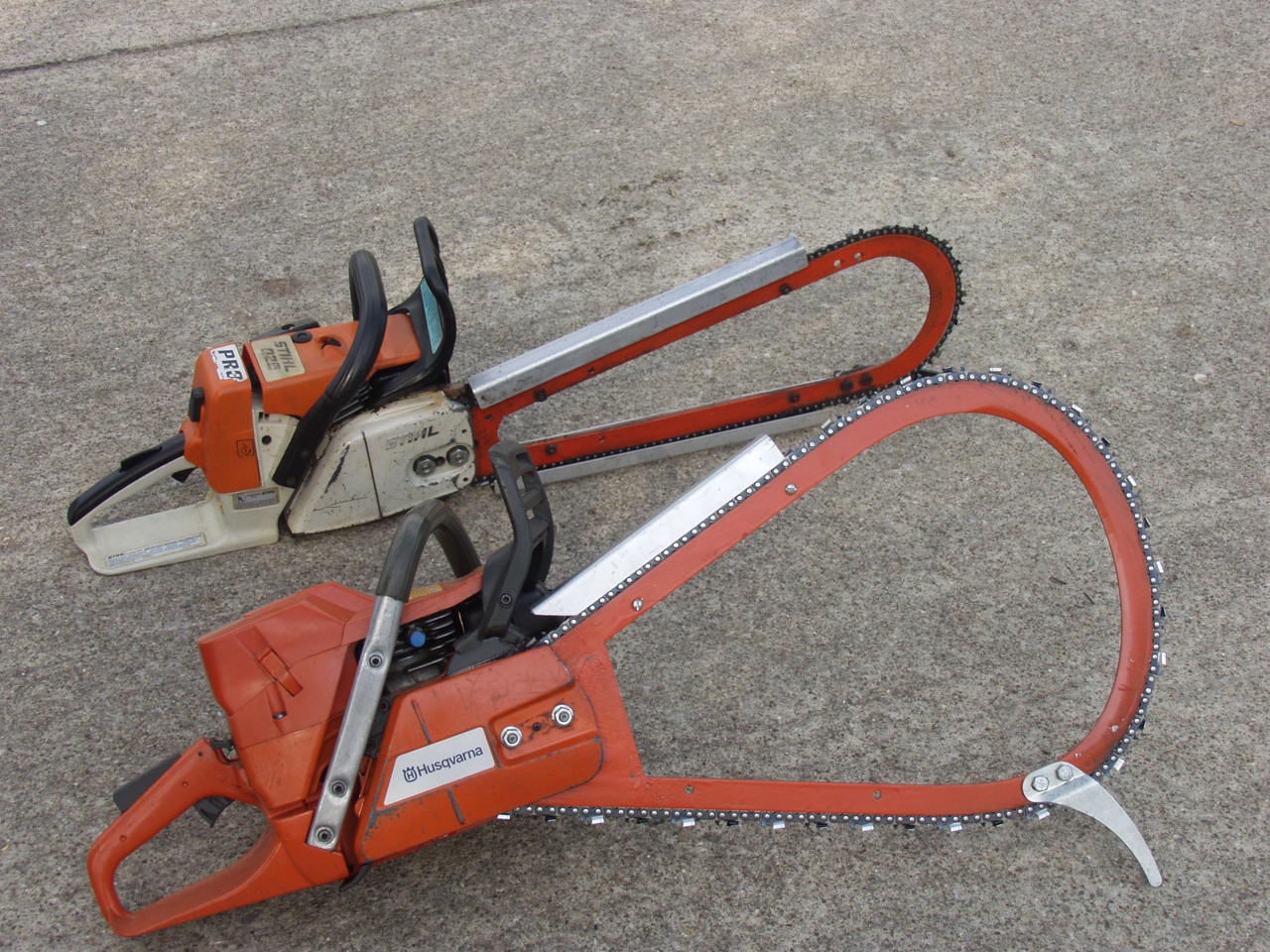

Local friend put 2 bows on some saws I sold him for same reason. Not bending over.
Husky was stock and 026 was ported.
I tell you what running the 371 372 saws even stock with a bow is scary as heck. To me bows belong on slower older saws.

I totally get the reasoning behind the design of the bow you show mounted on the Husqvarna, I've seen them used before, and they have their place.
But what's the purpose of the bow shape you show on that 026 PRO? Looks like it's combining the worst features of both types of bar design.
I thought a bow saw was for brush clearing? I’ve never actually had one. Why would you want one on a 327xp?
Back when I owned and operated a tree removal company, I had one on a Poulan and I kept it maybe 2 months are sold it. I didn't like it at all and candidly didn't like the powerhead either. That Poulan was prone to vapor lock and I didn't have the time to be dealing with it so I got rid of it. Fine for bucking logs but that is about it and they can be dangerous too.

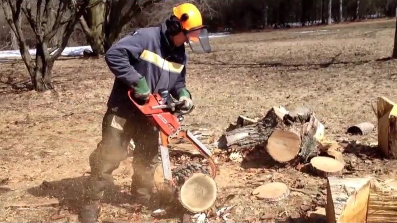

I've always seen them used for bucking logs on the ground from a standing position. Specifically the ones with the spur type dog on the lower edge, used as a fulcrum, like this:

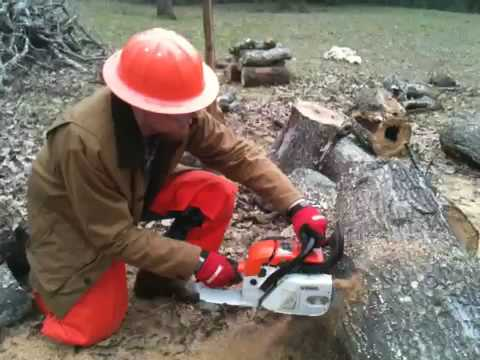

Versus having to squat to safely use a standard bar:
Or even worse... bending:
I've never seen them used for clearing brush.
I wouldn't.
I took a few minutes to watch them on YouTube. I can see the appeal for cutting smaller diameter firewood on the ground but the vast majority of the users were sticking them in the dirt to finish the cut. My mini excavator fixed the bending over problem and the sticking the saw in the dirt problem. It seems like a bow bar on saw with the power of a 372 would want to run off the log into your legs and be a death machine. Even with a small saw I imagine the injury rate would be considerably higher on a number used basis.
