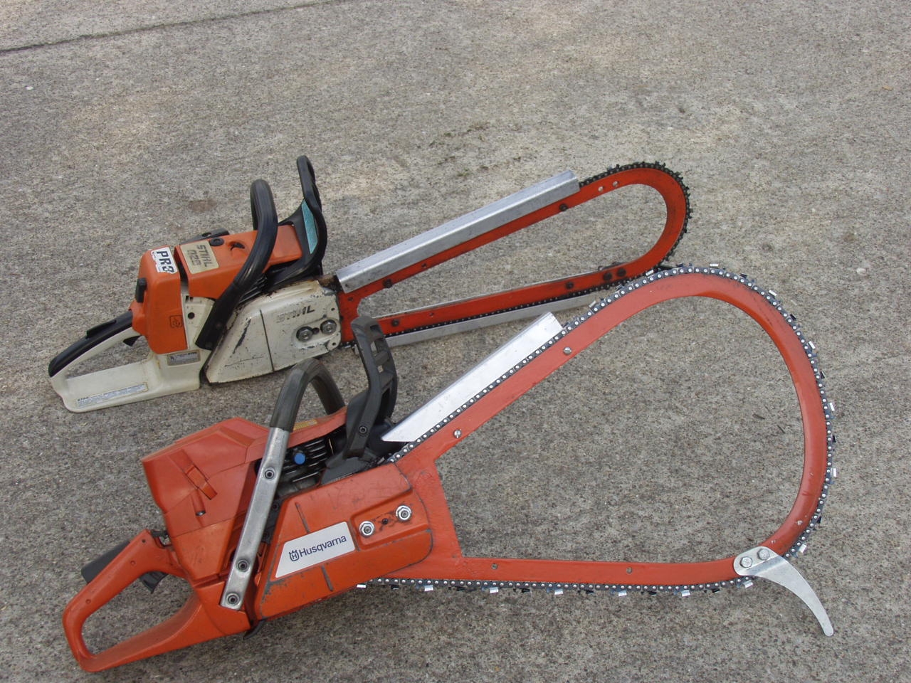

It seems like a bow bar on saw with the power of a 372 would want to run off the log into your legs and be a death machine. Even with a small saw I imagine the injury rate would be considerably higher on a number used basis.
Recoil will pull the bar away from you, not push it toward you. That's why they usually have a spur on the lower quadrant of the bow, to keep it from walking away from you, as you press it into the kerf.

Local friend put 2 bows on some saws I sold him for same reason. Not bending over.
Husky was stock and 026 was ported.
I tell you what running the 371 372 saws even stock with a bow is scary as heck. To me bows belong on slower older saws.
When I was on thinning crew in Arizona we ran bars like the one in the back, but with full guards top and bottom. The trees we were cutting were 8" and under. The bars worked well and were very safe (for chainsaws). With the stinger seated and the chain cutting I could take one hand off the saw and use it to push on the tree. I once tripped and fell backwards with the running saw landing in my lap. The chain didn't even touch my chaps.
The design means less bending over but we constantly got complaints from the cat crews who were piling the slash that we were leaving pointy stumps.
