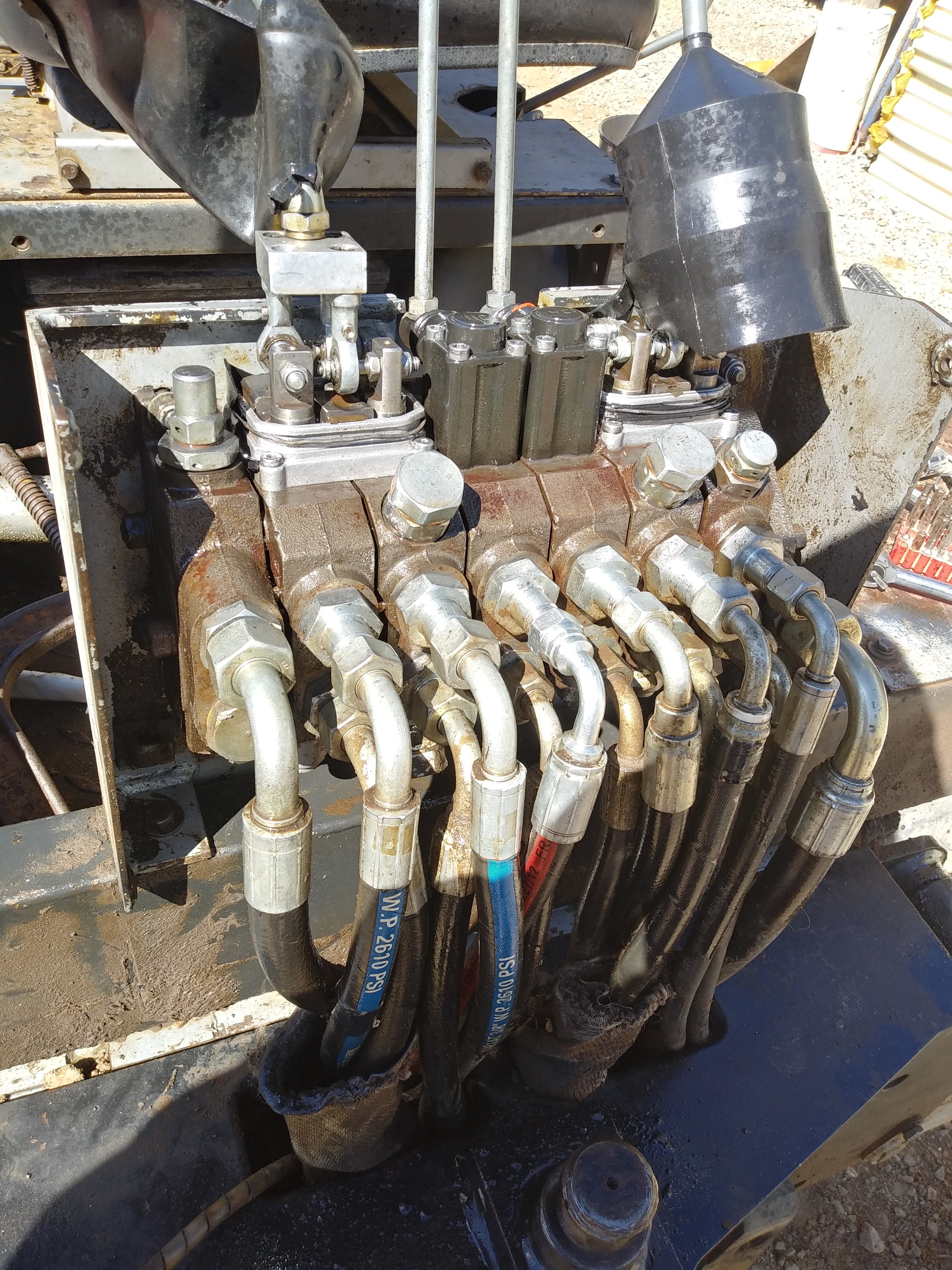

So I have one, have had it for years, and every time something breaks it is a nightmare. Of course I am the worlds worst mechanic, combine that with an orphan machine and....
I need to find the linkages for the spool valves controlling the hoe, mine are badly worn and disaster is near. Oh and boots also. They look like the pics, any ideas?
/ Earth Force EF2 #2
The joystick linkages look like a simple Heim joint. You'll probably never find a new OEM part from everything I've read about Earth Force. I'd bet with some basic measurements taken from an old linkage, you can do some online searching and find a compatible "generic" Heim joint.
As far as the boots, I'd probably start by searching Google for control valve or shift boots and see if you can find something similar.

Thanks Darryl I will look for Heim joints.
