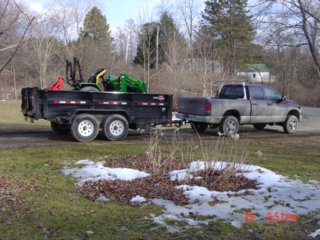

Back in September, I rented a bumper pull 7x12 10,000 lb twin cylinder telescoping Bri-Mar trailer, my wife was so impresses with the whole thing that I got the O.K. to buy one. After a couple of weeks of research and pricing I came up with two models by Load Trail a 8x14 14,000 deck over bumper pull with removable sides for around $6000 Tandem Axle Dump Trailers and a GN 83”x14 14,000lb for $5400 14000 lb Tandem Axle Gooseneck Dump Trailer - Load Trail . They both are equipped with scissor hoist, ramps and three way tailgate (Barn door) electric brakes on both axels. Everything you need to include battery charging. I purchased the GN and it came with an Interstate Heavy Duty Deep Cycle Marine Battery.
I had not put the trailer to the test until this past weekend. I loaded it with some wet soil and rock. The soil was wet enough it almost dripped. After I got the trailer loaded it started down pouring. Nearly a half-inch rain fell during the 25 miles to where I dumped it. When I opened the tailgate and my wife started lifting, the soil came out like sloppy mud. Once it started to rain, I knew the trailer was going to be overloaded, I had to take and off load.

No, it may sound like a sales pitch but I am really satisfied with the quality of the trailer. I researched a lot of different brands and like most people wanted a fair price and a quality trailer. After I found the two brands that were equal, I started searching for the best prices then I had to decide on bumper or GN that was the toughest decision. If I went with a 14ft GN I can haul my JD 990 but with a bumper hitch I could always have my wife bring it somewhere with her suburban. For the weight capacity I was concerned about hooking it to the receiver even with a 2 5/16 inch ball. After last weekend I am glad I went with the GN I don't think the bumper hitch would have been safe the longer it rained.
