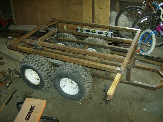

I'm posting some pics of progress I made last night.
I put some angle braces into the subframe.
I had some braces all cut out to weld accross the subframe from side to side, but as I was getting ready to put them in place I realized that there was no place to put them that wouldn't interfere with the axles or the ram. So, I cut some triangles out of diamond plate and put them on the back to stiffen it up a bit.
The last picture is just one of the whole thing done for the night.

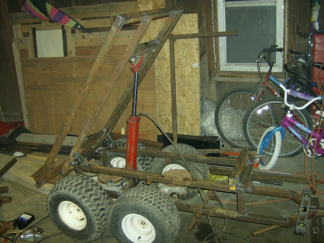

I hung the rest of the peices and sprayed them.
Spraying is way better!
I think I did use more paint, but it was a lot easier, and a lot faster.
Pic 1 below is of the pieces prepped and ready to paint. I used a flap wheel on most of the metal this morning. I used a wire brush to get into some of the corners and hard to reach areas.
Pic 2 is of the pieces after the first go round of painting. I painted them as shown, and waited the requisite 4 hours for a recoat. Then I flipped the pieces all over to get at the surfaces that were on the undersides.
The can says to to wait 7 days before washing, so I'm going to leave the pieces hanging as long as I can.
