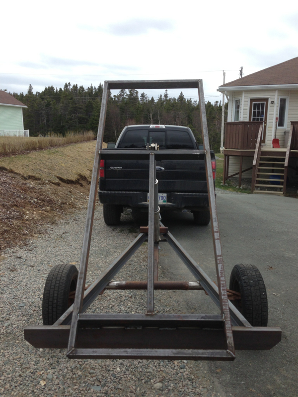

Have been wanting to build a dump trailer for sometime to use with the tractor and with the truck. Not looking at hauling tons of material but maybe 3-4 bucket fulls from the loader.

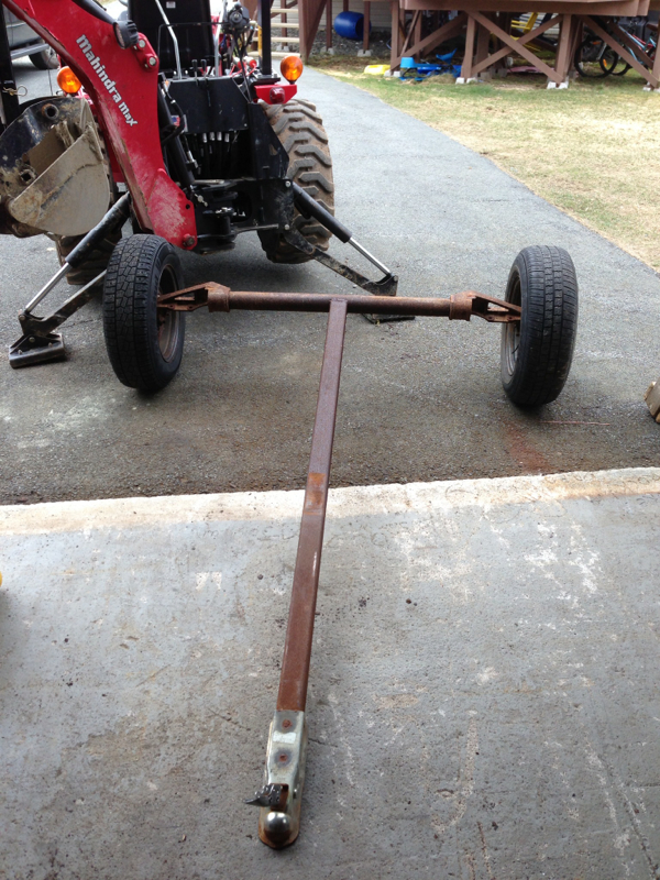

I had this axle lying around and had built a wooden box on it one afternoon to haul kids back to a scouting camp for the weekend
Hauled the box off and started working on a proper chassis.

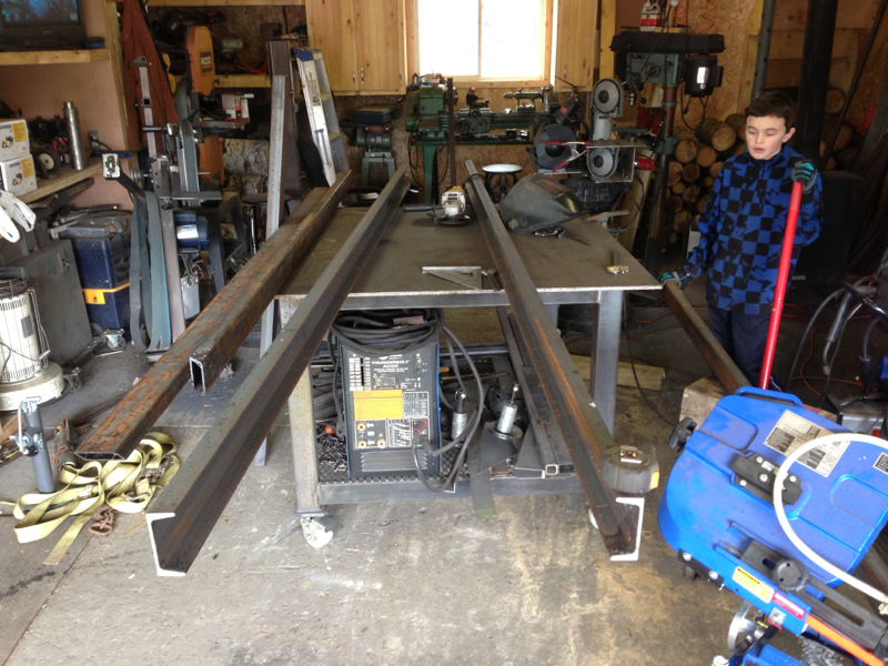

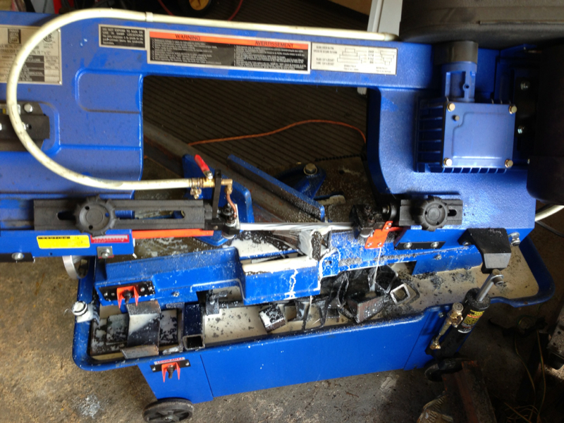

The bandsaw is so much nicer to use over the abrasive wheel chop saw.

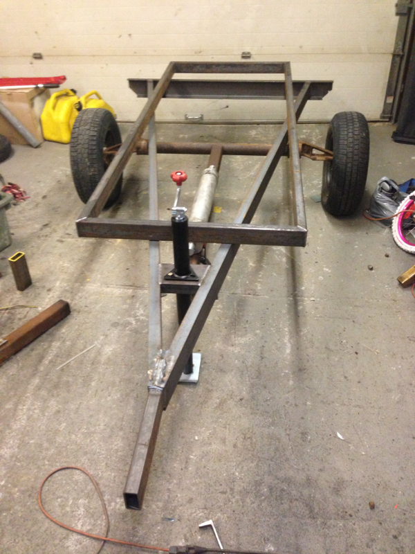

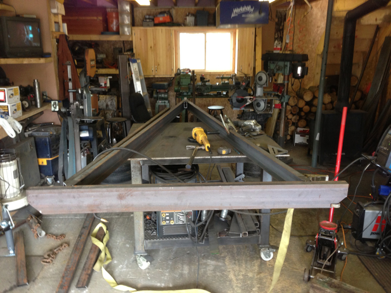

Laying out the chassis with 4" channel.

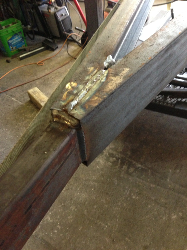

Welded up and ready to drop on the axle. This trailer will not have any suspension.
Picture of the welds and the front end of the trailer.
Everything laid out on the axle.

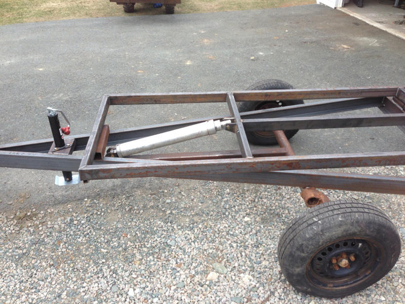

The ram is a two stage and came off an auto hauler trailer.

Nice start! Wow that band saw beats the heck out of my 20 yr old HF 64.5" band saw! Welds look good too! How are you going to power the hydraulics?

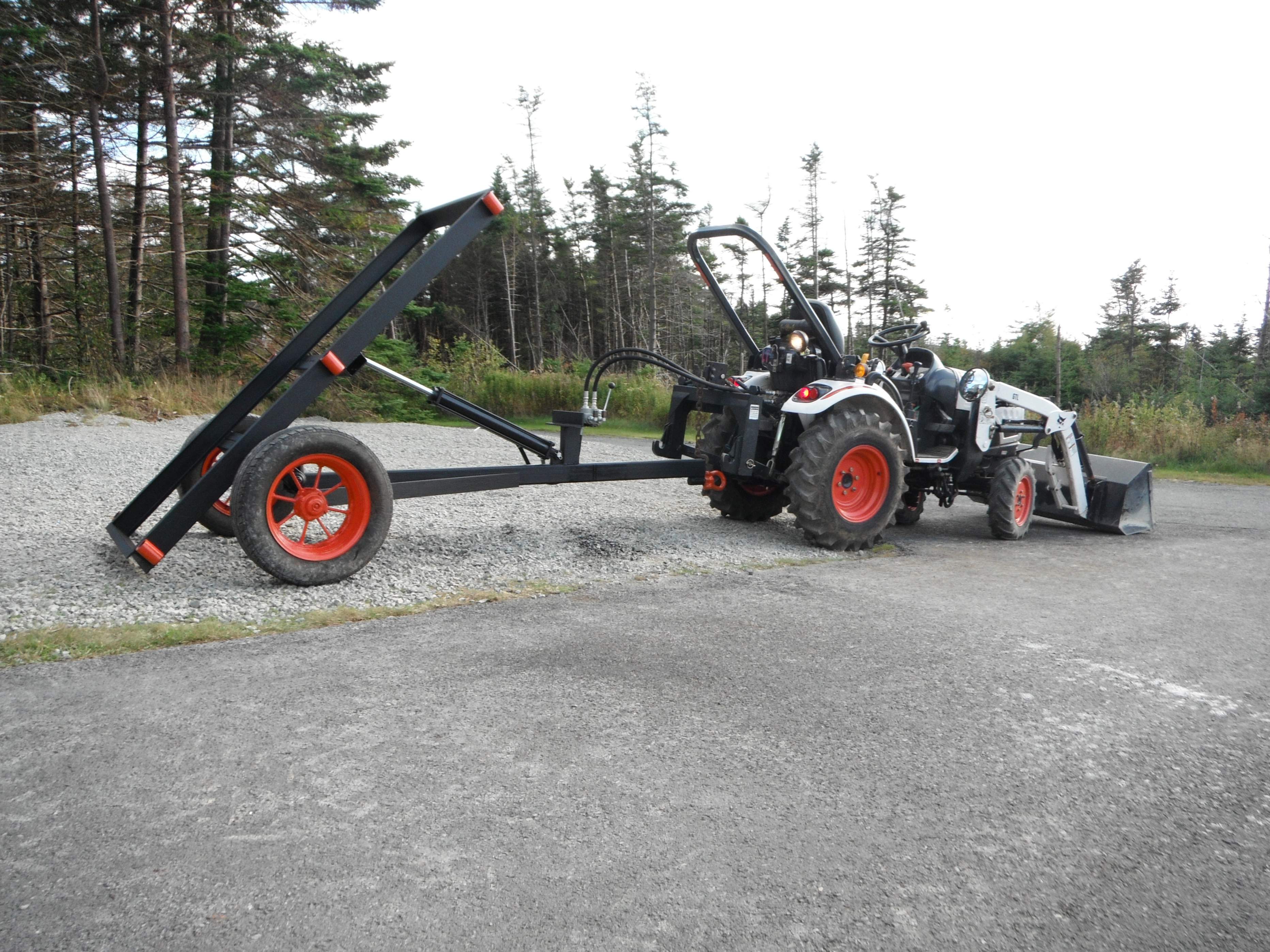

For now I am just going to run the hydraulics off the rear remote I have on the tractor. I may add a 12V pump down the road so I can dump it with the truck or my SxS.

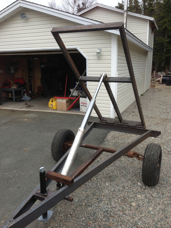

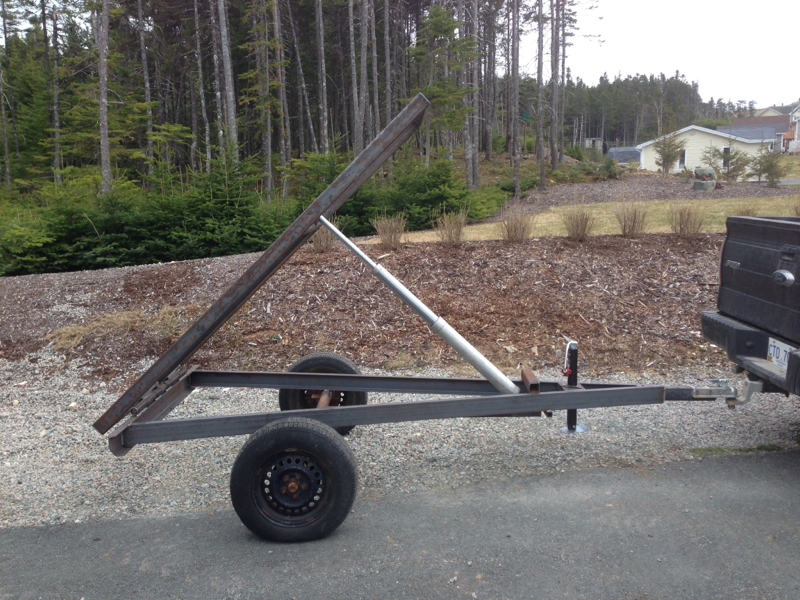

Got the hinge built and mounted the ram. Still have to add some bracing and then start building the deck and sides.
The ram seems to be at a good angle.
Full extension
Real happy with the angle. Should make for easy dumping.

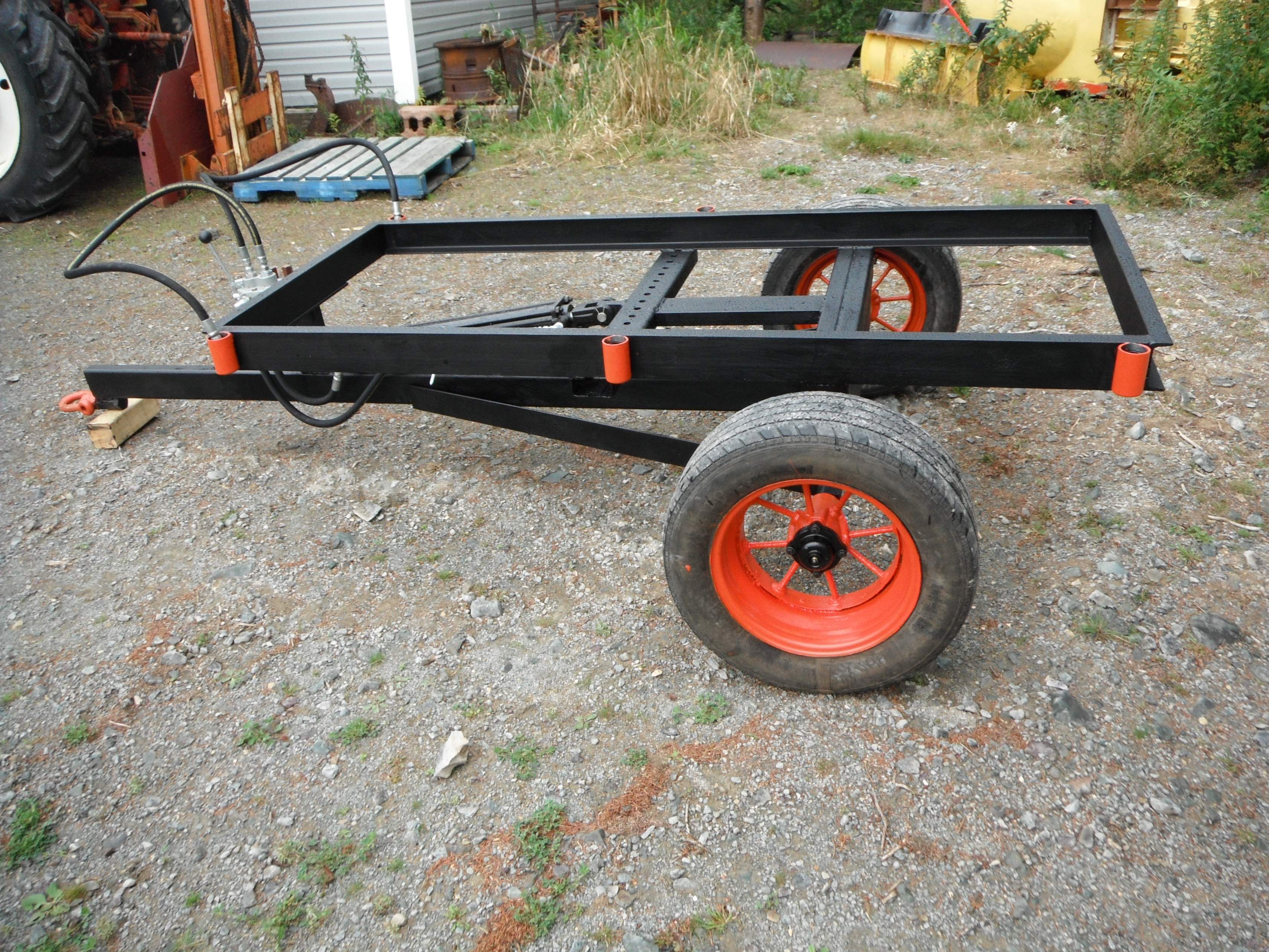

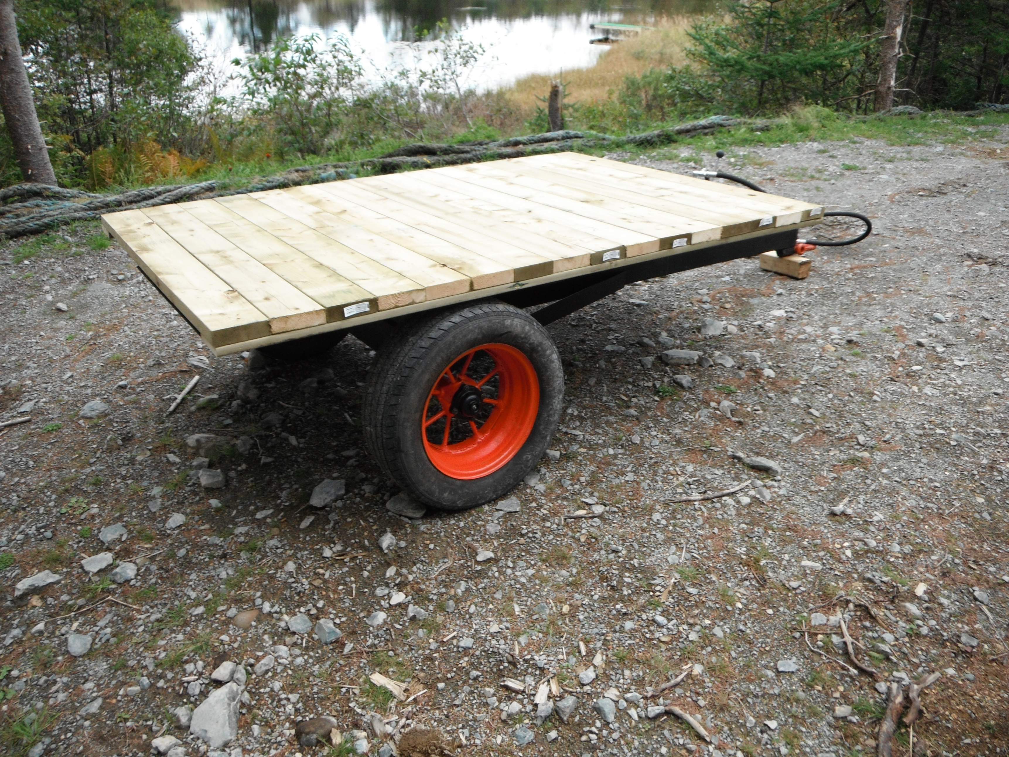

I am going to put 1 1/4" square tub on top of the frame and add a 4' x 8' sheet of 1/8" plate for the bed. The front and rear will be about 2' high with the sides being 12" high with pocket built in for 2by lumber. I am still debating on making the sides removable. The trailer is not heavy enough to carry to big of a load so I don't want to build it with to much compactly into it. I also have two other trailers so if I need a flat deck I can use my other trailers.

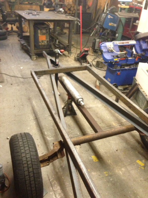

Started welding up the deck. Almost got it all welded and ran out of wire. Will pick some up tomorrow and finish up the welding and adding some bracing. Hopefully it will be ready for paint by the weekend.

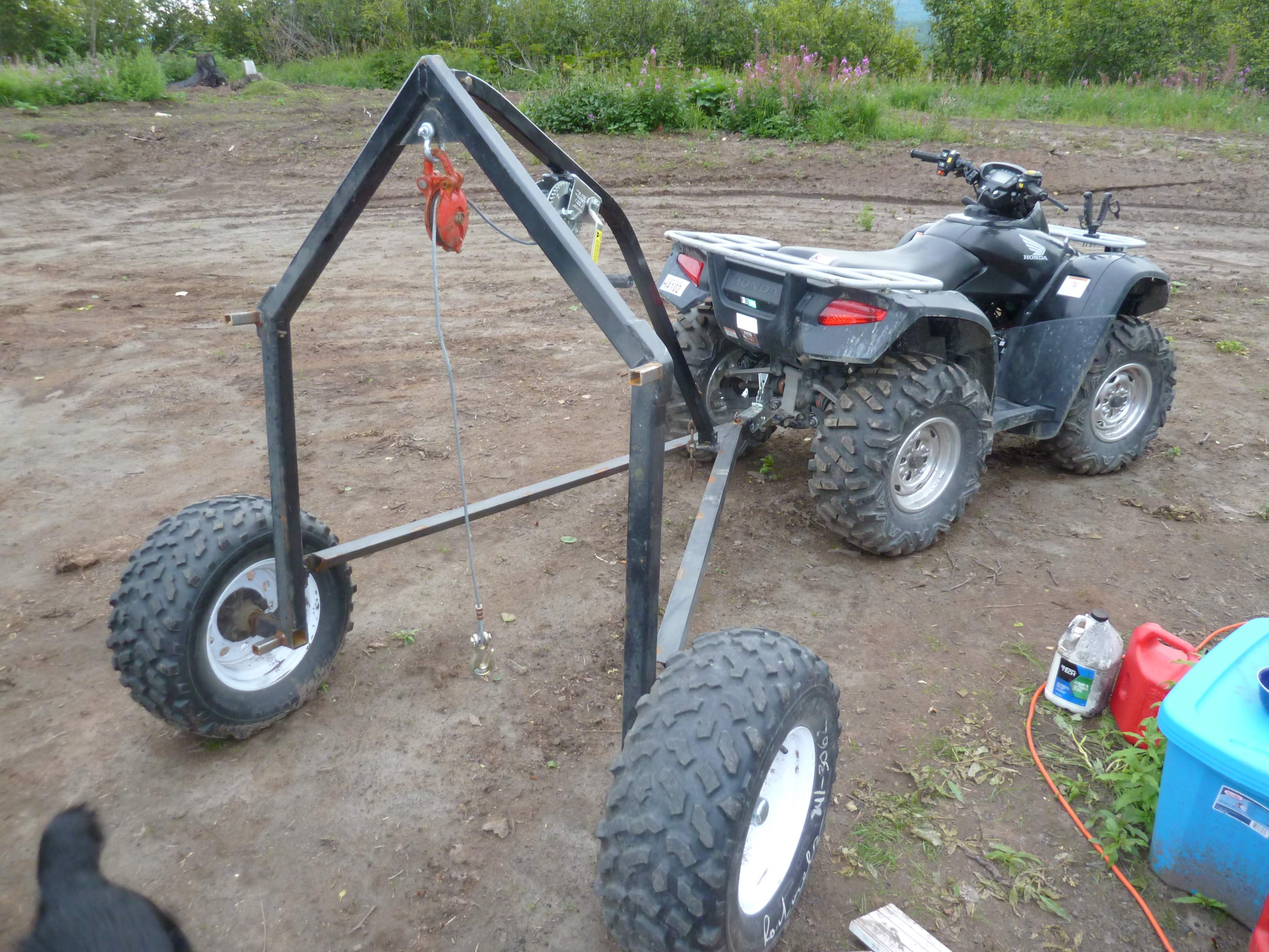

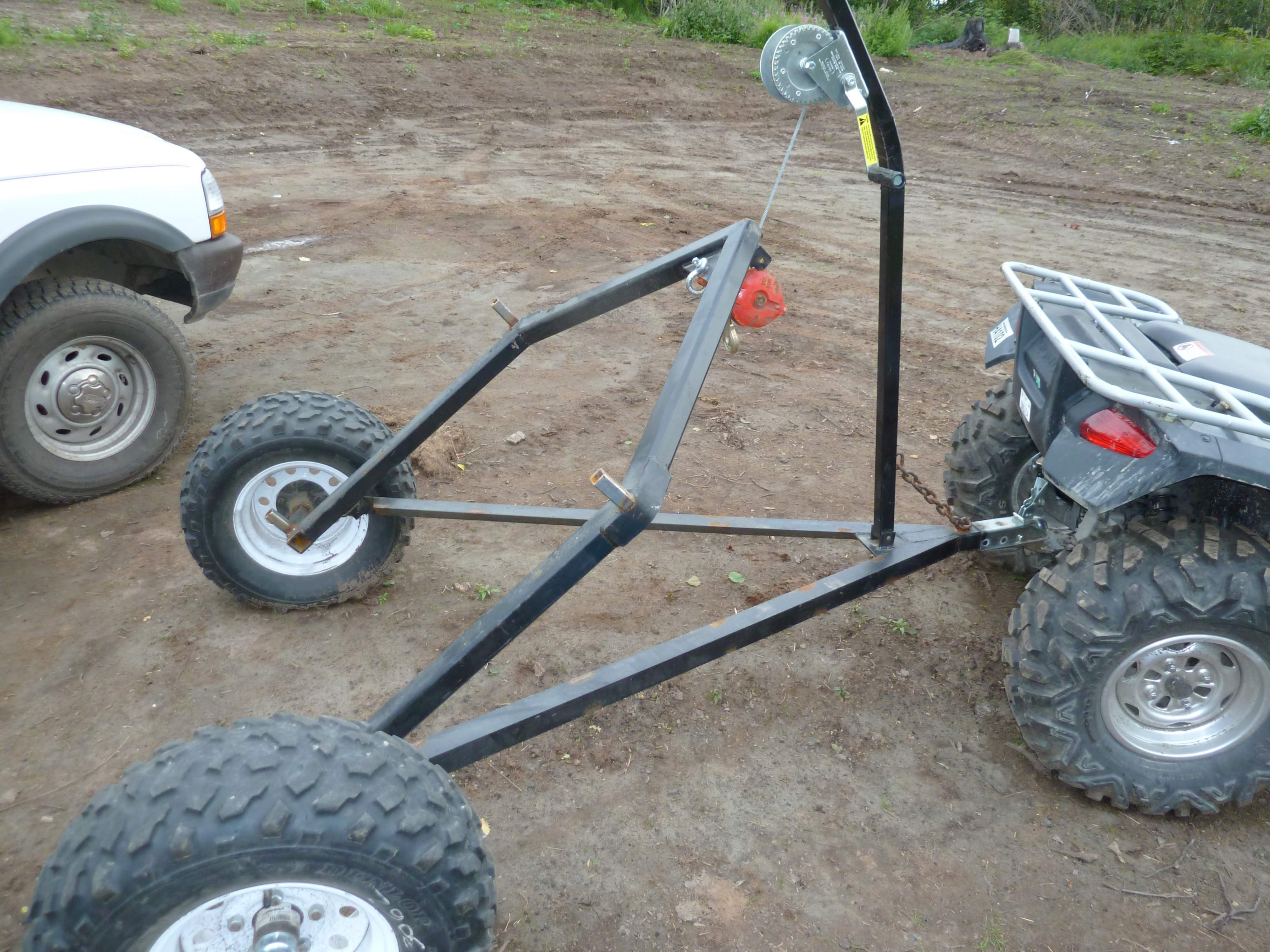

This is a smaller unit I built. Has a larger one with hyd lift for a tractor but since sold. Have a couple of these and for around home it is great. You can see the pegs for the bed to sit on and when lifted with the bed off and the winch arm connected to the arch makes a good log getter.

I really like your design. I wanted to build a log arch for my dad and this would be a very good way of building it. Thanks for posting.

A little more done tonight. Hope to have it all done this weekend and maybe a coat of paint on it. Found out that the cylinder which has an aluminum body has a striped fitting. Need to take the cylinder apart and either add some material and re-tap or drill it out for the next size fitting.
