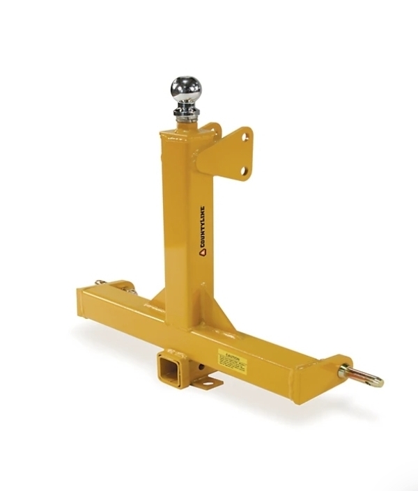

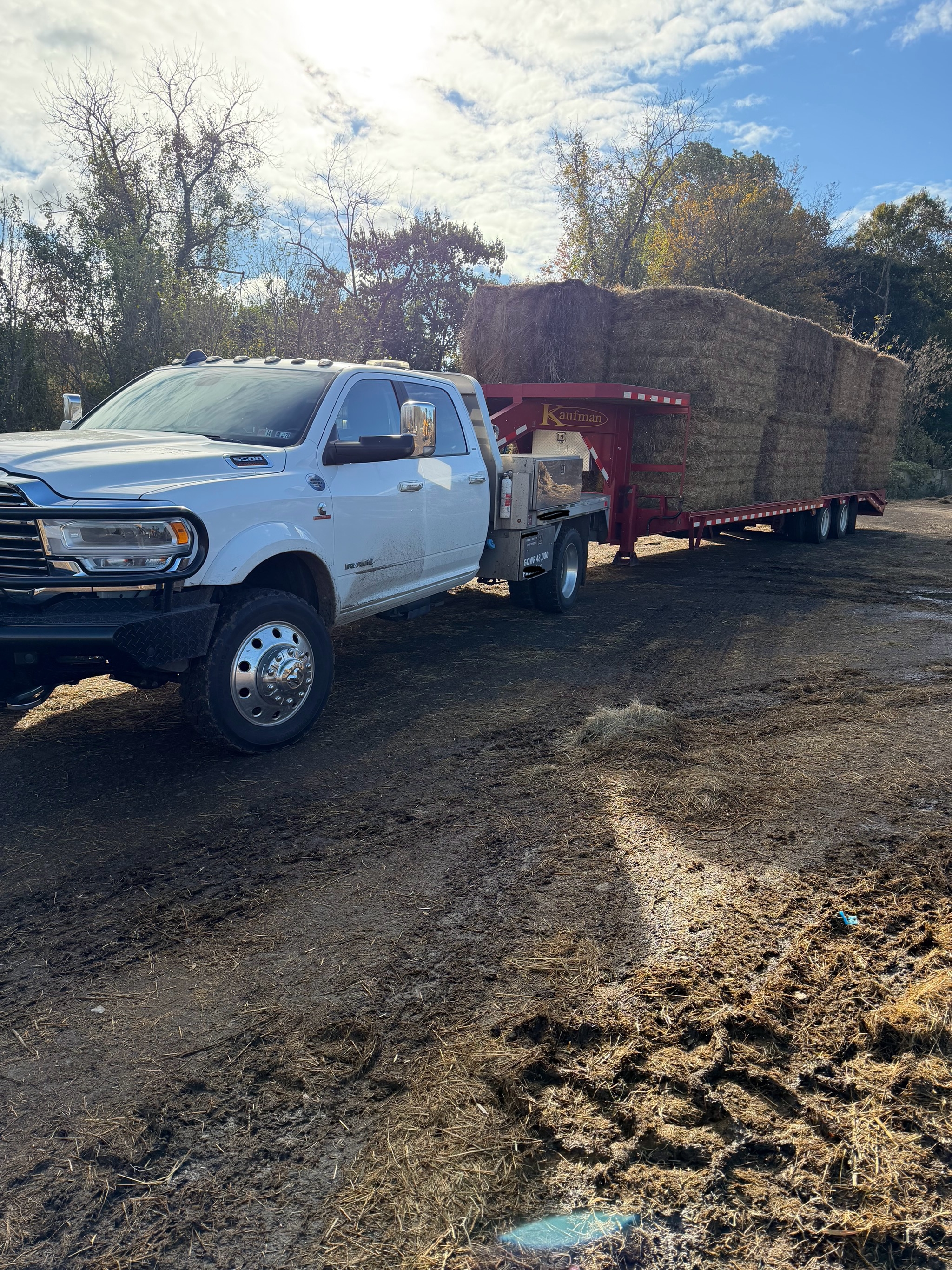

GN every time. I pull a 32’ 25k gooseneck with my F-250 quite often. There is no comparison in stability. I move my goosenecks around with my FEL all the time. i also have the 3 point attachment to move them around with but if you are putting a trailer in a tight spot nothing beats the ability to have it in front of the machine to spot it dead on. i run all over the farm pushing my single axle bumper pulls in front of my UTV’s.

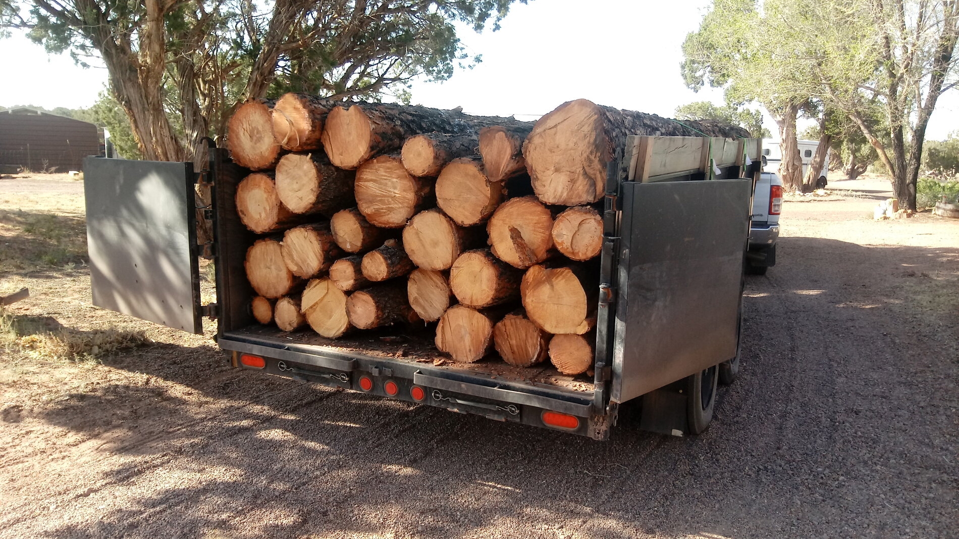

Just an FYI, I know you didn't ask, but:) When you load logs, try and get every face/sidewall log, to rest on the log under it, all the way to the floor. Avoid wedging them against the sides.
