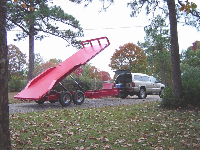

Yes that trailer is sweet Redbug, 20' 7 ton dumper, would pretty much handle anything you throw at it!
Did you have that custom made or is it a production model, what company?
JB.
/ dump trailer #23
Hi JB, Bobby,
It was a production model in the 18 foot size, and I asked them to make it a 20 footer for a few dollars more. I specified the headache rack height, adding D rings, spare tire, (which I welded a place for it underneith), color, etc. BMF Trailer works made it up in Wisconsin. They dropped it off for me free on a trailer run to a trailer place in Elkhart, and I went up and pulled her back home to SC. I used to live up at Kokomo, (in Indiana), so it was an enjoyable trip up and back. Lotsa corn up that way...

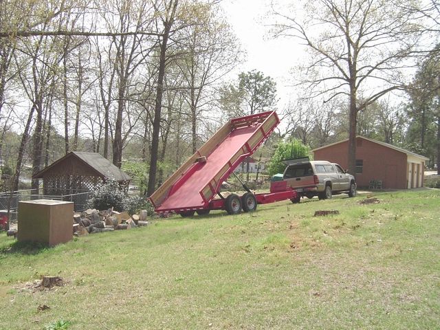

that looks close to being a deck over the fenders must be pretty heavy duty does it have a spring ride or a torqflex axle system
/ dump trailer #25
Hi Bobby, JB,
The axles are spring ride. I discovered that BMF trailers was bought out and is now called Big Lug trailers. I found their website. Need to use Explorer for best viewing. It is: Big Lug, Heavy Duty, Commercial, Equipment, Dump Trailers
There have been a few changes, but the trailer I have is in the FD series. Yes, the fenders are designed to be driven over, if need be. I noticed prices had gone up...probably because of the price of steel.

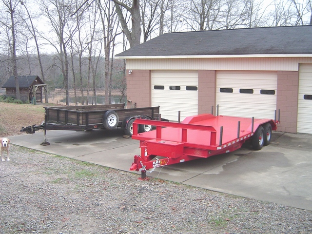

That is a neat trailer overall but it obviously has limited applications. I say that as the owner of a Bri-Mar tandem dually that I would not want to be without. I use mine to haul hay, bulk material of course and anything too long for my pickup. The only thing better would be a set of loading ramps.
I bought used and do not know about ramps on a Bri-Mar but I have seen them on the PJ's.
My only other comment is on the use of three axles and having to be a bit more mindful of them over say a tandem dually.

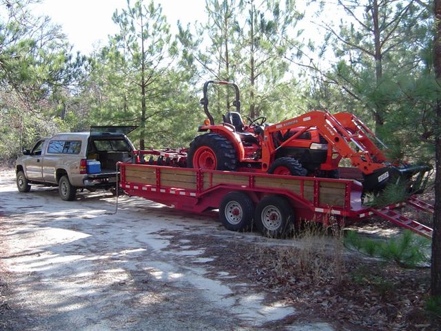

That is an awesome trailer. I am in the market for one and the 3 in 1 concept should pretty much do it for me especially at 20 Ft. Just curious to how well it pulls as a bumper pull with the tractor and attachments loaded. I am trying to decide between goose neck and bumper pull. I like the convenience of the bumper, but I understand there is quite a bit of stability added with a goose neck.
/ dump trailer #29
Randot,
For heavy loads I use a load distribution hitch with the trailer. Light loads...like a load of firewood or debris, I do not need the weight distribution hitch. I would suggest the goose neck over the bumper hitch. If I was not in love with a shell on the bed of my truck, I would have gotten the goose neck, (better turning radious, etc).

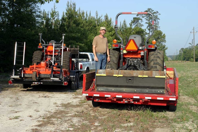

Thanks for the reply Redbug, I have an F350 to pull with and currently pulling a 20ft tilt bed with the same size tractor as yours and everyone is correct, it depends how you load it as to how it will ride. I also meant to ask about the removable sides. On the manufacturer's web site they offer 24" sides with barn doors. I saw somewhere in this thread someone saying that they might bend out ward with larger loads of gravel etc. Your wood sides look very sturdy, what is your opinion on the steel sides as to how well they will hold up to heavier loads of rock etc?
/ dump trailer #31
Hi Randot,
I would think the sides would hold up OK, as long as you don't overload the trailer, (and especially piling it up along the sides). Put your load in the center. You can ask the mfr. For wood debris and the like, it would be no problem.

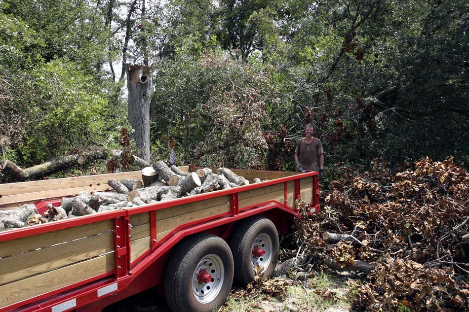

Here's a few pics of the spare tire bracket I welded up and the sides. I wanted the tire out of the way, and not in the bed. And showing the sides as I made them up. I used steel channel to go into the stake holders along the sides. I suspect that's what the mfr would do also, since their sides are removable, also. I can tell you that using the channel is real sturdy, and I have not had any problems. I did make each side in 2 pieces since a couple 10 foot pieces are easier to handle than one long 20 foot length.

it looks like the trailer would twist easy with the cylinders back as far as they are or the cross tube would bend under a heavy load is their a releaf valve in the hydrolic system for safety to prevent that do you know or is the hydrolic pressure set low enough to prevent that from happening. thats a good spot to hide your spair tire, and the removable side you made are slick:D
/ dump trailer #33
Hi Bobby,
I am careful about loading gravel or dirt very far forward, for just the reason you gave. For dirt, I only use the rear 12 feet or so. It works just fine filled all the way with debris, though. 6 or 7 feet high and a heavy tarp with straps. It's amazing what you can pile into it.
