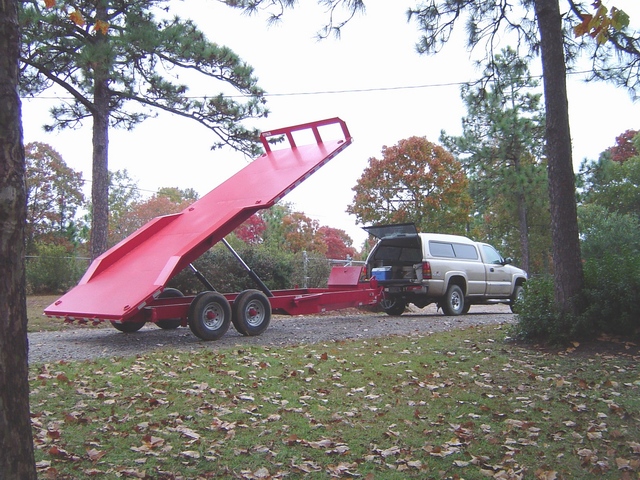

Here's mine, a 20 footer, 14k...When I got it, I welded up some removable sides which fit in the stake pockets, and removable rear door. I have been real happy with it.

/ dump trailer #18
RedBug
I have seen your trailer on here before. It has to be the most versatile, good for many uses trailer I have ever seen... I like that there seem to be no compromises. Its a good utility trailer, dump trailer, and car/equipment hauler that is not too small or too big and just the right height off the ground for easy loading. I would be proud to have that sitting in my pole barn if you ever decide you want to sell it.

/ dump trailer #19
Thanks Chris...A couple more pics...
