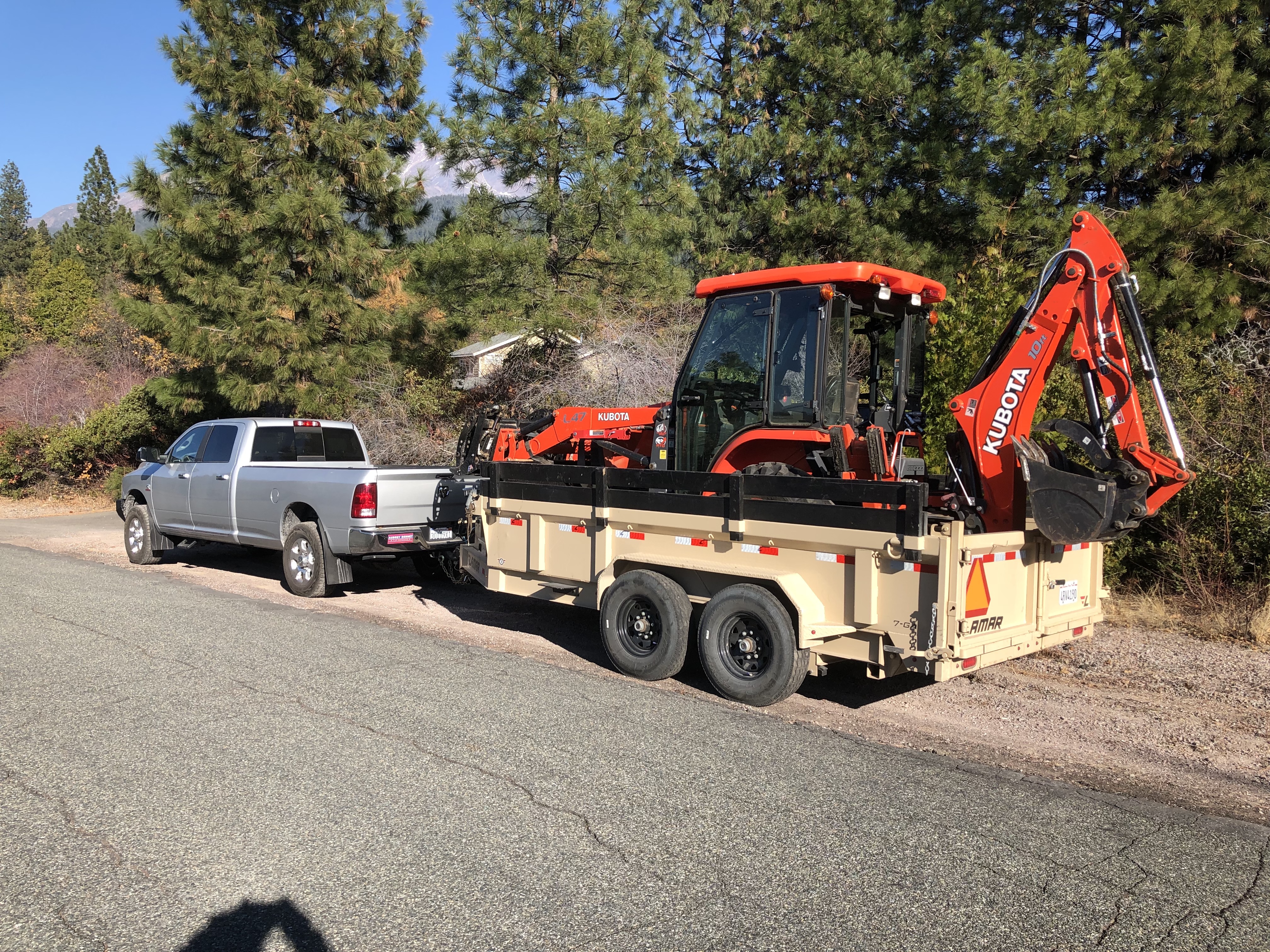

16' would be real tight. When I have mine in a 16' dump trailer with my loader and backhoe, backhoe jacked sideways into the corner and loader over the front of the dump box.... I had to turn sharp on switchback road and took out the tailgate, $600 OEM LED taillight and back corner of the bed. It was a $4800 repair.
If you do not have the backhoe, and you do not want to ever take a 3 point item with you, a 14' might make it with just tractor and loader with the loader inside.

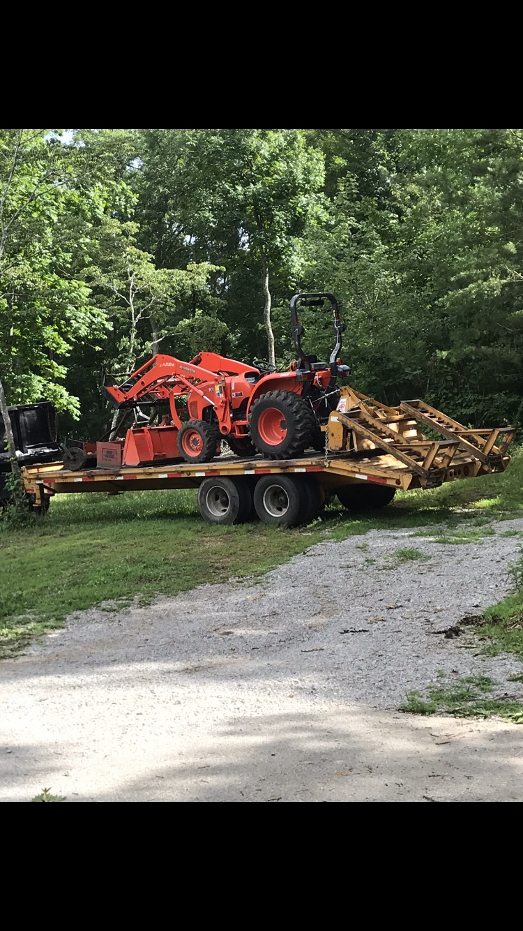

I haul a L3800 on a 16’ car hauler trailer. With the loader sitting on the front of the deck and a box blade attached it only clears the end of the deck by about 8”. If you didn’t have an implement on and backed it on and left the loader sticking off the back you might manage with a 10’ provided the weight distribution is safe. You really need a 12-14’ minimum without implements on the tractor.

Here’s the same tractor on my 24’ trailer. Implements fill a trailer fast. IMG_8395.JPG

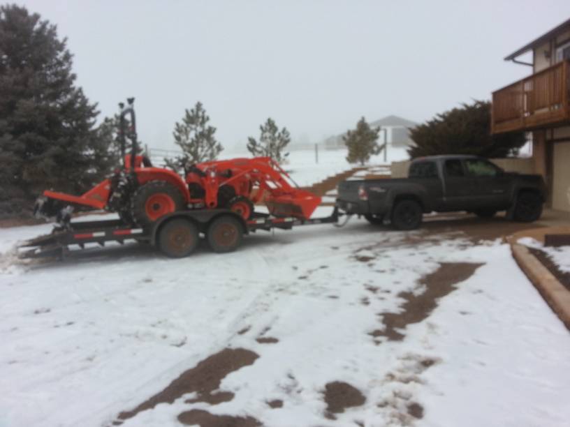

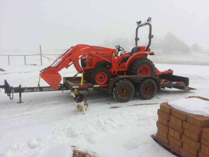

2,500lbs L3200 on a 16' trailer... only way it worked at all was because of the really long tongue to set the bucket on. Made it more like a 18' trailer to some degree. It wouldnt work loaded backwards due to ballance issues.
As others have noted, you'll be loading or unloading impliments by hand on one end if you are planning multiple trips to get things done. Not something my back or patience is capable of.IMG_20140209_103755.jpgIMG_20140209_110007-1.jpg
As others have noted, you'll be loading or unloading impliments by hand on one end if you are planning multiple trips to get things done. Not something my back or patience is capable of.View attachment 644057View attachment 644058
My car hauler could be an 18’ I’m not 100 percent sure. Looking how tight yours is and mine fits in the deck it would almost half to be. I’ve never had any balance issues with mine. The short trailer would probably work better backing on especially with loaded tires. The OP could load the implements in the dump trailer and go dump them off and then go back for the tractor. I agree it would be annoying but for once a year maybe not that bad. I’m not sure if you could haul it at all on a 10” trailer though. Maybe if you left the bucket off and left the loader sticking off one end.

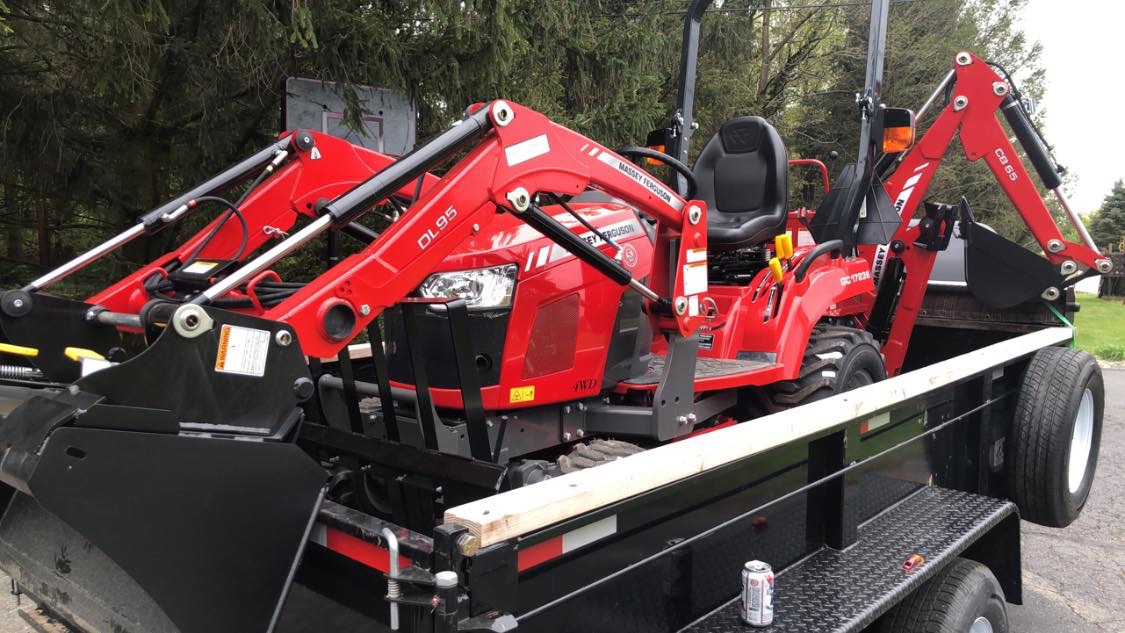

No idea what size your tractor is but that is a Massey SCUT in a 6x12

He's taking about a tractor sized slightly bigger than B2650. And you said you got your scut in there.... The loader and hoe are not in! He stands no chance at all.

Yeah, that’s why I posted it, so he could see what 12’ looks like. The hoe is actually in, it’s just the angle of the picture.
