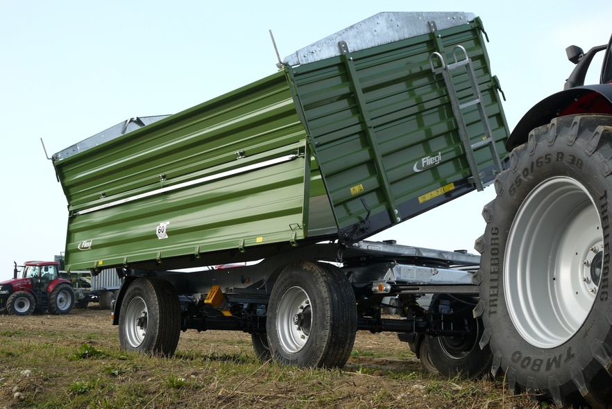

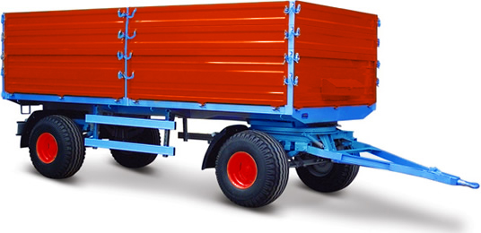

I plan on building something for my BX. Im leaning towards a euro style 4 wheeler. like a hay wagon. Since I only have one tractor, 4 wheels will allow me to park and load without having to deal with jacks. Plus I will be able to put more on a 4 wheeler because there is no tongue weight to speak of. This also means I can move a "heavy" trailer with my ATV. Something in the 4x8 range I think. These links are to larger ones, but the concept is the same. There is a manufacturer that makes a reasonably priced trailer kit that several have made, it has wood floors and sides, the manufacturer escapes me at the moment.
Whoa, that green one must weigh 2,500 lbs. If you put that behind your 700 lb atv, and wander down, even the most modest grade, you will be a "pile at the bottom of the hill".
Be very careful with that. We dont want anybody to get in trouble.
Yeah, as I mentioned in my post, those are for full sized tractors, im downsizing the one I build to 4'x8' or maybe 5x10. No need on shooting down the hills here at a alarming rate.. I can't afford the underwear:)
