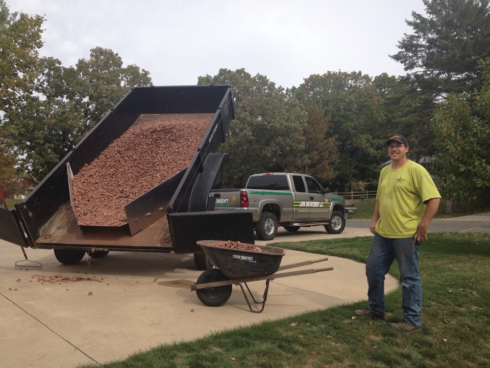

I made this one to dump into my trailer. Easy on easy off - held on by the tailgate chains.
gg

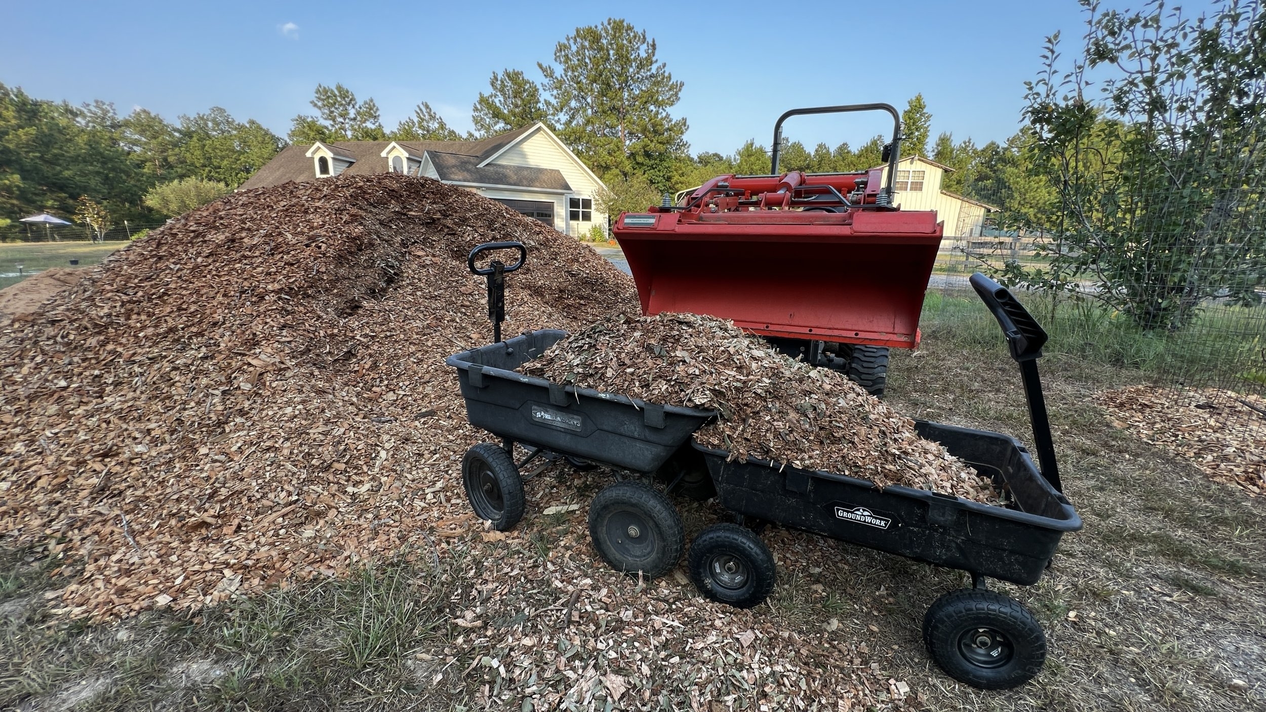

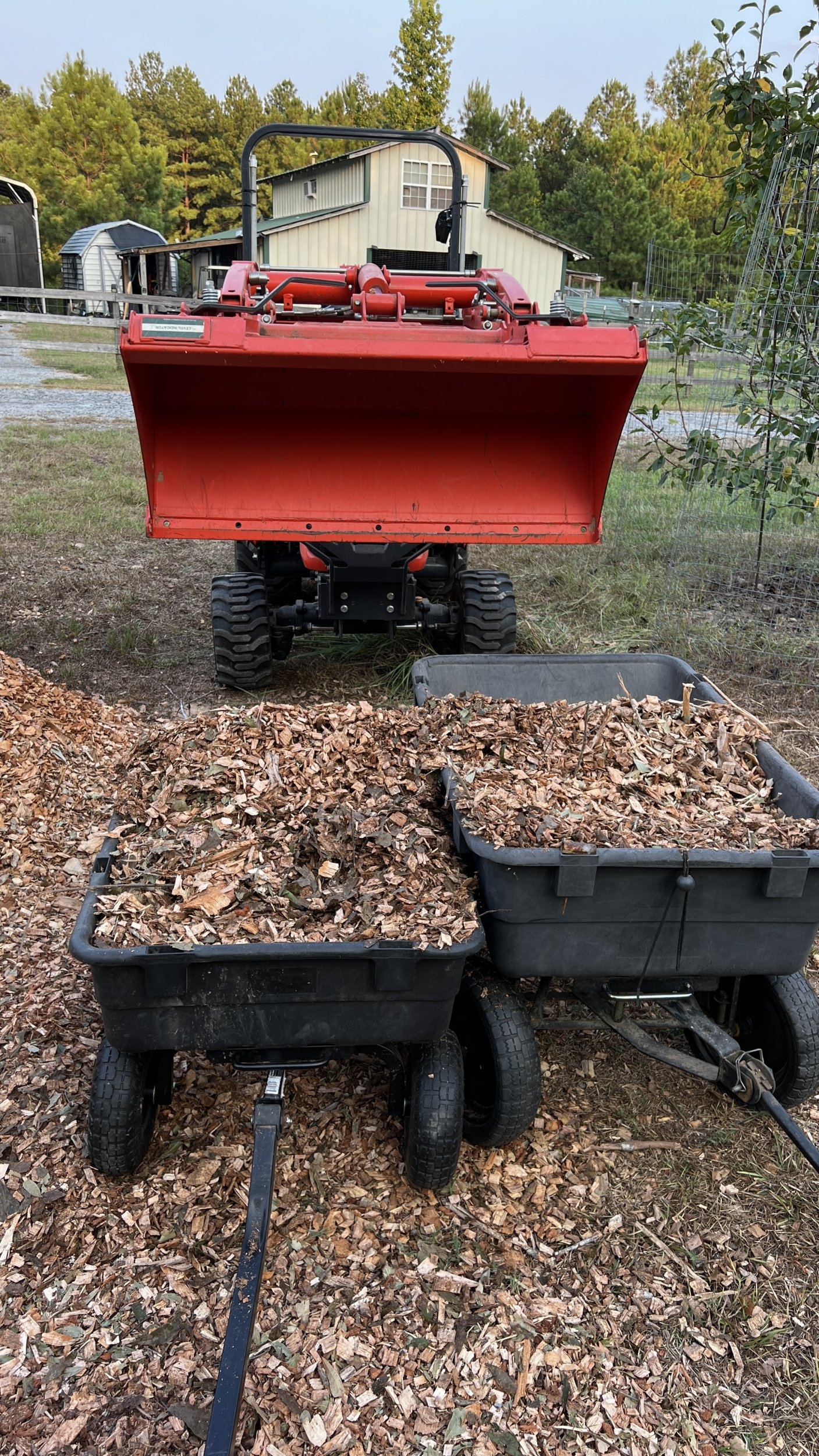

/ Loader to cart helper?
3) Have you thought of simply having a narrow cart sized bucket made just for this job?
Thanks for the replies all!! Good brainstorming.
Redman135 spawned the idea to park two gorilla carts next to each other, which worked pretty well. Still experimenting with end to end vs side by side.
