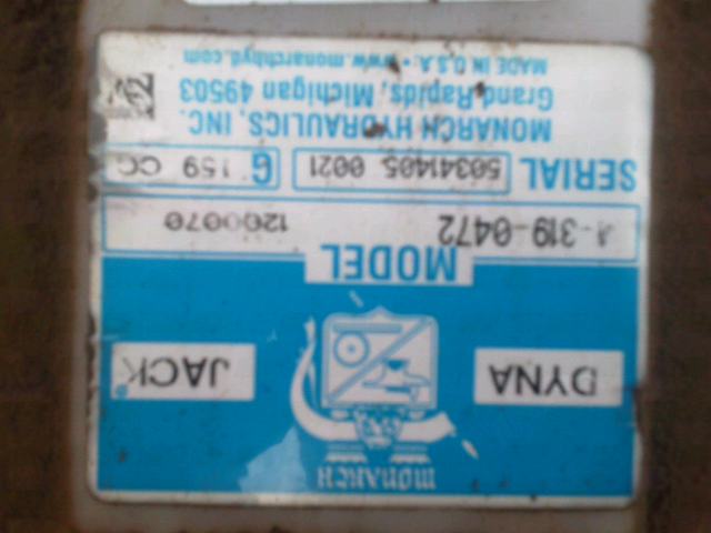

Monarch is owned by another outfit now but someone there is checking for me.
   / Dump bed hydraulics #42

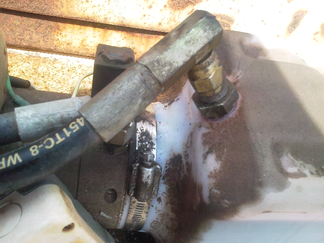

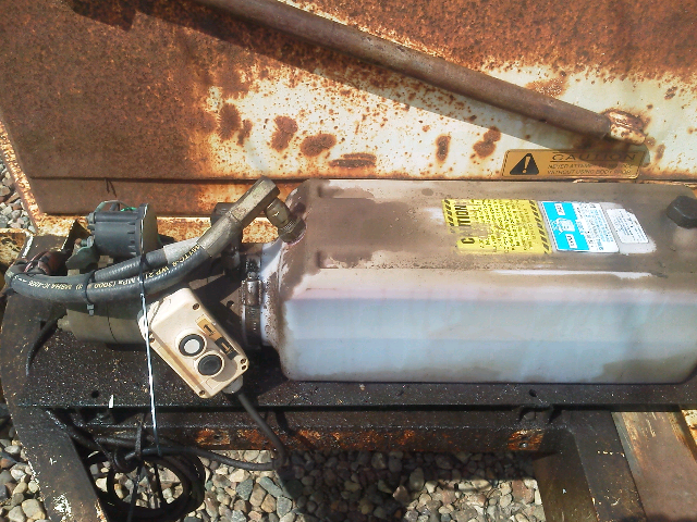

Monarch is now Dynamic Jack, this is a 1 year old pump, that is on a twin ram dump trailer. The return dumps into a hole,they made in the reservoir, it leaked,because there was a cover installed on top, with no clearance. It cracked the reservoir. I will try to locate a replacement, this should work for your trailer. Here is the model number.
Dave
   / Dump bed hydraulics #43
I think the axle notch is still a weak link and just buy a separate tank or make one

Old used freon or propane tanks are good for hydraulic tanks.
Be careful with the residue and make sure they are vented.
