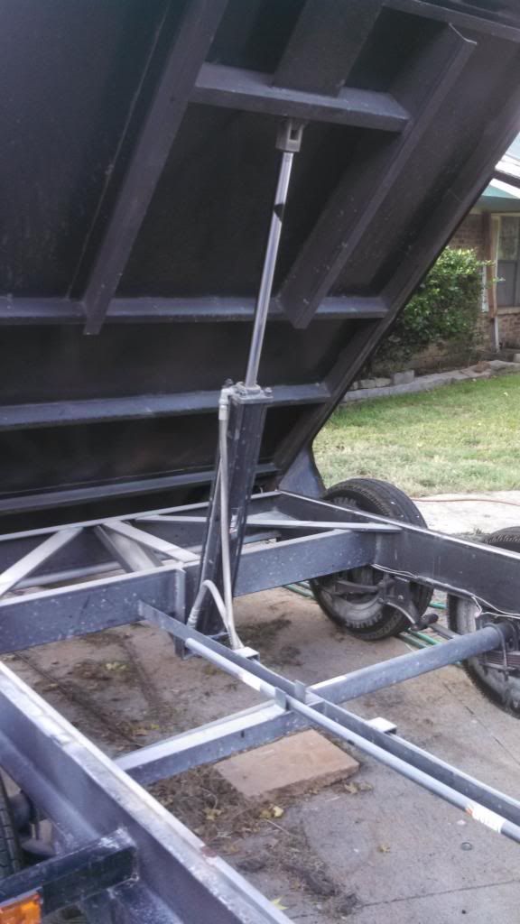

/ Dump bed hydraulics #11
486227_192519687551804_1373086013_n.jpg This is what i did for baby dump trailer, 3.5 bore X 24 stroke, same size s my load trail 5 X 10 dump trailer. Cost of brand new cylindre 340$ + 20$ for 2 brackets and pins.

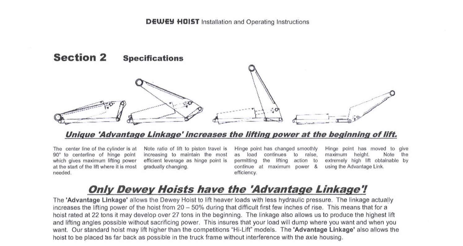

/ Dump bed hydraulics #19
The first pic you post has the cyl mounts in the wrong direction. Lots of range of motion of the bed with a short cyl but dump force will be really low, especially to start the dump. The most force from the cyl is applied when it is working at 90 deg to the bed. Without being able to measure and do calculations, I'd guess it never gets past 20 deg or so at full dump and probably only starts at 5 deg. The green farm trailer in your later post is the same idea but with the cyl mounted in the right direction. Base of the cyl away from the hinge with the top closer to it.
The grey scissor lift in the second pic seems backwards to all the ones I see but perhaps they are reversible?
I agree with LD1, if everything is done proper either single or double ram can work well. And either can fail just as easily. I recently saw a local landscaper destroy his telescopic ram trailer when one of the hinge pins fell out at full dump. Ram, ram mounts and other hinge are all toast.
