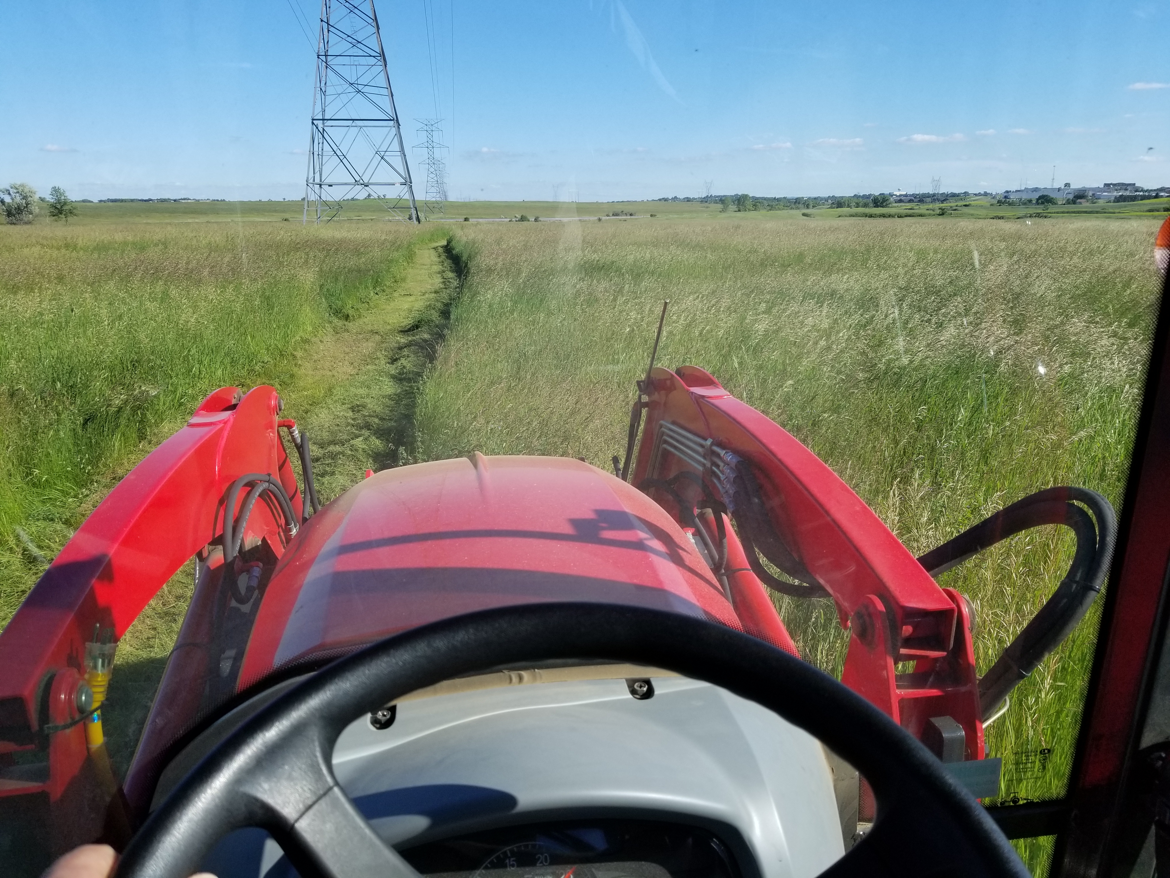

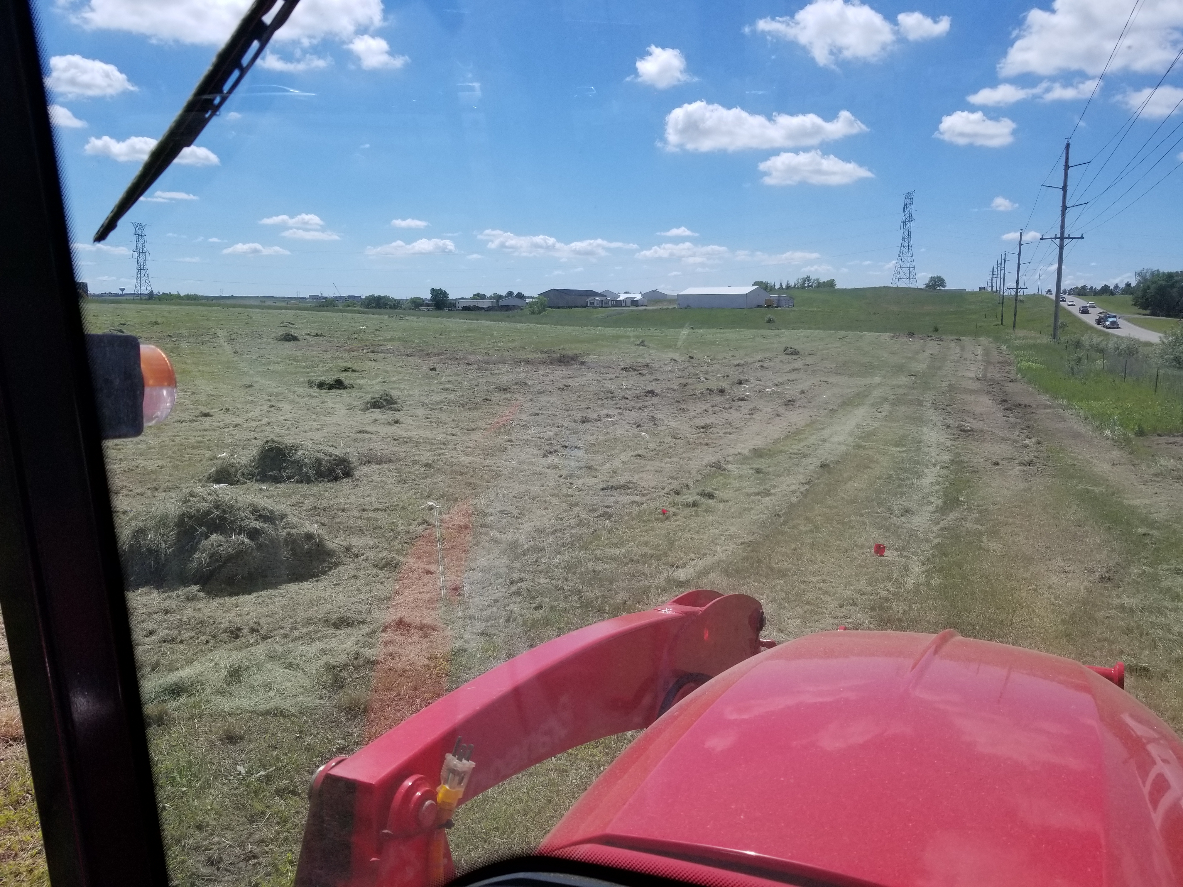

My HST is 3 range. I'm almost always in M range. I load and unload it off my trailer in L range, but that's usually the only time I'm in L at all. I very seldom road my tractor anywhere due to how far away my mowing jobs are from me. I trailer it to my jobs. I mow small, up to large jobs, occasionally really large jobs. Unless it's very steep, I'm mowing in M range. Sometimes if it's very steep I have to shift to L range, and engage both the diff lock and the front diff.
I've mowed some large fields, and some long utility right of ways. The comments about HST's "getting hot" on large jobs is just pure nonsense. Only time my tractor gets hot is if chaff starts blocking air flow through the coolers and radiator. And the A/C starts getting warm and the engine temp gauge starts climbing LONG before there's any issues with the HST getting "hot". You would have the exact same issue with blocked radiators and coolers in a gear tractor. So in either case, you're going to have to stop and blow the chaff out. Sometimes I have to stop several times a day and blow the radiator and coolers free. Also, run good fluids. I'm using synthetics for engine oil, hydro and diff gears.
Here's a good sized field cut in summer (stretches quite a ways off to left and behind me):
Here's a utility right of way that I cut. Went on for miles, and I'm just getting started in this pic (first pass completed and heading back, I think I'm at the midpoint here, iirc). Grass is hood high or better through most of this:
